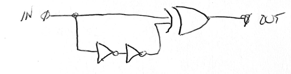

This'll work too. You'll get a pulse for each edge. You can adjust the length of the pulse by adjusting the number of inverters. With fast enough gates you can get a pulse width below 1 ns.

AND gate and inverting delay line (N>4 inverters for CD4000 or 74LS) to get narrow high going output pulse on each rising edge input
OR gate and inverting delay line to get narrow low going output pulse on each falling edge input
However you will maximize economy (achieving lowest chip count) if you apply deMorgan's Laws, and avoid pure-AND and/or pure-OR gates.
