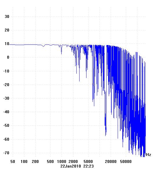

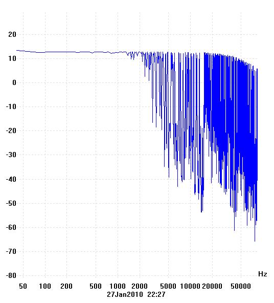

I built an amp with 6AS7 in the output. It has about 240volts as b+ and I use two bottles of 6AS7 and parallel one section of each bottle, so it's a PSE ditty. (I can squeeze more from a single section than if I use both sections in one bottle. Besides, the triode on pin 1-2-3 is never the same as the triode on pin 4-5-6, but it's easy enuff to match two triodes from seperate bottles).
I had all the components in my shack except for the proper O.T. I built the thing and since I had some Edcor 5k:16ohm O.T. laying around I used those while waiting for the OneElectrons to arrive.
The amp is pretty nice sounding, but I only get about 6Wrms out of it. These tubes really need a custom O.T. if max power is the goal, since 1600ohms is just too high for them.
I use a single 6922 as voltage gain tube, and the response is flat from about 10Hz to about 50kHz, with the One Eløectron O.T. That's without any global feedback, so I am pretty impressed.
I had the amp up for about two weeks before the One Electrons arrived, and must say I really didn't hear a lot of difference. Measurements show the One Electrons to be a lot better though.
As you can see the measurements show there is room for improvement, but they really do sound VERY good, and I intend to keep them as is. I'm building a PP 6AS7 amp and that will work on the boomers, while this SE amp will handle the tweeter.
The amp does have a little 100Hz hum, not enough that it bothers me, but it is not dead silent. Running these low impedance tubes in SE kinda makes it hard to get them 100% silent. (I'm actually planning a regulated supply for them, if I get the time. When driving the tweeters this will not be heard.

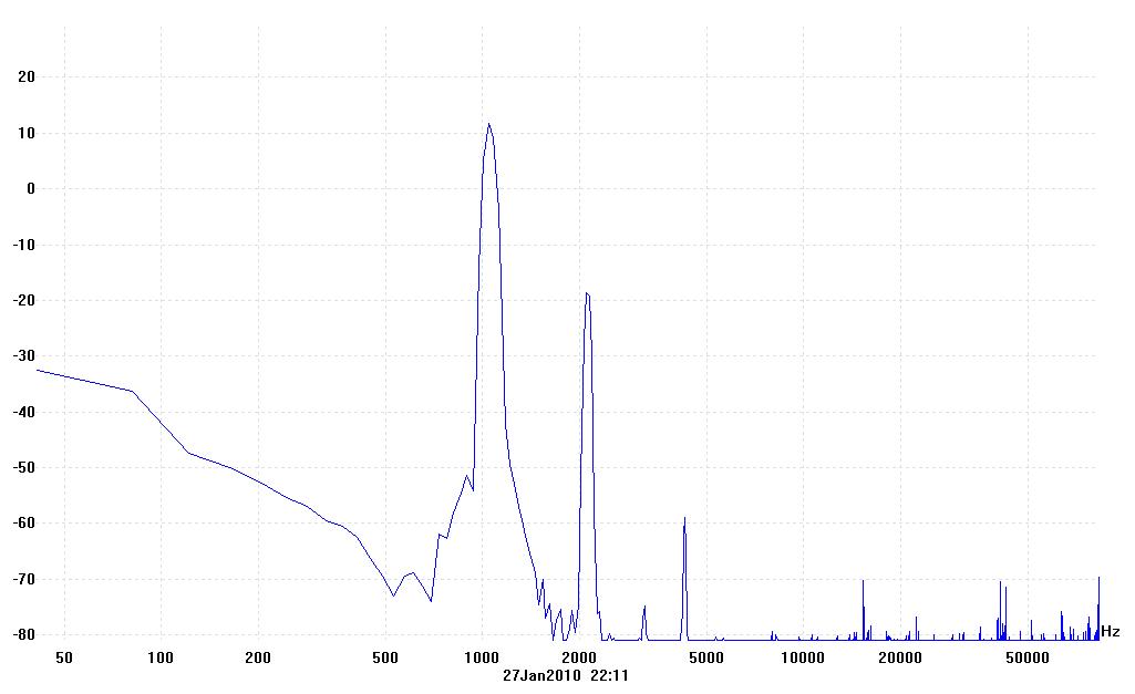

I've done some tests for fun, with tubes amps that have up to 10% 2nd orders distortion, and nobody has heard anything 'wrong' at all.

Obviously the impedance was more 'off' with the Edcors, but I don't think that's the reason for the differences. (High impedance loads should actually give less dist.).

The Edcors didn't go quite as deep, maybe to 15Hz, and they also had some ringing up high, but the amp sounded good with them. Obviously my amp design is so awesome thet even a crappy O.T. can't stop it🙂
Here are the respons plots:

The higher odd harmonics with the Edcors is something to think about. Sure these little ones have smaller cores and it's perhaps b/c of too high standing currents.
