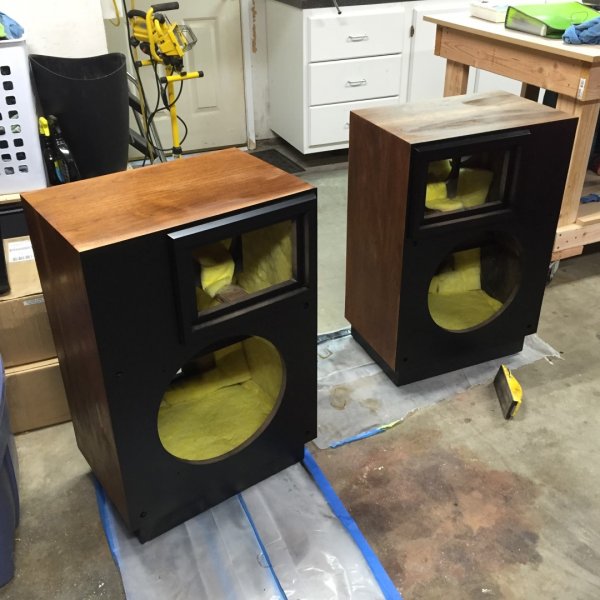

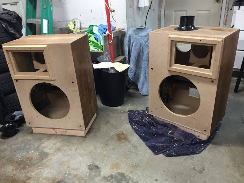

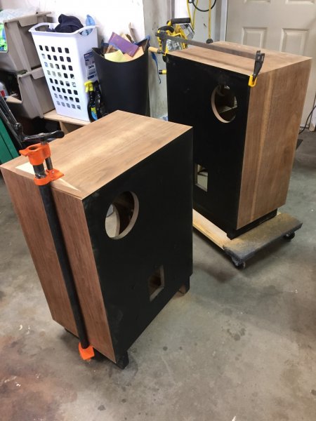

This ( JBL L45 Flare ewaves ) shows my favourite 15" eWave effort.
I like the look of the slightly offset horn ( as well as the effort to close the gap between the drivers two acoustic centers ).
You'll want to make custom network ( of course ) for the components you're using.
