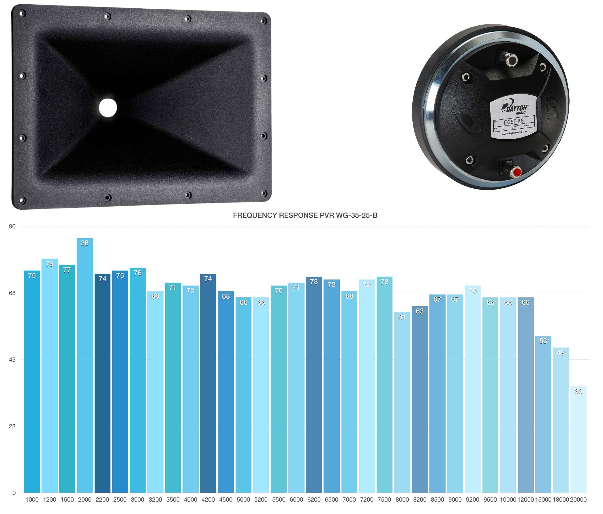

I've been enjoying the $25 Pyle PDS442 on a Selenium waveguide. Good sound for cheap. Haven't heard the Peerless but it looks like a winner.
Not much info on the Pyle PDS442. Here's a measurement in my room using a cheep mic and iPhone. If anyone has experience with the Pyle please chime in.

>>> maybe he'll chime in with some uber-affordable apps. that you can use with an iPhone ( or android ) to help you determine if your woofer has usable 1500hz output.
To create measurements I've cobbled together the following apps.
- Apple Numbers (this creates the chart - FREE)
- SPL Meter (iOS app that measures the SPL - FREE).
- Audio Signal Generator (iOS app - FREE)
I use this $15 mic and plug it into my iPhone.
https://www.amazon.com/Professional...qid=1492810843&sr=8-3&keywords=Mic+for+iphone
I clip the mic to the top of my IKEA chair where I do my critical listening.
The test tones are played from my iPad connected to my amp. I record the SPL in Numbers and and it creates the chart. It's very easy but takes about 10 to 15 minutes each. Once I start doing it I usually swap a couple of horns in and out and make several measurements.
If you just want to see if your woofer has output to 1500Hz (or whatever) just download Audio Signal Generator (or a similar app) to your phone, connect to your amp and see if you can hear the tones when you play them. I don't seem to have much hearing above 15kHz and it's strange to see the SPL Meter app jump when the room seems silent.
Personally, I don't think this mic measures bass accurately below 300Hz. No matter how loud the bass is below that frequency it measures about 30db lower than the frequencies above.
Hope this helps someone looking to make measurements on the cheap. Maybe one day I'll buy a better mic.
