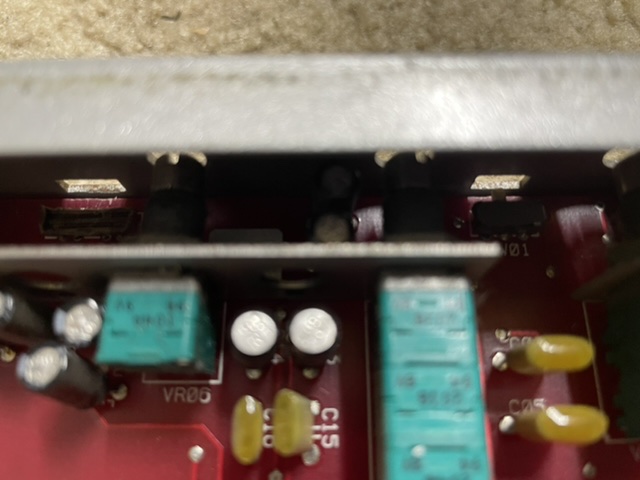

I've got this Eclipse I'm working on, which is using 2sk3057 with 100ohm gates in the PS. I need to replace all 12x as 2 of them shorted. I was thinking of replacing these with IRFZ48 so that I do not need to order new SMD gate resistors (Which would be needed for IRF3205). Any suggestions on how to mount these to the sync with insulators? I was thinking of using some C channel stock, drill and tap new screw taps. i think it will work?
Second and really a show stopper, is there are 3 little 90degree switches on the front of the amp. One is totally missing, second one is missing the internal slide, and 3rd one is stuck in position.
Picture coming.
Switches
I guess IRFZ44 would be a better option? I'll use the 7721-7PPSG with backing insulators. Easier than C-Channel clamps.
2sk3057 are rated for 45A continuous
IRFZ44 are rated for 49A continuous
What do you think about those switches? If I cant replace them then this amp won't be getting repaired. They're so tiny I want to call them dip switches.
