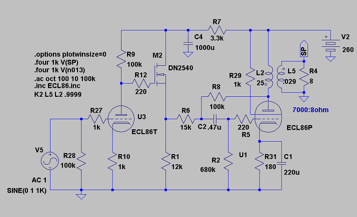

ECL86/PCL86 Schematic
This one will give you in the ballpark of 3W at 1% THD with low Zout.

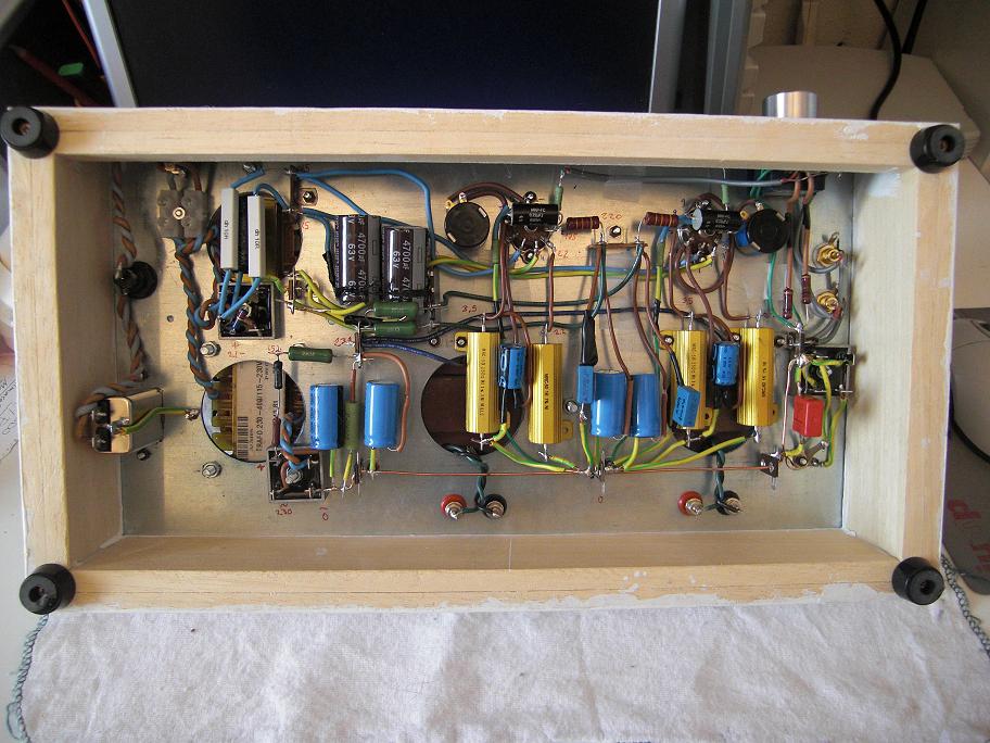

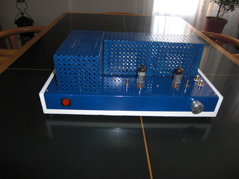

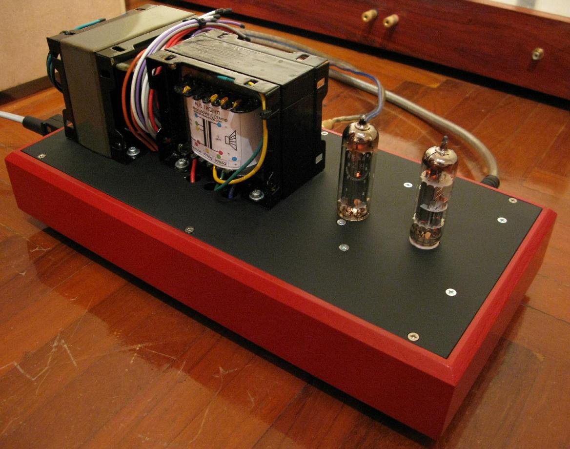

Hi, I am new to this forum.
I also builded a E / PCL 86 SE Mono Block with EZ 81 rectifier.
This was for our THAI DIY Low Cost Project.
The price of the material should not exceed 10.000.- Thai Baht, around 200.- Euros.
The funny thing is, that the sound quality is very good.
A friend of mine has made me very good OPT for the E / PCL 86.
They are a little big but they deliver a nice bass.
It makes fun to listen to this Amps.

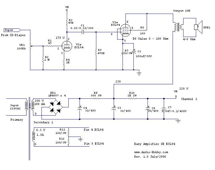

Hi TubeKing,
F.e, this one by Bill Douroukis: amp, B+ supply, heater supply.
If too complicated, you can start to simplify the B+ supply.
Regards, Tom Schlangen

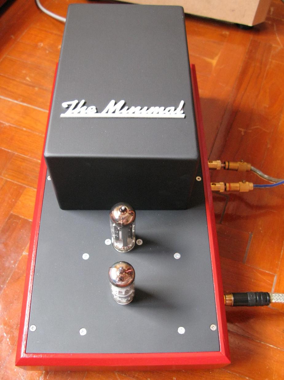

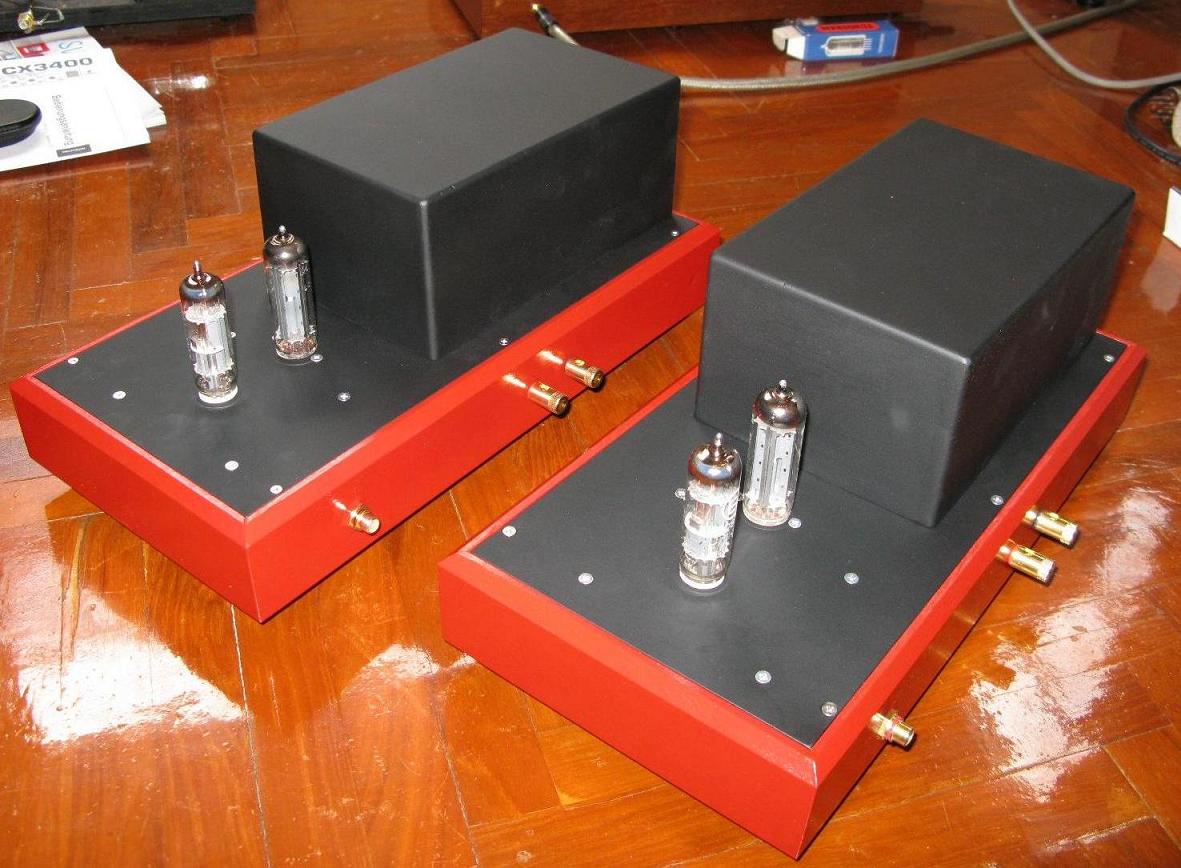

Schematics of The Minimal
Here is my schematics of my P / ECL 86.
It is a very easy circuit, but the sound is very good.
You need a good 5,1 K OPT.
I use EZ 81 for power supply.
HT is 250 Volt.
Bill Douroukis SE amp
You cannot go past the constant current source when it comes to running small signal tubes in utmost optimal conditions.
The constant current source reflects an infinite impedance (10's of megohms) load to the triode which dramatically improves distortion and the gain stage is optimal(mu = voltage gain). Also the triode is fixed with no fluctuation of power supply, hence any hum or noise is eliminated from signal path.
I have always used these constant current sources in conjunction with regulated power supplies and I do not use chokes in my supply at all (very heavy and large) with NO hum or noise induced.
Regards
Billy Douroukis..
