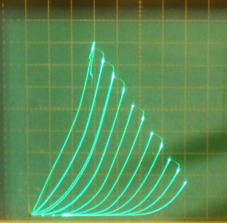

Here are some curves and test circuit links:
http://www.diyaudio.com/forums/tubes-valves/271134-schade-cfb-exactly-equivalent-10.html#post4279487
http://www.diyaudio.com/forums/tubes-valves/271134-schade-cfb-exactly-equivalent-11.html#post4279626
b) 21HB5A in Mu scaled g2/g1 drive with g1 Schading
c) 21HB5A in g1 Schaded mode
d) 21HB5A in g2 drive only
a) test circuit

I have several more dual drive circuits working, and some will be posted when I get a chance to catch up on everything since moving twice in the past 18 months. Most of my experiments have been based on sweep tubes, but I have had success with the usual audio tubes like the 6L6GC.
You could of course replace the mu-ratio tube divider with resistive divider to set other ratio, AC coupled to G2.
I didn't AC couple, but I am using fixed bias, so I have a negative supply. G1 is tied to a resistive divider from G2 and the negative voltage supply is chosen to get the bias close the the desired value. I find that most tubes work best in the range of about 5 to 1 screen to control grid voltage.
Advantages, less drive voltage required than pure screen drive, less likely hood of blowing the screen grid due to lower peak drive voltage.
Disadvantage, higher output impedance than pure G1 drive. Some feedback will be needed somewhere.

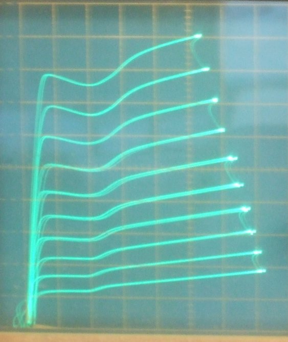

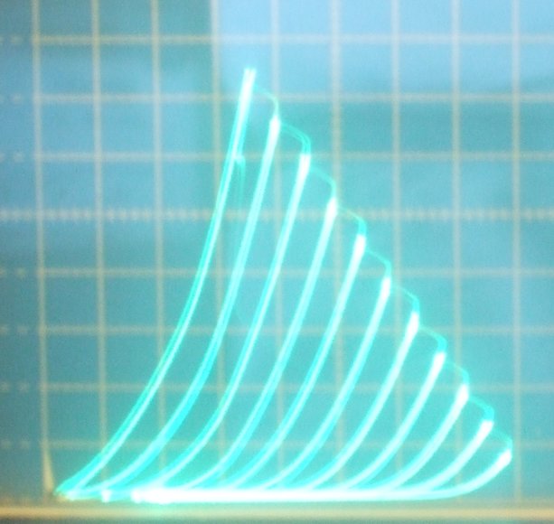

Here are some assorted curve sets for the 21HB5A.
a) negative g1 drive only
b) g2 drive + 124V with g1 at -22V
c) g2 drive + 62V with g1 at -11V
d) positive g2 drive only
As you can see, negative g1 gives plate curve kinks. So 0V on g1 would be preferred for g2 drive alone.
For scaled g2 and g1 drive, the kinks will disappear as the plate current increases (g1 increasing toward 0), so negative g1 bias would be OK.
Scaled g2 and g1 drive also works fine, with no discontinuities that I can see, with both g2 and g1 going positive. This would require the least positive excursion of g2, so would be the safest for the tube. The g1 driver does then need to handle some small current, like the g2 driver always does.

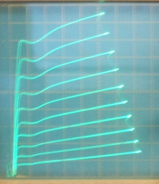

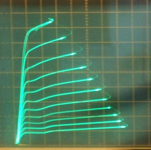

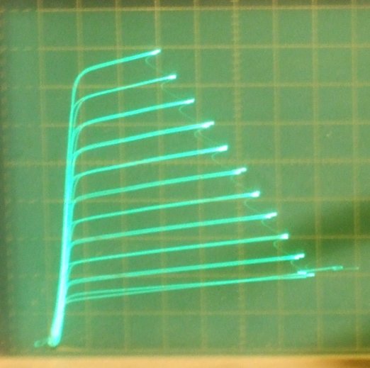

50V/div Horiz. 20mA/div. Vert. 21HB5A
d) positive g2 drive only (g1 at 0V) (50 mA/div Horiz.)
I have now noticed some issues with using positive g1 along with positive g2.
Pos. g1 will start to draw noticeable grid current if g2 is not sufficiently higher, and puts a slanted flat into the plate curve then (at low plate V's). This probably is still not be an issue with scaled g2 and g1 as long as g2 is scaled well above g1.
The other effect I am seeing is positive g1 causes the diode curve (left side of plate curve knees) to increase (shift right, in plate voltage) some. +10V on g1 (for the 21HB5A) can make the higher current plate knees increase by +25V. This is NOT GOOD for efficiency. For a Mu 4.8 scaled tube (ie, 21HB5A), this could reach +20V on g1 and +50V delta on the plate curves.

minor correction to above pics:
plots a) and d) are at 50 mA/div VERT. (were some older pics on hand)
plots b) and c) were at 20 mA/div VERT. (can tell by the different slope on right side for limiting)
I have also noticed that positive g1 not only makes the diode line shift right (to higher plate V), but it also makes the g2 currents increase quite noticeably. I think what happens here is that + g1 focuses cathode current ONTO g2 (while normally NEG. g1 SHIELDS g2 from cathode current). This is NOT good!!
So I would say the optimum setup for Mu scaled g2 g1 drives would bias g1 at half the usual neg. bias (compared to g1 drive only). Then the scaled g2 g1 drives would bring g1 up to 0V and g2 up to +Vg2max (approx. Mu times g1 Vbias) for maximum + signal. (Each grid providing equal effective current output drive with the Mu scaled drives.) Drive(s) could still exceed that on signal overdrive, but efficiency would start to decrease some beyond there. The kinks in the plate curves will be full size near zero plate current (g1 at -Vbias), but shrink to nothing at max current (g1 at 0 V). So the load line is never bothered by them. At least overdrive will only be pushing Vg2 up further at half the rate (in g2 g1 scaled mode) of a pure g2 drive setup.
Schade feedback shouldn't really effect the DC setup points (for AC coupled Fdbk anyway). But it will effect the R (or tube) dividers to get the proper g2 g1 drive scaling. Schade to g1 will be Mu times more effective than to g2 for the same feedback, as far as reducing output Z and distortion. But for two similarly (Mu) scaled Schade feedbacks, they should both contribute the same I think.
