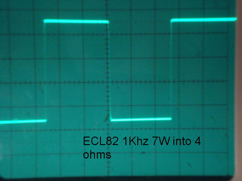

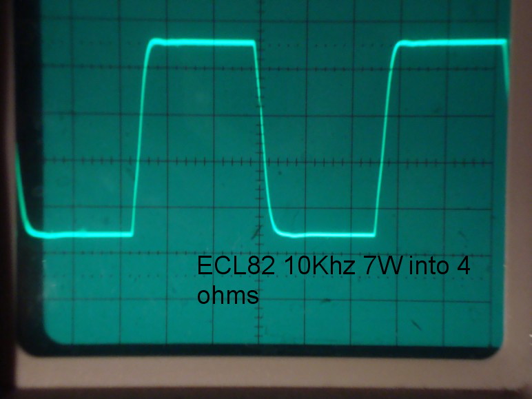

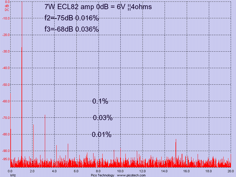

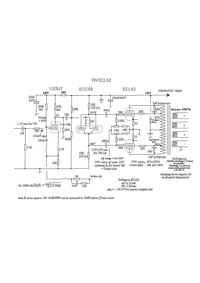

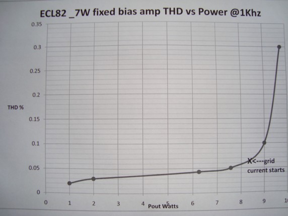

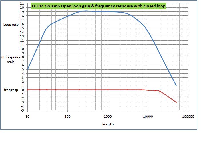

Nice simply start with ECL82.. I wasn't disappointed....and was suprised how loud this amp sounded..I also did the Mullard variant and found the thd & s/n ratios too high, especially when the output was via a Lpad ideal for headphones etc. So out of the junk box I came up with a fixed bias variant which offered a nice o/p for easy listening HiFi and a practice guitar amp.
The quality is astounding, mainly due to a good o/p transformer the Sowter UO67.
I found the ECL82 triode sections disappointing to use......hard to linearise and optimise for lowest thd considering this tube was really designated in cheap B/W TV sound stages. So the triode sections in this amp is redundant and since I have alot of 12GN7's, I used this instead but others would equally work. The ECC88 both sections in parallel configurated as concertina provide the easy low Z drive levels.
O/p stage quiescent each tube 31mA for lowest thd. Take note o/p stage UL snubbers.
