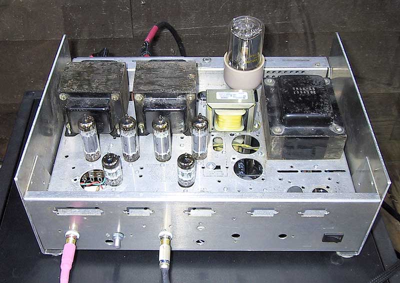

hi, i'm just out of noob school and have a problem with an old heathkit s99 amp. I accidently cut off air vents to the amp one evening and started to inhale a strange smell. Being slow off the mark, the amp died. There is plenty of wax drippings on the chassis now under the mains transformer that was not there previously. I have measured the voltage straight out of the transformer before the gz34 and there is no voltage. I didn't think transformers died this way? Now i'm thinking to replace the transformer and assume the output voltage is not that important as long as it is close? And i have no idea of the current demands (mA).?

The schematic you posted shows a power transformer with a 440VCT high voltage secondary. Full wave rectified through the GZ34 you might get 285VDC or so. It was rather nice of them to include a GZ34 in the design - lesser amps might have tried to get away with an EZ81 or something.
Each pair of ECL82 power tubes should probably be drawing somewhere around 70mA. You'll need a little extra for whatever driver tubes you've got in the front end, including the triode section of each ECL82. The EF86 will take ~6mA. The the ECF80 could take as much as 28mA, but I can't imagine it would be running that hard given its position in the circuit. If you can find a PT rated for ~200mA, I'd expect it would be more than adequate.
You'll need 2A at 5.0 volts to power the heater in the GZ34. You'll also need a 6.3V winding on the PT. Again, if you stay with the tubes shown in the schematic you would need at least 4.5 amps (ECL82 needs 0.78A, EF86 needs 0.2A, ECF80 needs 0.45A).

The fact you didn't mention the condition of anode ww series resistors of the rectifier, leads me to believe the problem could be a short in the heater winding. What do they look like ?

I'll the check the series resistors to the rectifier anodes tonight, I've had the voltmeter on the output of the transformer before the rectifier and i get nothing. would a heater short cause this? there is also the physical observation of a lot of wax leakage that leads me to believe the transformer needs replacing. I've heard of sowter before but was hoping to find a cheap old transformer on ebay that would be close enough in specs to replace. Would love to pick your brains on a possible rebuild/ upgrade of the present circuit.... possibly losing the preamp section?

thanks bill, i now have a correct cicuit diagram! Such a shame about the PT, my s99 is far cleaner than the one on the UK vintage repair site. So i need a transformer, a 540V CT. Still unsure about the preamp section of this amp, i built a 12b4 pre with help, as my knowledge is still small, but i was always led to believe that these old preamps were not up to much.

A 540v ct is the way to go if you want to keep it original.
Once you have this amp up and running it'll be easier to mod.
Or not. Rather than pin your hopes on exactly the right PTX coming along here's three suggestions:
1 - get a quote on having your old PTX rewound to original spec. It won't be cheaper, but it will be new and you will know what you have
2 - think about going SS for your rectification and look for a PTX that doesn't need a 5v winding, and doesn't need to be CT. Certainly widens the gene pool.
3 - consider using SEPARATE PTXs - one for B+, another for heaters. Again, widens the pool of candidates.
Whatever you do, if you intend to keep this unit, go bigger rather than on spec or under spec. If the expected load is 200ma, go 250ma for your PTX. Less chance of it dropping wax again....
