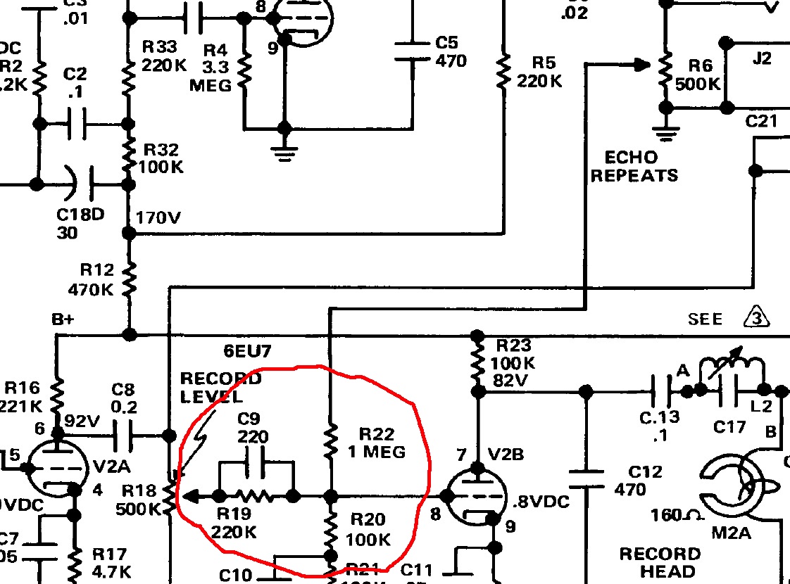

Hi Folks,
Wondering if you have any insights on my Echoplex problem. This is an early-version EP-2, no Sound-On-Sound. The issue is that it won't go into regeneration. The "Echo Repeat" circuit feeding V2B looks admirably simple, and I doubt the issue is a bad 1 Meg resistor Any other places you'd check?
Or R6?
Seems easy enough to tack a 470k from top of pot to V2B grid. If that causes mega-regen then the culprits are obvious and can just all be replaced.
Or R6?
Thanks, I was going to follow that line of inquiry myself! Just wondered if there were something less obvious I was missing (I'm sure there is!).
