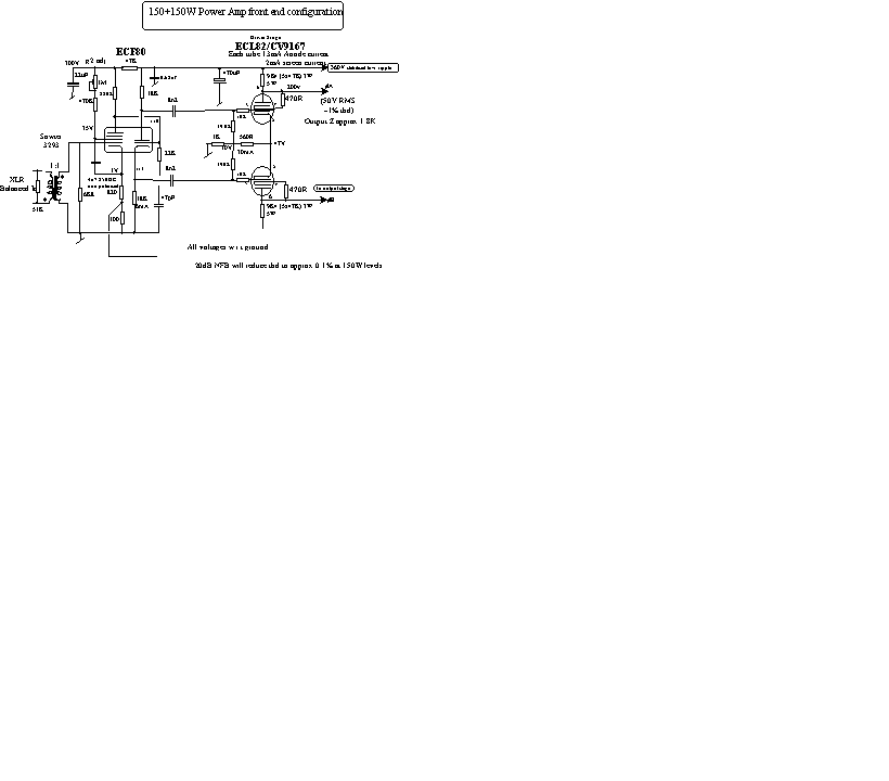

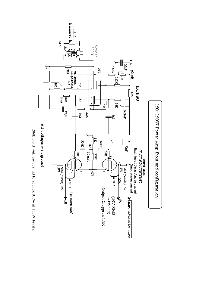

The 7199 is fast becoming a collectors item and for a few bucks the ECF80 can do a better job. I find the pentode gain sim but the tube likes a touch more current. I’ve enclosed a diag of the front end of my 150W amp which uses it. The pentode g2 is the single setup problem area and despite other configurations, the orig with discrete resistors performed the best.
Swapping the 7199 for ECF80 plus some surgury gives virtually identical stage performance, pentode 43dB and slight drop in cathode resistor value. The rest is standard amplifier building. An ECL82 pentode configured as triode self balancing voltage follower with feedback Doing the math; assume front end stage gain of 40dB the ECL82 stage gain of about 16dB. For input of 70mV will give 50V+50VRMS driving p-p parallel o/p stage at 530V will give around 140W+. Going for higher driver gain isn’t desirable with this type of circuit if one wants to keep the noise floor at –75dB down with 20dB NFB...(Vin then becomes 0.7V) Going for a 12BY7 (a brilliant tube) would only enhance the 1st stage pentode noise (10dB worse) and require even more NFB to counteract. The values shown for 1st stage snubber and interstage cap value of 8n2 are for good output transformer quality... NFB has to be increased to 36dB before hints of LF instability. This drastic increase is a good test of any tube amp.
SOme have queried the use of an ECL82 as a driver. True, this tube in triode config has rather bad curves...( I get far less thd from these than from a 6SN7 in sim circuit) and as I have several ECL82 ..I’m using ‚em. I’ve also used the med high mu triode section as a see-saw phasesplitter.....but the performance was disappointing as the two halves due to layout are some distance apart, which ruins the HF into high thd. By all merit the split load phase-splitter in one tube offers about the best for what one gets for the price.
On audio listening the split-load HF performance with the balanced voltage driver offers about the best hi-fi performance vs. simplicity and cost. Comparing this with another amp that uses the see-saw phase-splitter, the top end notes sounded quite „raspy“ especially cymbals coming through as a tizzle this due to the thd from the HF misbalance which it creates.

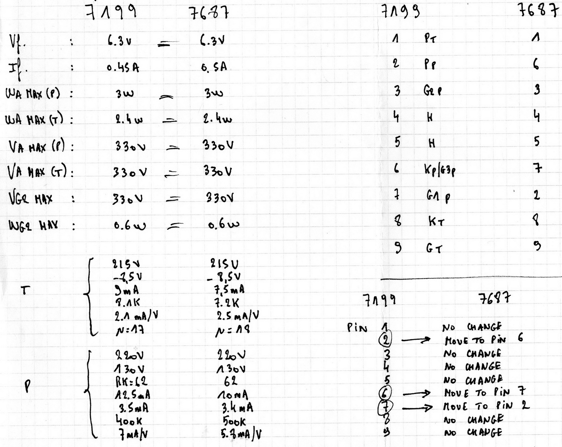

The best substitute I know for the 7199 is Sylvania's 7687 . It's a more stable and consistent tube, has lower noise than the venerable 7199 and sounds much better too. A real upgrade in most circuits using the 7199. Unfortunately for some obscure reasons Sylvania decided to use a different pinout for their 7687 , a wrong choice who condemned this tube to oblivion... and RCA won the game with their (inferior) 7199.
Quite strangely, I've never seen a commercial Hi-Fi product using the 7687. The positive side-effect is that this tube is still available and cheap. Just remember it is NOT pin to pin compatible with the 7199 and some socket rewiring will be needed. The pentode section screen voltage may need fine adjustment for best operation, mainly in direct coupled circuits. Really worth a try.
