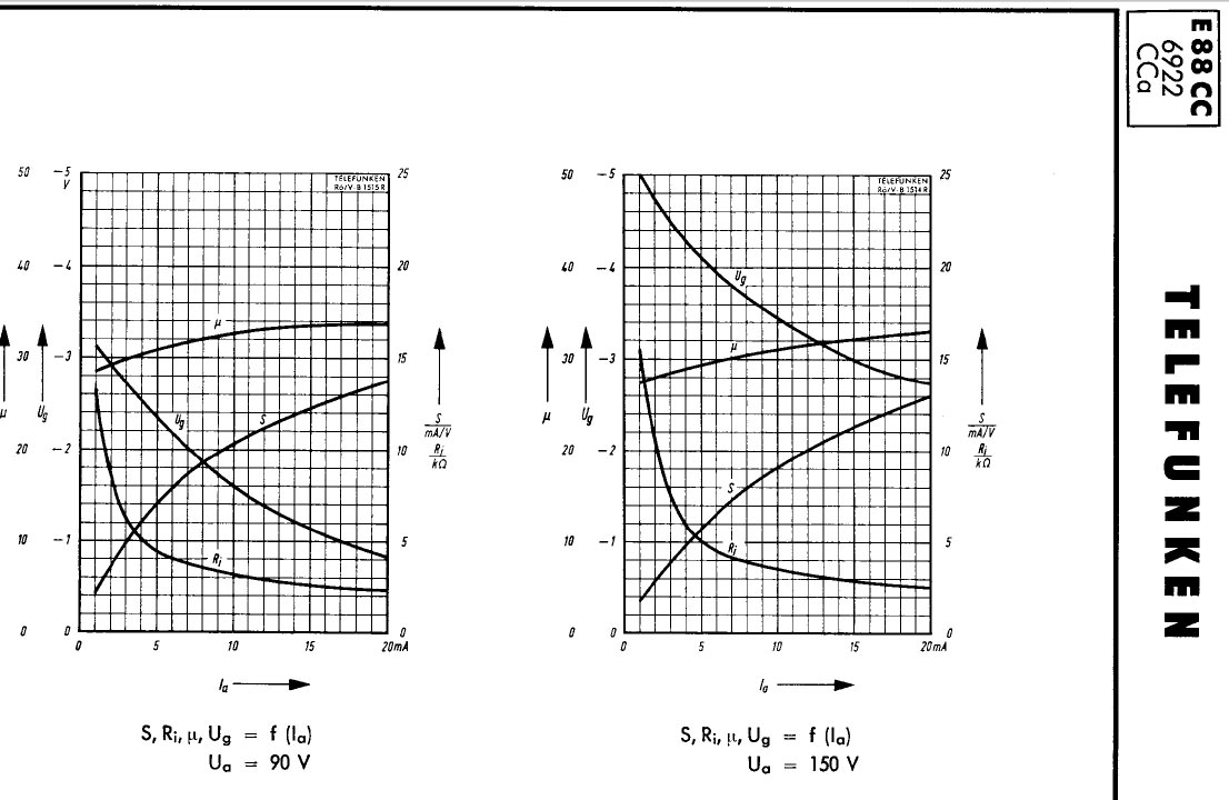

What about the more than 2X difference in μ? A triode's amplification factor is directly related to its geometry.

But mu and Gm change with voltage and current - they are nowhere near constant, dropping with lower plate current. The 2x difference seems about right...
Take a look at the graphs of the 6BQ7 (somewhat similar tube, I don't see a similar graph for the ECC88) here:
http://www.mif.pg.gda.pl/homepages/frank/sheets/135/6/6FQ7.pdf
See how mu drops off with current?

Mu looks pretty flat there...

I've always assumed that the basic geometries between the ECC88/6DJ8 and the ECC86/6GM8 were quite similar, but that the grid pitch and hence transconductance were quite different.
The mu's of both types are relatively constant over a wide range of currents as can be seen from the curves, but the mu of the ECC86 is about half that of an ECC88.
