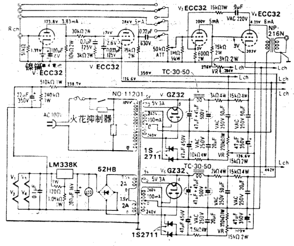

BTW, IIRC the ECC32 is kind of a IDH 26..........
From my collection, don't know where I got it from:
Cheers, 😉
