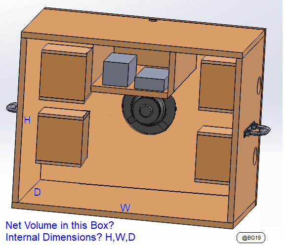

Solidworks screen shot of inside the enclosure:

Ok, would a TL like this be ok?
I do also have some dampening material (wool)
Or maybe something like this?
Could you quickly draw where the best placement for the dampening wool is?
And how would I calculate the tuning frequncy out of this?
Btw, I don't want to make it too complex because I don't want the box bigger than it actually is.

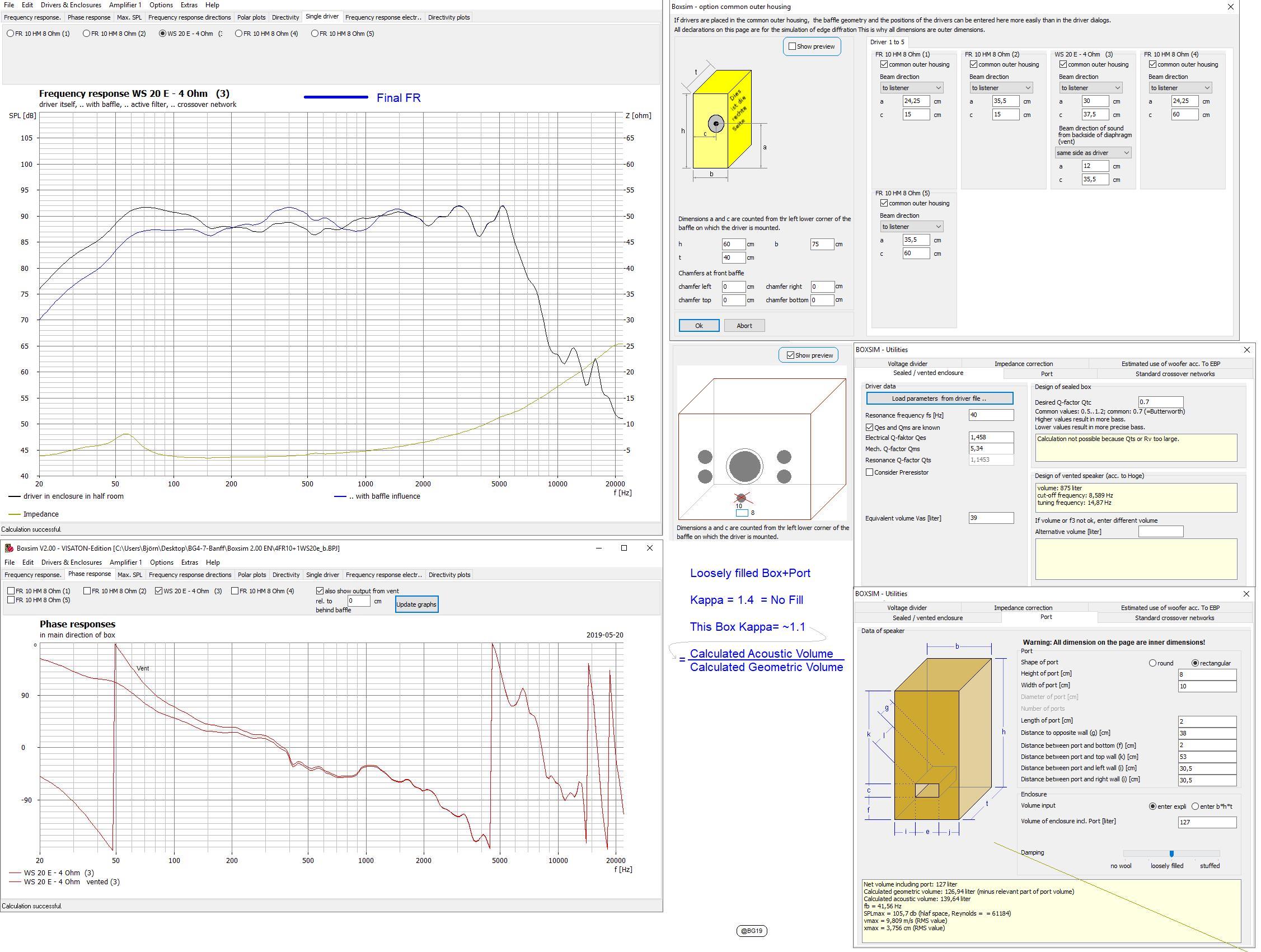

Right, so this is the graph based on the calculation of the whole bottom area being a vent.

Speaker Design is Engineering, You are very inconclusive when it comes to be specific of what the constraints(dimensional) are for the Freestyle Box suggestion. Wishful thinking and severe physical restrictions for the non suitable Driver(WS-20E) will never result in a good FR extension for the 4 smaller FR-10- HM that should use a vertical C-C distance that is shorter than Lambda/4 at an eventual chosen XO frequency in order to defeat unwanted FR response degeneration interference at the Listening Area.
By the way: Boxsim is OK but restricted for simple Shoe-Box Designs and cannot handle internal Box quarter-wave’s like the Superior Hornresp Program do. If the rear Side of a simple Box is converted into an elaborate Air-way Path's like in a TL: Quarter-waves must be considered and properly handled including the correct use of Wall lining Damping Materials that always is needed.

This is my first build so for the most part I don't really know what I am doing.
So you're suggesting I should remove the inner side walls based on the drawing or not? The 4 smaller FR 10 Hm's are in passive radiator enclosures.
What exactly do you mean by the "non suitable driver"? I've contacted Visaton about the best box for it and they've responed it's best for a vented (bass reflex or TL) enclosure.
Here are the messurements you've listed in the screenshot + additional messurements (blue = dampening material placement):
The volume of the entire box without anything in it is 150liters. With the 4 enclosures for the FR 10 Hms and the enclosure where electronics are, It's slightly above 127(On the pictures it might seem like there is no backside, the backside is also 20mm thick but I hid it making the sketch for the view of the back and forgot to enable it again)

Ok, so you're saying boxsim is accurate for a bass reflex? If I sumulate using a rectangular vent it shows me decent results.
I don't have much experience. But I used it for a couple of BRs and provided fair forecasts.
I think it uses the original formula of Herr Helmholtz, with corrections: it evaluates area and section of the port.

Well, 3+ dB peaking/~80 Hz in a loosely stuffed cab isn't my idea of 'decent' results, but in retrospect I guess it's OK for a shop or outdoor boombox.
FWIW, the only boombox I've built was for my daughter back in '80 that I tuned for ~60-200 Hz of modest peaking bass, a common response for party speakers back then, which is what I get in a ~40 L Hornresp TL sim for this driver, but the [folded] line length is ~167 cm, so assume it won't fit in your single fold rendering.

Hello, could you test how this would perform? (Total lenght of the line is ~ 158cm):
Hello, could you test how this would perform? ...
Don't bother GM with your totally Freestyle attempt as you give no indication of the CSA that should stay within an Aspect Ratio of Max. ~2:1. like Starting with a Minimum Area of 21 x 42= 882 cm^2 and ending at a Terminus Area preferably not less than 80 cm^2. I.e. ~6.325 x 12,65= ~80 cm^2. Due to the very low fs/Qes : Only an offset Driver( so a simple TL is not a good idea ) will maintain a sufficiently high upper frequency needed to be factored in enabling an XO at or above ~200Hz= a prerequisite from the other for interfacing Drivers that cannot be cut-off at a too low frequency.
Have a look at the submitted Boxsim 2.00 Picture where I used a totally stuffed(Using in Hornresp ~a Kilogram Stuffing at Max.) Volume of ~127 L and a Port Volume of 8 x 10 x 2 = 160 cm^3 and rearranging the position cf the FR Drivers a bit to a Minimal Vertical C-C distance.
I will submit the 4FR10+1WS20e_b.BPJ file too but I don't want to discuss my settings further as I’m not interested in Boxsim at all.
