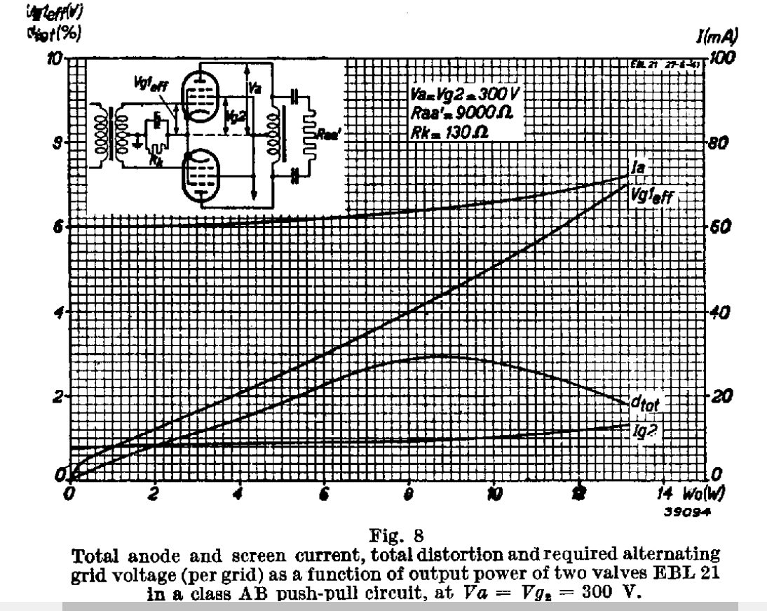

Almost all EL84 schematics can be used. 8k or 10k OPT works fine.
Unfortunately I can't find any OT (eg hammond) with Ra = 9000k.
From the 8K, 10k which one would be most appropriate?
8K works great for me.
Also 6600 is suitable.
You can also play with the impedance, by connecting the speaker to a different output tap, for example:
OT 4.5k primary, secondary 4 and 8 ohm taps, connect an 8 ohm speaker to the 4 ohm output tap:
((sqrt(4500/4))^2)*8 = 9000

That depends on the supply voltage. For 300 V or more, take 10k.
For 250V to 300 V take 8k.

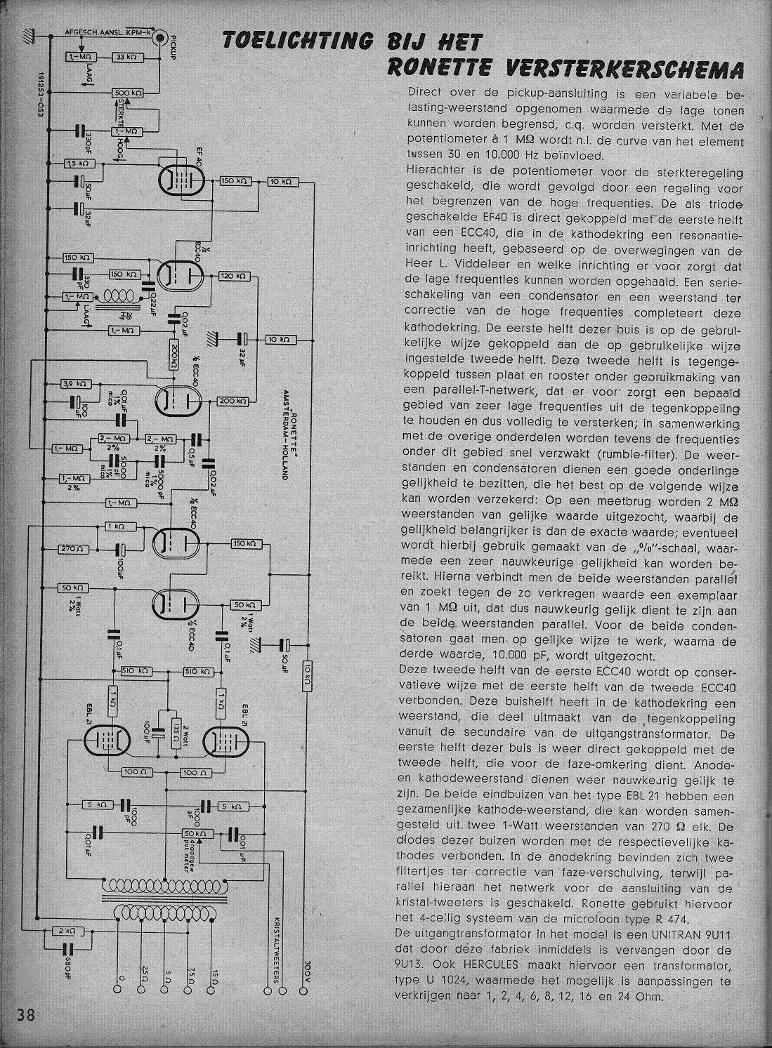

Attached two schematics as published in Dutch electronics magazines from the mid fifties.
The one from 1955, of which you than only use the part with the ECC40 and 2 x EBL21, lacks GNFB.
The one from 1954 does have GNFB but my guess is that if you would only use the ECC40 and 2 x EBL21 than the input sensitivity will be a bit low.
Several radios were made with 2 x EBL21 in push-pull but a substantial part of them used an ECH21 as a combined AF amplifier and phase inverter, which in view of sound quality (distortion) is probably not the best way to go.
But like others already pointed out: You can pretty much use any schematic for a push-pull amplifier with 2 x EL84, but than follow the datasheet for the EBL21 as far as the cathode resistors and the anode to anode load for the EBL21's are concerned.

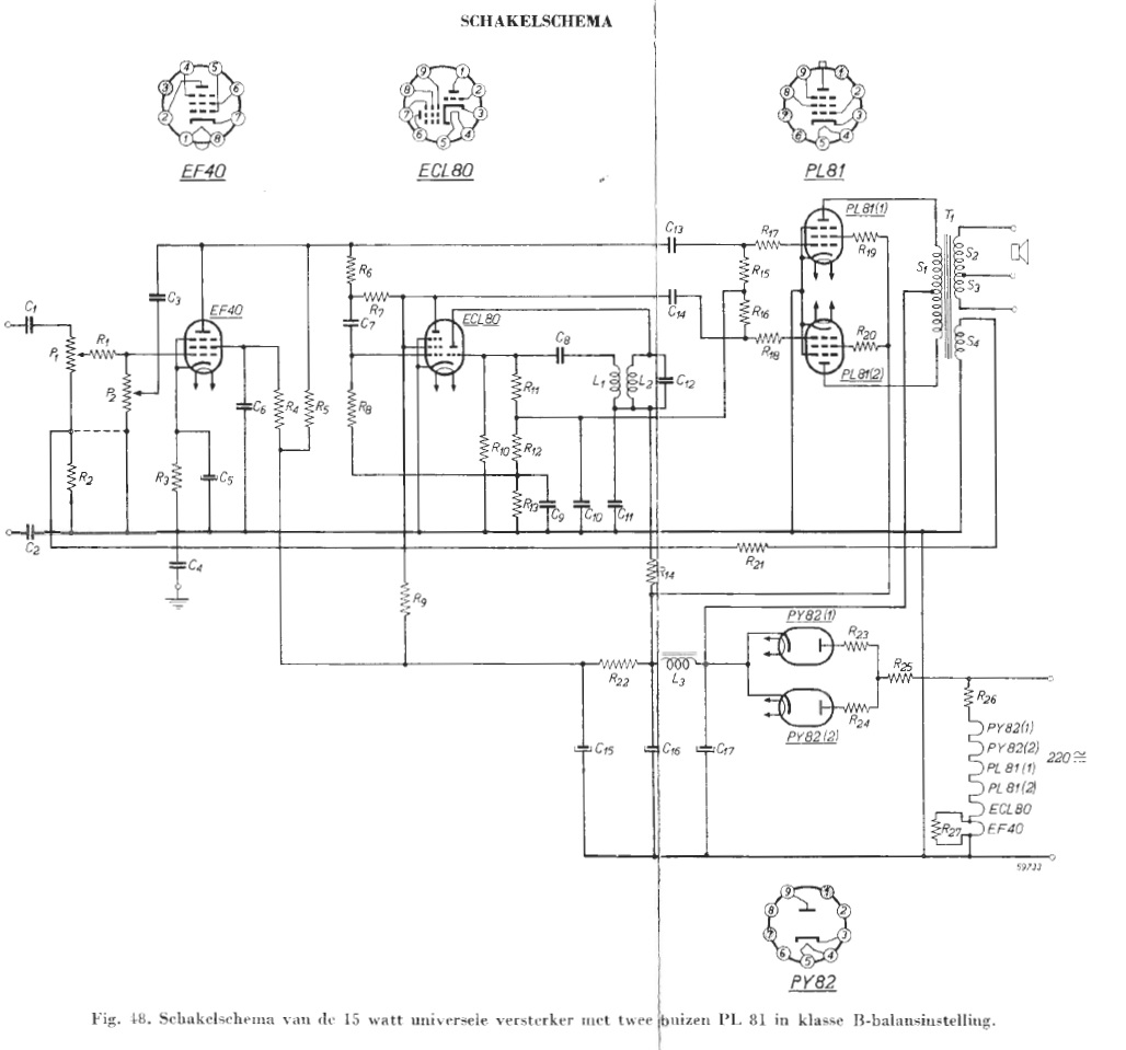

Probably off topic but in this class B amplifier the bias for the 2 x PL81 and the (triode connected) pentode section of the ECL80 are produced by the triode section of the ECL80 which is connected as an oscillator (2 MHz). In the book it says that about any AM oscillator coil can be used for L1/L2.
Warning: This amplifier has no seperation from the mains so would be dangereous if the chassis could be touched during use (hence the two input capacitors, the capacitor to the ground connection and no connection between the chassis and the loudspeaker outputs).

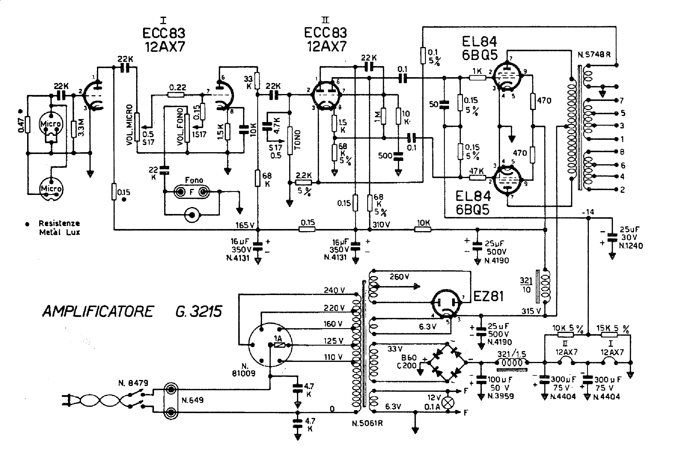

This circuit is a distintive feature of small PA amplifiers built by Geloso in Italy after the war. It was a very successful design because it was dependable, easy serviceable, at a lower cost than most alternatives. The design has been finalized on the 1949 PA amplifiers lineup and remained in production for two decades, with minimal variations. On the last models, 12AX7 replaced the 12SL7. The manufacturer literature does not mention the protection featured when a tube is missing, but this surely has been a consideration.
The Geloso company founder was the chief engineer of the Pilot Electrical Manufacturing company in the '20 and a tecnical consultant of the Radio Design magazine. As example, an article about one of its designs is on the winter 1929 issue of Radio Design (vol1 number4).
Another quirk of this design are the asymmetrical power tubes grid stopper resistors. The resistor value of the top tube is much lower than the one of the lower tube, and the tube with lower resistor value does have an extra small value capacitor to cut the bandwith, presumably to bring it in the same range of the lower tube. I attach the schematic of the G3215 model. I don't understand the purpose of this asymmetry. The specified bandwith of the amplifier is 30Hz - 10kHz. It is now sometimes repurposed as musical instrument amplifier because it does have a pleasant warm sound.
