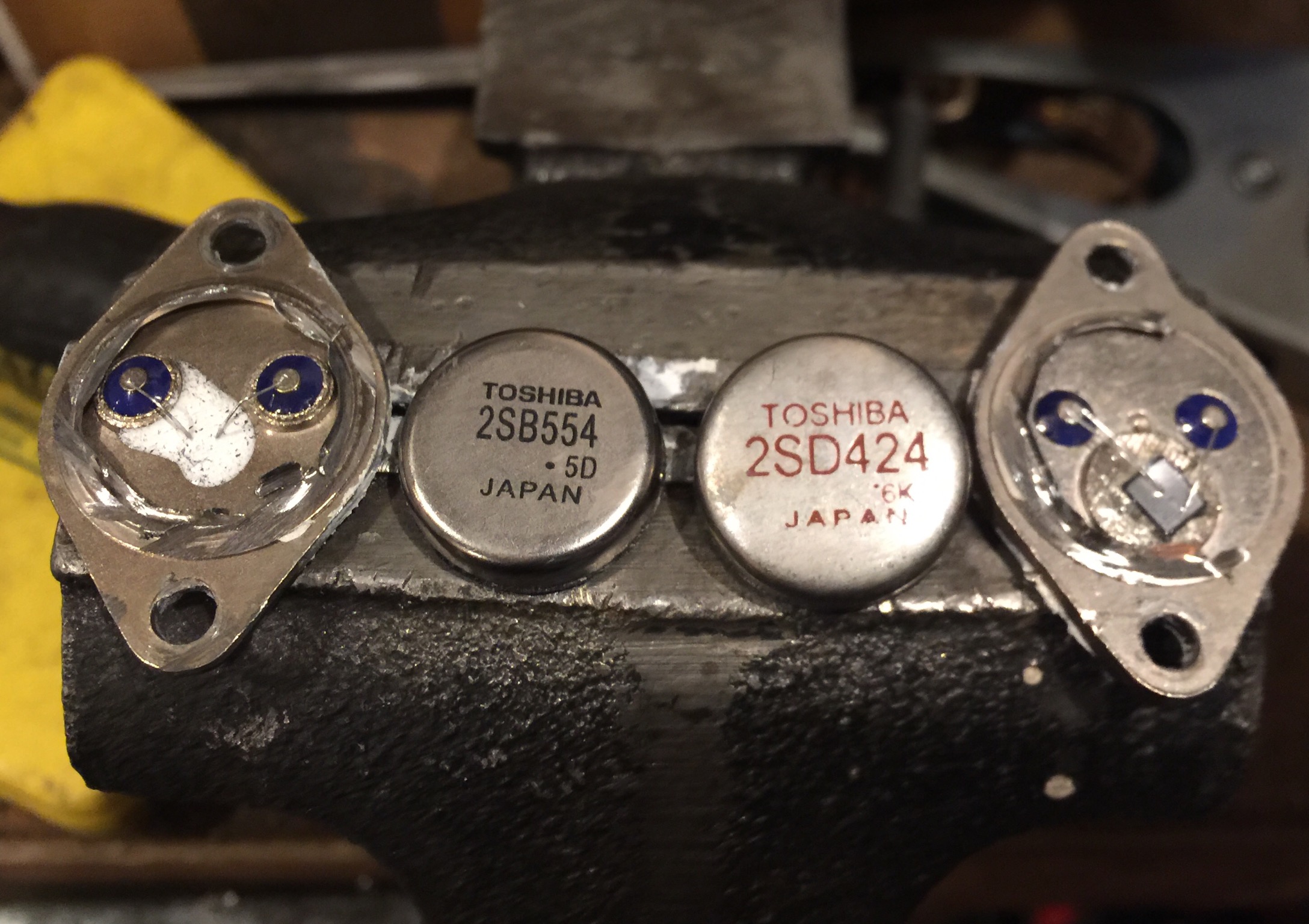

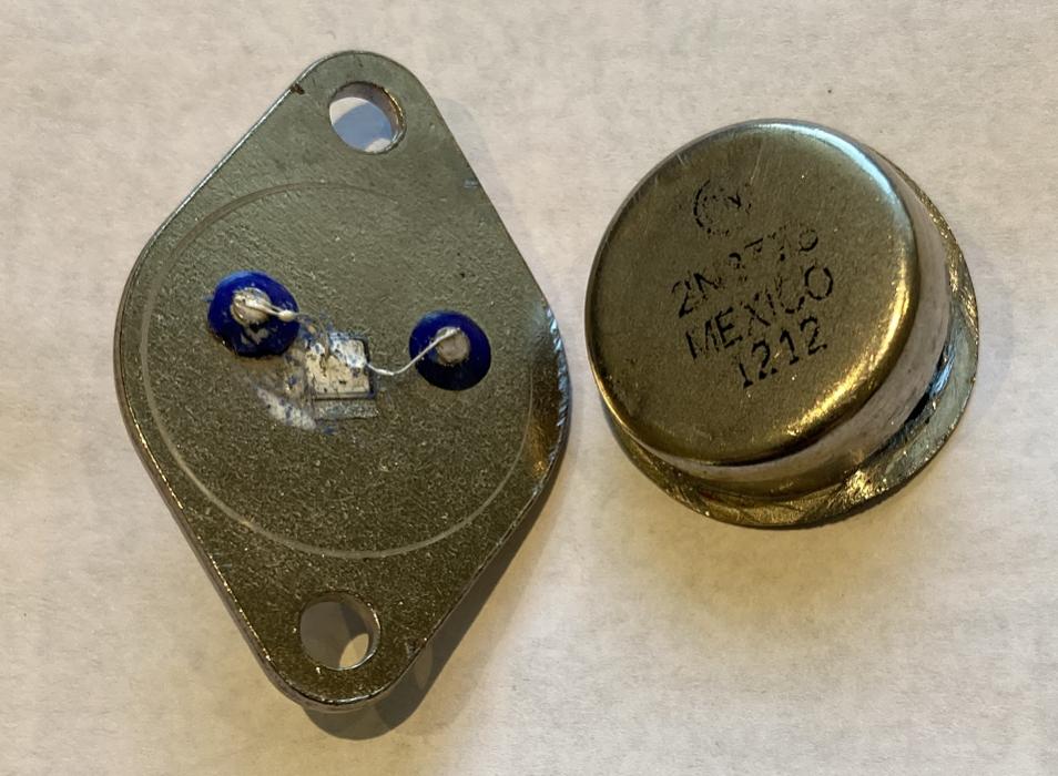

Don’t order parts on eBay, I’m convinced they’re all counterfeit. You can see the dies on these supposedly genuine transistors aren’t even 1/4th the size of the originals, and though the amplifier seemed to work OK they blew and torched a receiver I repaired at only modest volume levels. So learn from my mistakes, even if you don’t think it matters, it really does- even at low power levels.

You didn’t actually expect to find real D424/B554 parts ANYWHERE, did you? The last ones I got were from MCM in 1988, when it was a very small outfit and sold just about any jap transistors that you could get. Use MJ21194 and 21193 and call it good.

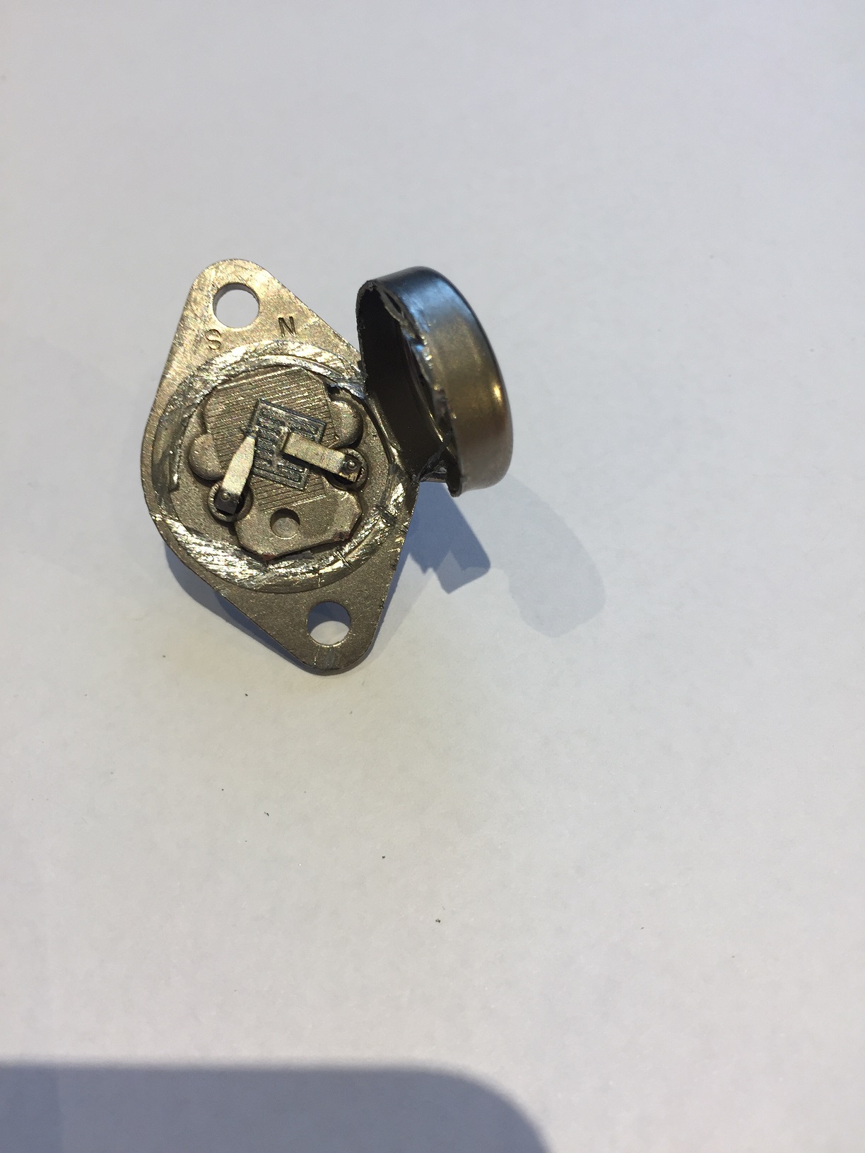

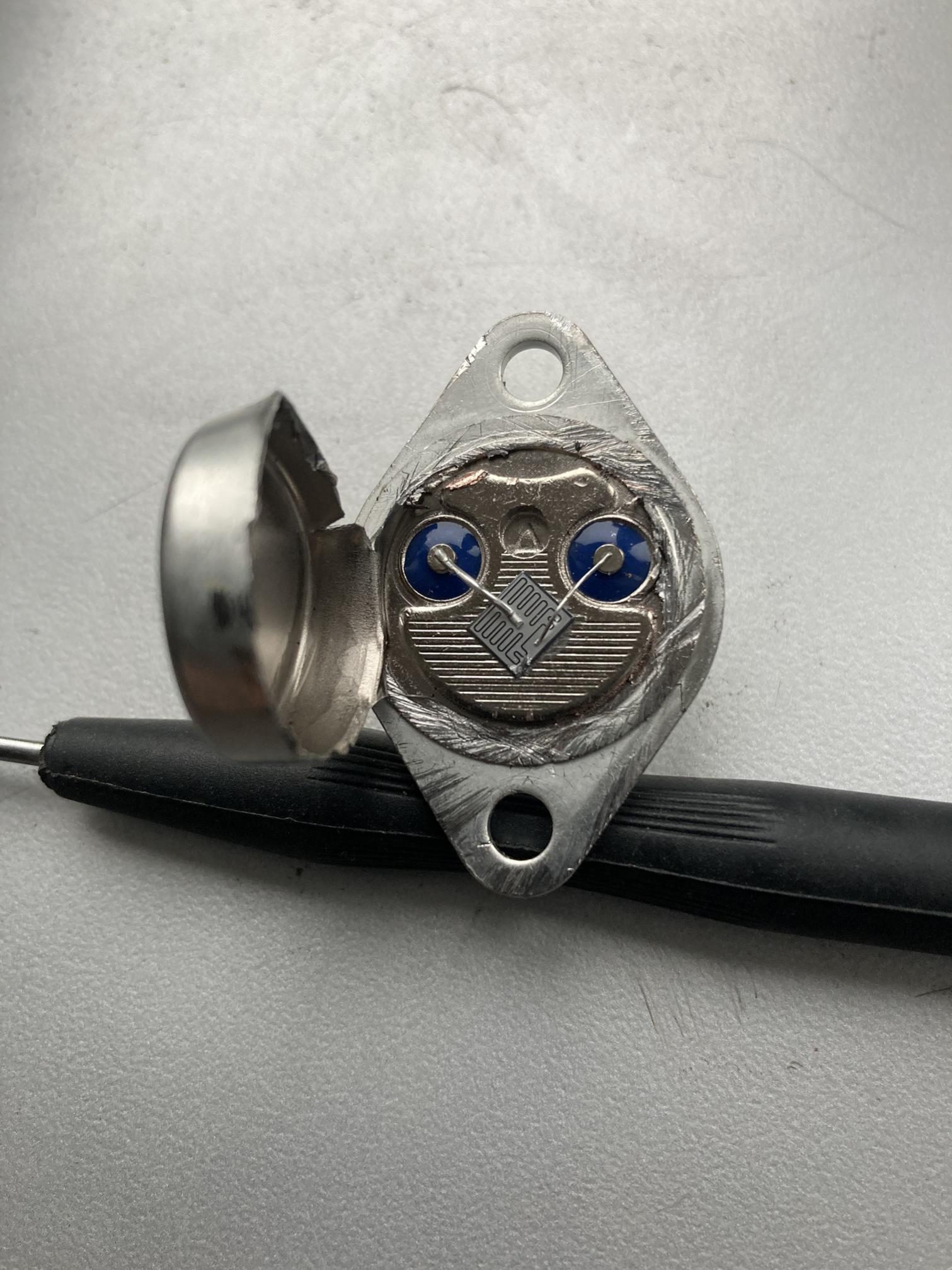

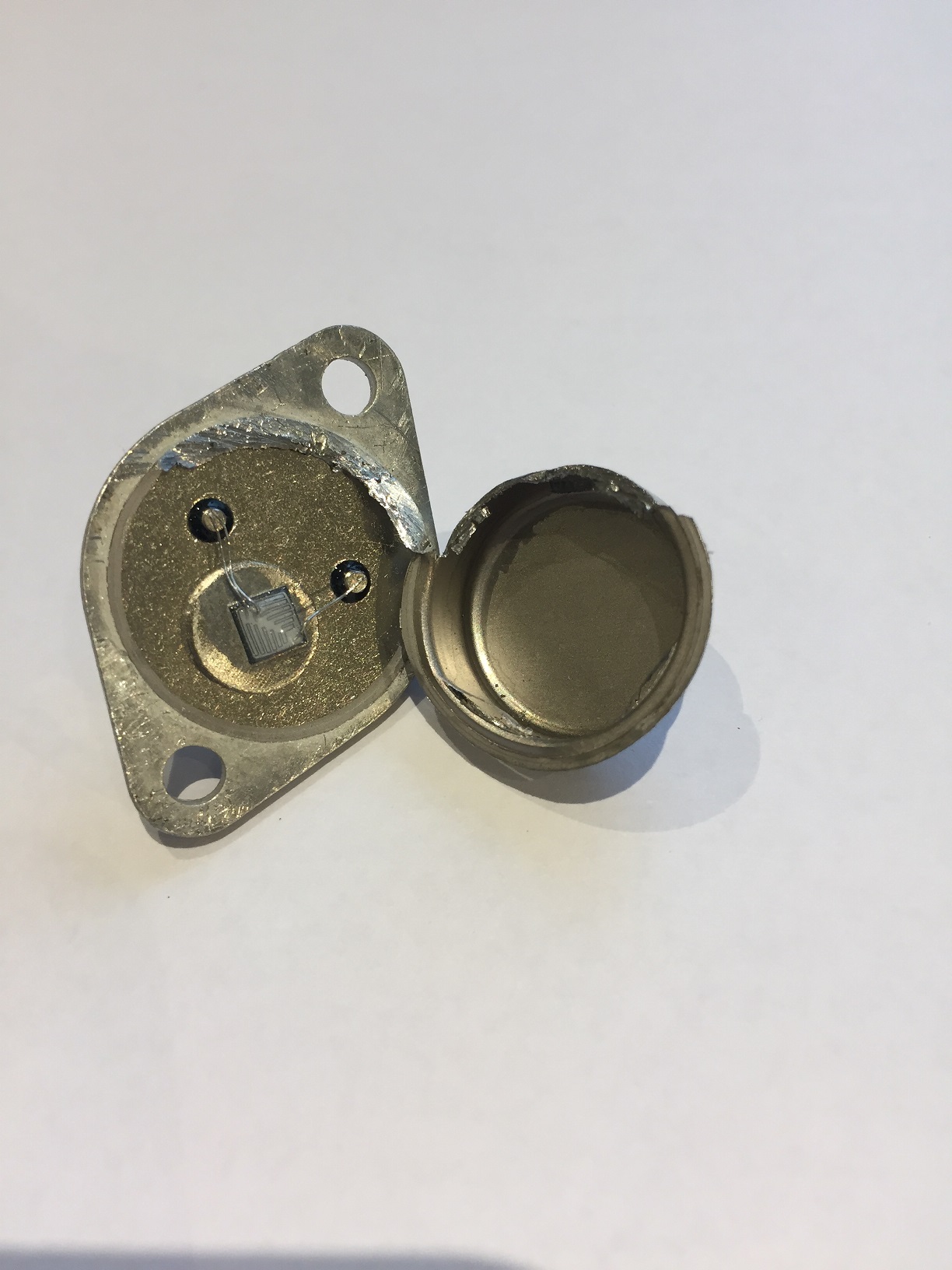

Whenever I buy from China, I always make a test purchase first.
These are then cut open to check the die size.
All the photos are of " 2N3773s."
2 were bought from China and one from the UK.
I'll leave it for you to decide which is which.

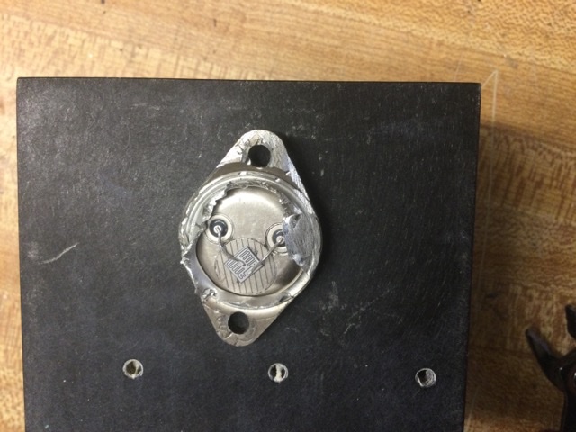

I thought that I would post an image of the latest batch of "2N3773"s to arrive.
I cut one open immediately to see what's inside.
I am not convinced the die is large enough but it is larger than some I've seen. ( see earlier post )

Yours is absolutely real. That is exactly what they are supposed to look like. Compare to 8013 date code aluminum cased 2N3773.
