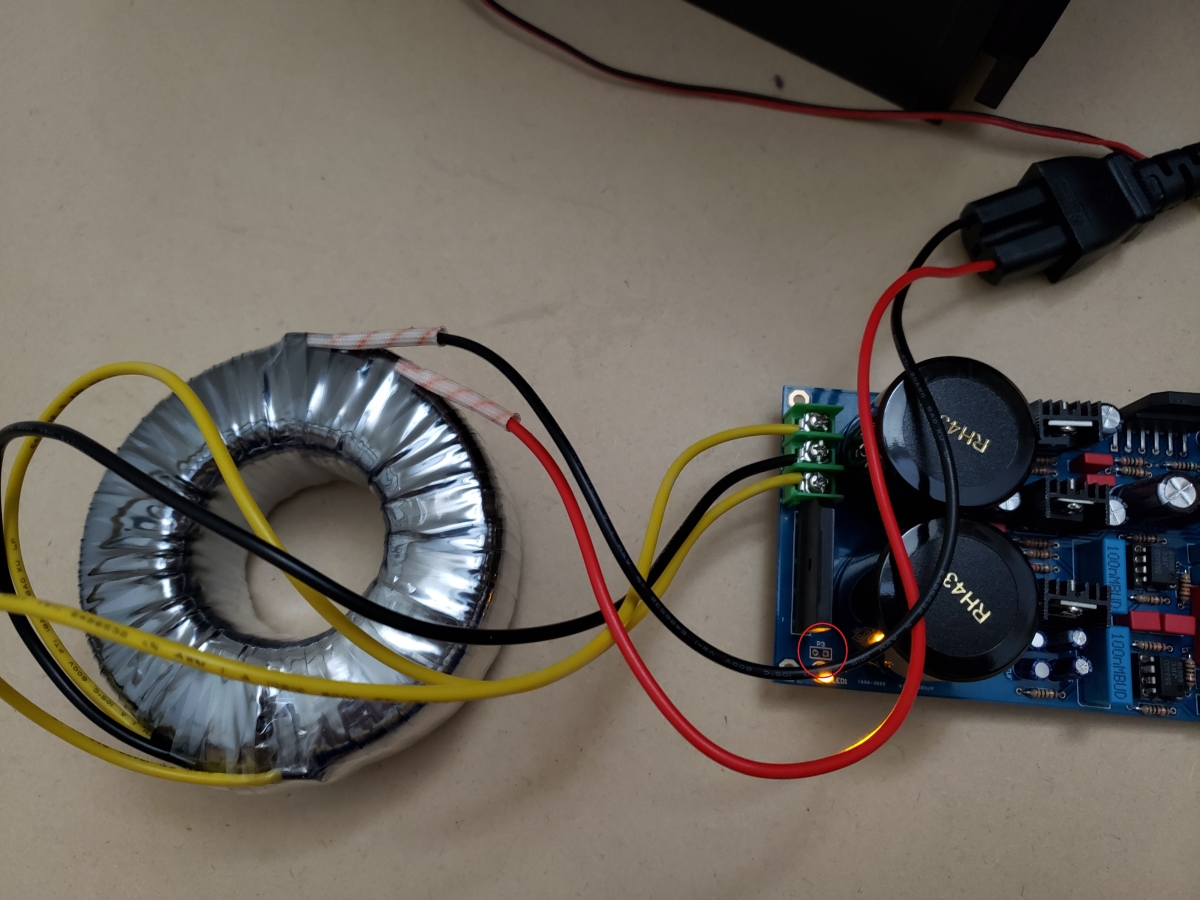

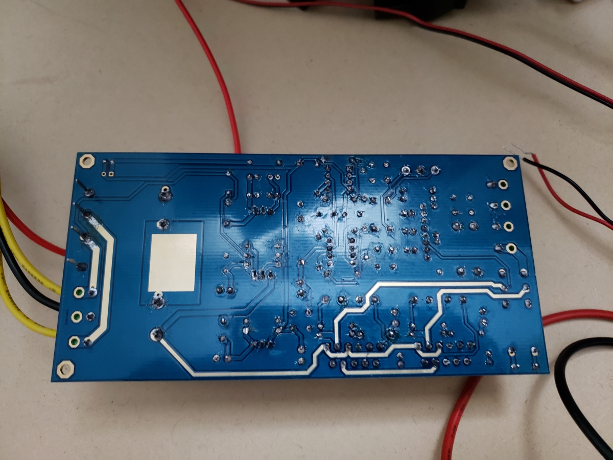

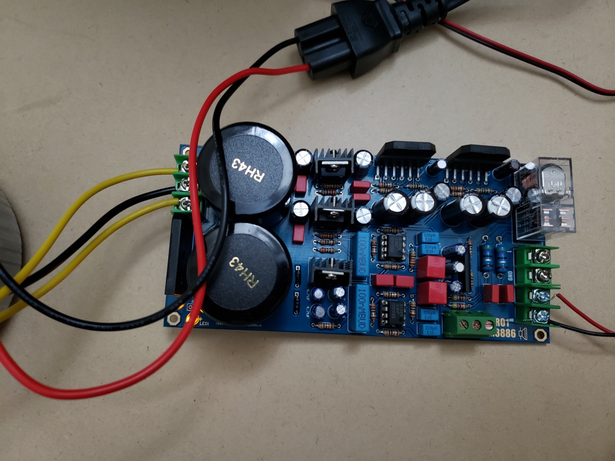

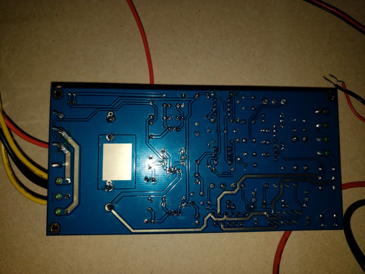

Thanks for your replies here are the pictures and schematic, I am not great at soldering but I did the best I can. The Schematic is not very well most of the components don’t have any values so I improvised by looking at the pictures of the build from eBay listing and checking the PCB layout with sizes of capacitors that fit. In the schematic what does P3 mean? I didn’t connect anything to them as seen in the picture with the red circle. I had connected the main 110V 50Hz (US) line to the transformer without any ground as you can see in the pictures. I see the small LED glow and then with or without the audio input to the board I get that high pitched sound while I connected only one speaker at a time to pins first to Left and then Right, so I don’t blow both speakers if something wasn’t right I have a recording of the sound that for 5 sec. The audio amp chips heat up(LM3886) while this is going on everything seems ok. I don’t have access to a scope can you guys please help me out in getting me to power my first major electronics project.

No i had not mounted the LM3886 on the heat sink just wanted to test it before was it a bad move? I powered them for not more than 2 minutes saw them heat up.

P is usually used to denote a trimpot.

I think the P3 is just a connecting point for an external power led?
Are the pictures of your finished board? You might want to use more solder in your joints, some look quite bare.

Always use a heatsink.
The input connection, red is ground? The very best solution is coax cable with twisted pair as a second best.
Soldering could be better.

I will re solder again and add some more solder and attach the heat sink, the transformer has only 2 leads black and red, as its AC i just put into mains but where do i have a common ground across the circuit ? Should i just solder some thing to the base plate of the metal case ?. Is that the reason for the High Pitch sound I am attaching the mp3 file of the sound i get from speakers here for your reference please help me out every one.

I'll throw this out - my LM3886 from eBay makes weird noises with no input connected. Your photos don't show anything connected to the input, so that's why I am adding this comment. Must be connected to a source, no floating input, or it makes similar sound.
Also - must use a heat sink as others mentioned. I use a 3-prong (grounding IEC plug on your case) and take the ground lug directly to the case. Drill a hole and use a bolt and locking nut to ensure good contact - safety in case you have a short, it will blow the fuse immediately and not cause a shock scenario.
If you have a DMM - check for AC and DC on the outputs. I bet the noise is AC noise.
I was commenting on the amps inputs that should be a coax cable, not the transformer. Also, what are you using as a source? For testing, I use a cd player with a variable output and a chopped in half interconnect.
