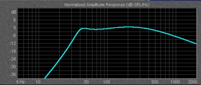

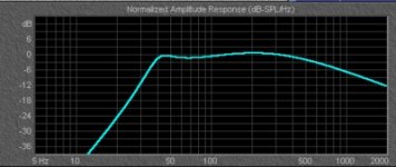

There good. Its just they won't perform like EAW SB 850's.
EAW used RCF in their earlier model, then moved over to B&C.
You purchased them already so, we'll make the best of it.
Now. Since this is a PA Box, we cannot rely on room
gain, nor heavy eqing to make this box sound good.
It needs to offer the frequencies without any aid.
The Box will be tuned at 40 Hertz, giving you a - 3dB
at 37.82 Hertz Normalize Gain. If you like what you
see, I'll give you the cabinets dimensions.

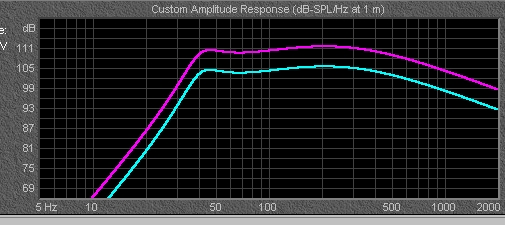

This is the comparison when using one box versus two.
Purple Represents Two Cabinets
Blue Represents One Cabinet
You're looking at 104 dB from 100 - 40Hz using one box, and,
110 dB from 100 - 40Hz using two boxes (2.83 volt, 1 meter)
Note: Measurements are an estimate (+/- 1 dB)
