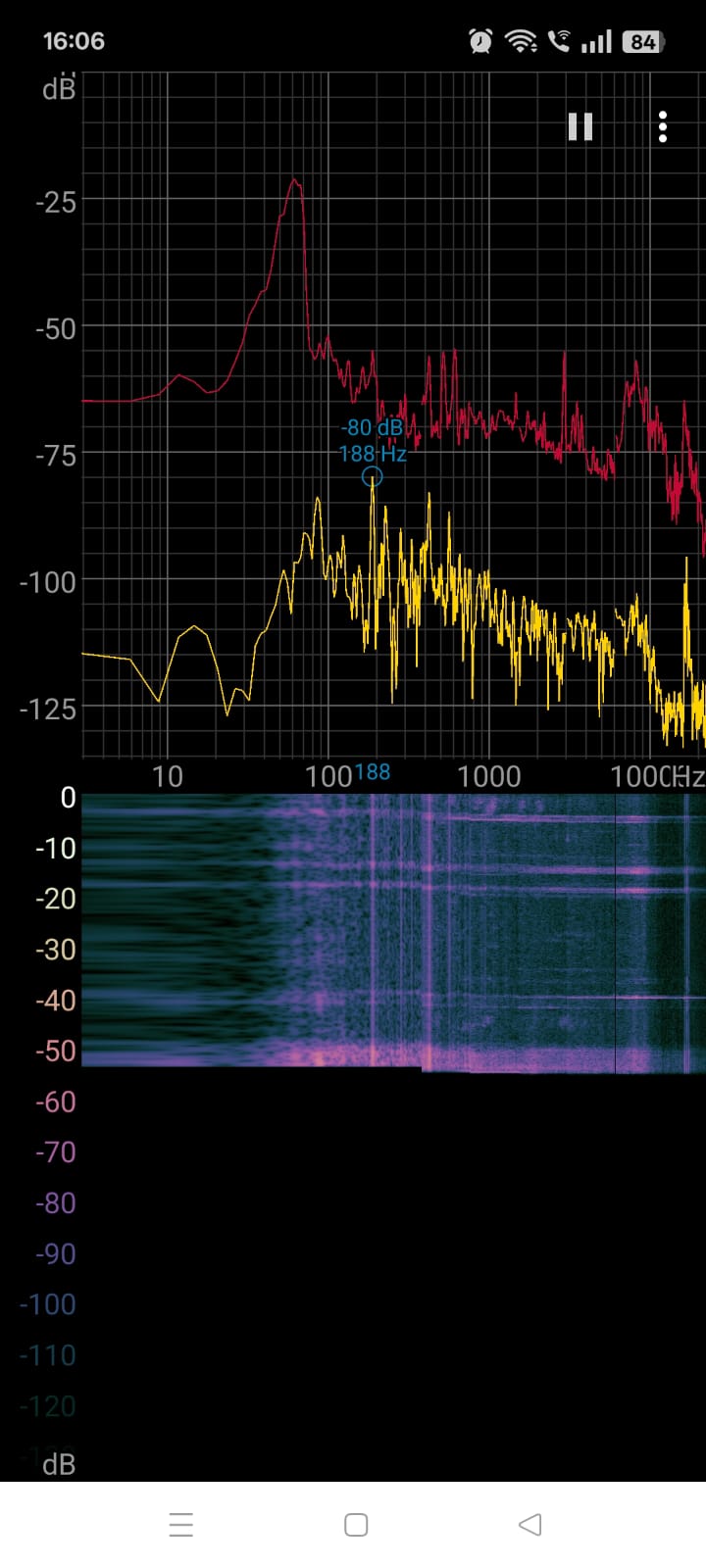

Here is the method
1) Install Spectroid app on your Android phone from Google playstore
2) Ensure there is relative silence while doing this test, we want to keep the noise floor down.
3) Prepare to run frequency sweep from youtube
This is a sweep from 25Hz to 150Hz. You may use any other way of sweep if you want to go lower than 25Hz. Pause the video at start.
4) Bring your android phone mic as close to the port as possible keep 1 cm of distance but dont touch the speaker or sub with your phone. The idea is that the mic should mostly catch the audio from port only and other sounds should appear as noise coming from far.
5) Start the app
6) Run the sweep from youtube, when it completes, notice the peak in response in bass in the red curve of the app, that's your tuning frequency
7) Repeat above to be sure.
Note:- Android phone mic is not a good way of measurement but for this purpose, it works
Below is my speaker's 60Hz tuning
Hope it helps.

The port peak output may differ slightly from tuning frequency, it usually seems to be a bit lower, at least for high Q tunings. See here (and the next posts that will follow):
https://www.diyaudio.com/community/...rbers-and-port-geometries.388264/post-8001305
Tuning frequency per definition - and as far as I understand it - is where the driver has it's excursion minimum, thus the impedance minimum between two peaks.
