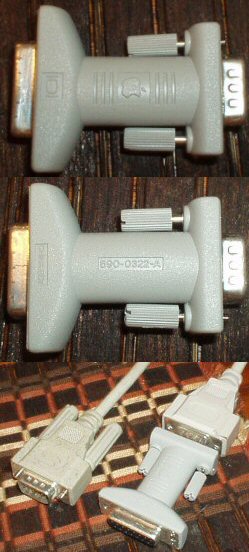

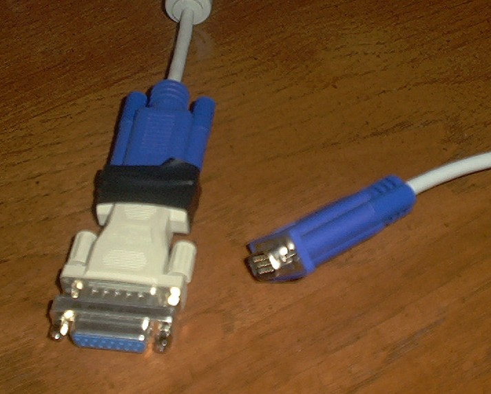

My nView Spectra was doing wierd things(flickering), and I narrowed the problem down to the VGA cable. I didn't want to make a cable(connect the individual wires), and buying one is next to impossible, but I found an easy way. I found a Macintosh connector, it has the VGA input that nView panels need and standard VGA on the other side. This connector, combined with a VGA extension cable(a few bucks or less at any PC store), and you have a fully working cable. According to a friend the connector is fairly standard. There's a few pics attatched... hope this can help some of you that have an nView with a missing VGA cable. The # on the back of the converter is 590-0322-A.

Ehuwiko said:The # on the back of the converter is 590-0322-A.
I bought nearly the same adapter today (590-1120-A) today and all the flickering is gone!!!
It looks the same as yours ehuwiko but perhaps it's for european VGA???
But who cares since my two panels are working now!

Be forewarned ahead of time. Certain mac adapters will not work (even some that look exactly like that particular one). Some of the adapters do not flip all of the wires needed.
I purchased 3 on ebay before I figured that out (kept thinking I was getting bad adapters so I fired up an ole mac g3 and figured out the adapters worked fine).
Just a heads up.
