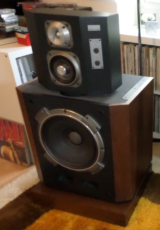

Placing a small speaker on top of a subwoofer
To make a long story short I am looking for a system to mechanically decouple the small speaker from the subwoofer box
For now I have thought about the following options:
thanks everyone
soon I will have a problem
- washing machine feet
- squash balls held in place by plastic rings that prevent them from rolling
- small diameter air chamber
- gymnastics mat
- marble slab with adhesive rubber underneath

Hi yes ! i see this as more challenging 😳Also, reducing the vibration of the sub cabinet.
it's like where to deal with an aggressive guy
better to stay away Isolate him
But yes it will be an an attack on both fronts

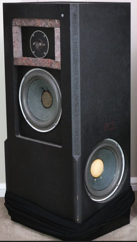

Have you considered the dual opposed sub configuration? This is two drivers on opposite sides of the box which cancel box coupling to some degree.
If I were to do that in the case of the image you attached, I would cross the woofer on the back to only play below the Schroeder frequency. It may be possible to combine that with the baffle step by making the box large enough.

no I would use just one woofer on the front In a closed cabinet I know that is not the best for extension and vibration but i prefer a simple solutionThat looks interesting 😉

Before you attempt to solve the problem, you might try to measure it. You can then repeat the measurement after each fix is applied to see if it is effective. If you're just out to have fun, just buy lots of stuff and try it. An example setup would be to play a low tone from the woofer and a high tone from the midrange at the same time and measure the spectral response. Then set the upper box on an inch or two of foam rubber or a small pillow between the two and repeat. If the woofer is moving the midrange or tweeter sufficient to modulate the output it will be easily visible as a new spike in the measurement. For isolation I have found that thick shag carpet, a Dacron pillow or squares of mattress foam work well. The key is to have it very flexible so that the low frequencies couple poorly. Little metal cones and small rubber bumps need not apply. I've seen people suspend cabinets with what are effectively bungie cords.

thank very much but i want to face the drivers![]()

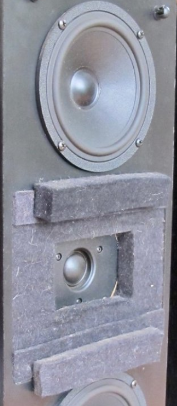

I am limiting at least the head dispersion with felts or foam like seen in some designs

At low frequencies (<4-500 Hz) is omnidirectional. Makes little difference which way thewoofer faces.

Thanks a lot Yes that is the goal to have fun MostlyBefore you attempt to solve the problem, you might try to measure it. You can then repeat the measurement after each fix is applied to see if it is effective. If you're just out to have fun, just buy lots of stuff and try it.
interesting I have just bought 12 rubber pads for washing machines supposed to be used as footers They are so cheap that deserve a tryAn example setup would be to play a low tone from the woofer and a high tone from the midrange at the same time and measure the spectral response. Then set the upper box on an inch or two of foam rubber or a small pillow between the two and repeat. If the woofer is moving the midrange or tweeter sufficient to modulate the output it will be easily visible as a new spike in the measurement. For isolation I have found that thick shag carpet, a Dacron pillow or squares of mattress foam work well. The key is to have it very flexible so that the low frequencies couple poorly.
but i think i will end with air balls on something concave to keep them from rolling Like small plates i do not know
i guess that the vibrations could be mostly horizontal So the usual footers with spikes could work They do not isolate from vertical vibrations i guessLittle metal cones and small rubber bumps need not apply. I've seen people suspend cabinets with what are effectively bungie cords.
