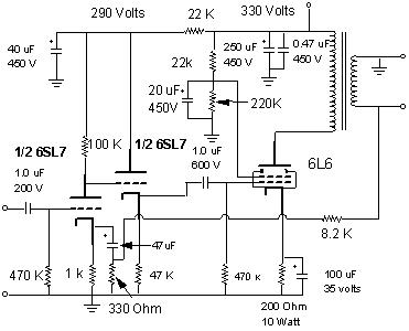

A while ago I was just poking around on the net and ran across this schematic for a 6L6 SE amp at Single Ended Tube Amp project [/URL]

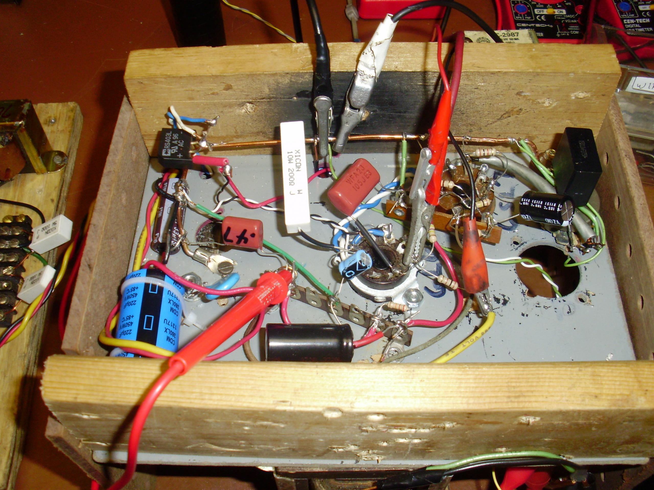

I got bored and started building it one afternoon and just finished it a few days ago and I have to say that for such a simple little circuit it sure sounds great! I just wanted to post about this to share this with those of us who know their way around a schematic and understand how tube circuits work but are by no means "Tube Gurus". It was a fun weekend of soldering point to point and tweaking things around.

Wattage of the resistors
Hello,
I want to try this schematic also , as my first tube amp.
Please post also one power supply schematic without choke (if it is posible).
And what wattage are the resistors ? It is OK with 0,5 W?
Except the 200 Ohm resistor,whitch is 20W according schematic.
I am building a version of this amp also, with 1/2W resistors, except for any that are specified larger, with no problems... Using a tube (5U4) PS, and gas regulators for the output screens...

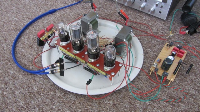

Here is one channel, and the PS I'm working on... sounds like it has potential,,, I need a larger PT...

Thank you for replying,,, I am currently building the SS PS from that site,,, Just wanted to try it, but will use tube PS, when I find a larger power transformer...
