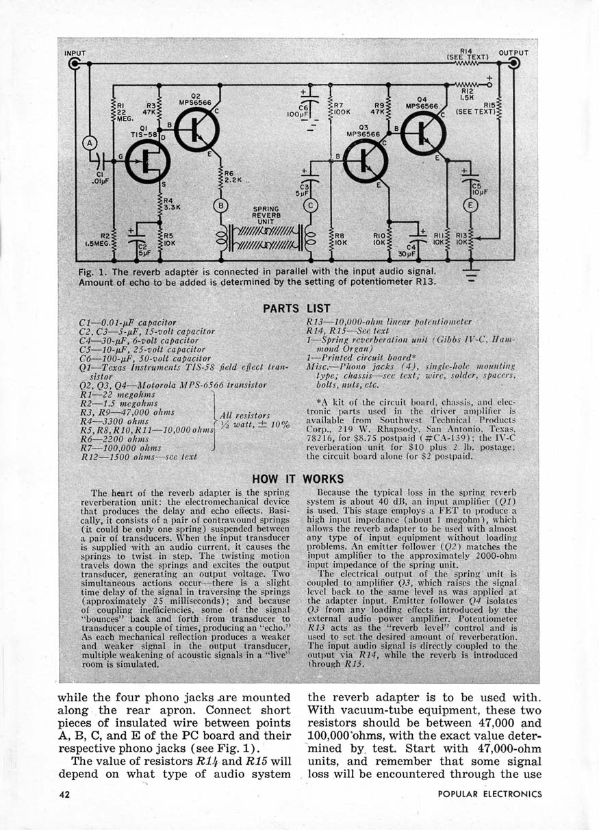

if no spring then btdr 3, but try spring one more time , use a good hi-pass filter on line input and output.
here is a simple one but it uses a spring.
