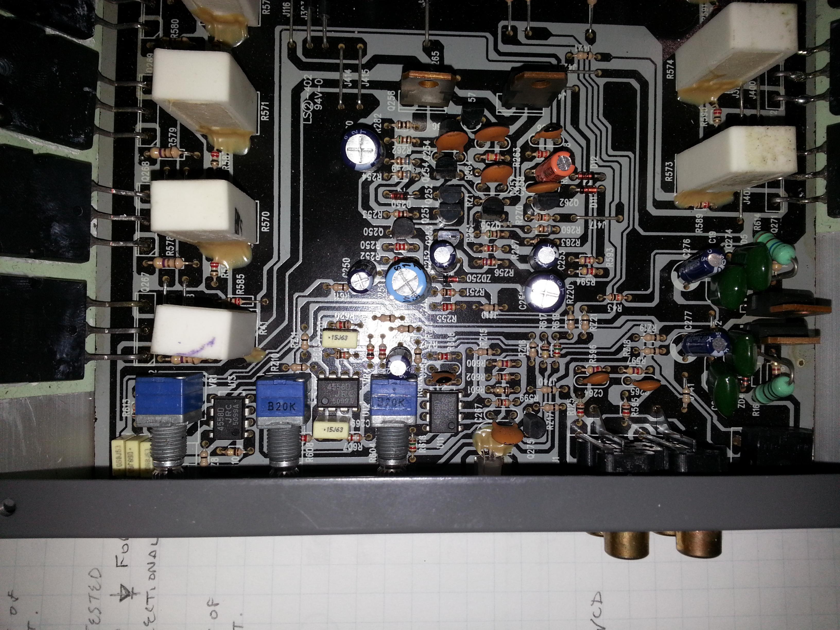

I bought this t500.1 mono block new from a JL dealer back in 2005ish. Before JL bought them out, or so i was told. Was running it with a kicker L7 12inch, which was quite good, but then ran a 13w6 for about a year. Since its been sitting in a project car. So total use was limited, 2 or 3 years. Then off and on once every year or so.
The unit powers up fine, green power light is on. The yellow and red aren't, only opon start up as it warms up, 3 to 5 seconds....
I started noticing it making a thumping sound when turning off, enough of one to push the sub pretty hard. Over the years it has blown the number 1 and number 4 fuse 1 time. Its only gotten hot enough to thermal once. (120degree day)
Well, i went out to start my car, (drive once or 3 times a year)
The amp powered up like norm, no sound, but thumps hard when turning off...
Checked hu, tried other amps, all work fine. Checked all the obvious stuff, 0 gauge positive and neg, all good. Like i said,dropping in 2 other amps worked great.

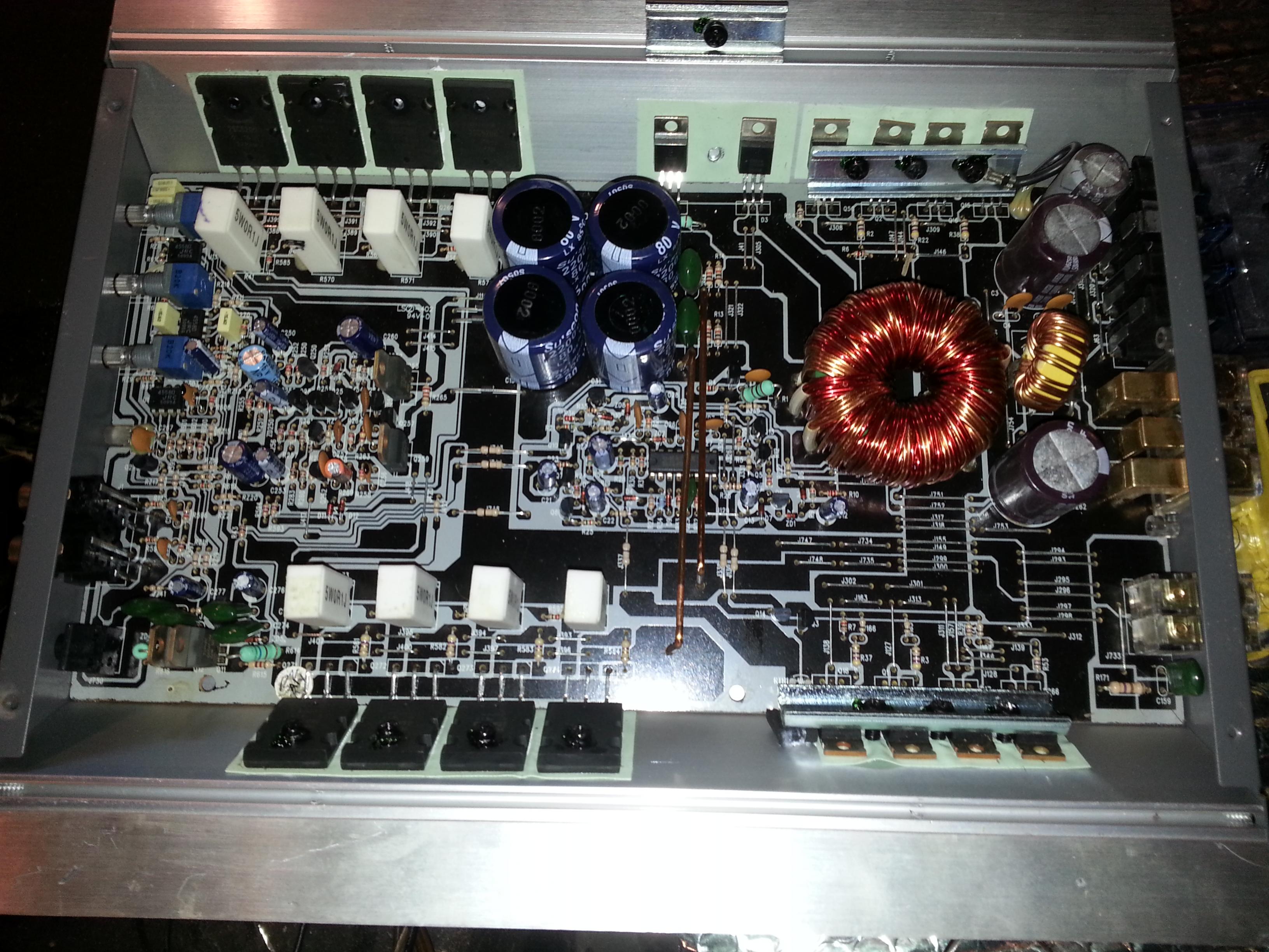

So i took it apart, did a visual, clean as a new one, no corrosion,burnt spots etc, 1 of 4 2200uf 80v caps was bulging, but not ruptured. So i just bought all new and replaced. Bench tested, same results, but i get bumping if i turn the gain to max, and turn up the mp3 player to near max, hit and miss,and destorted as heck. Bench testing before the caps was no different.
I have tested out of circuit, the output transistors, all seem to function properly. The only thing that gets smokin hot is 1 resistor . I would be happy to post pics of anything needed.
At this moment i am stuck, i believe all the mosfets are doing their job,tested every diode i can find etc.... just lost with out some help.
I dont have a scope tho. Just a proper DVOM or " DMM " as i see used regularly here.
I am willing to try anything with some help.

The datasheet on the op-amp chips (JRC4558D) pinout is simple, but the readings are sorta weird to me, seemingly inconsistent to what i would expect to see, but without proper value specs of what's supposed to be coming and going from this particular area of the amp, so the reading in pinout form are as follows, and if these are useless to you, may you explain what outputs you mean, and where i would expect to locate them on the board from the original picture i posted.
All 3 of these chips read the same way and exact same values.
1: 0.021vdc 8: 14.75vdc
2: 0.012vdc 7: 0.015vdc
3: 0.012vdc 6: 0.015vdc
4: 29.85vdc 5: 0.012vdc

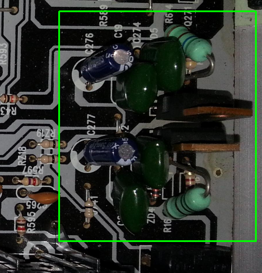

Also, there are 2 light green larger carbon ceramic resistors in the bottom right of the pic that get so hot within 15 to 20 sec of powering up that i can not touch them, and feel heat pouring off them from 8inches away. Doesn't seem to be normal, but i have no clue. The voltages going into those are 55+.... so maybe thats norm....

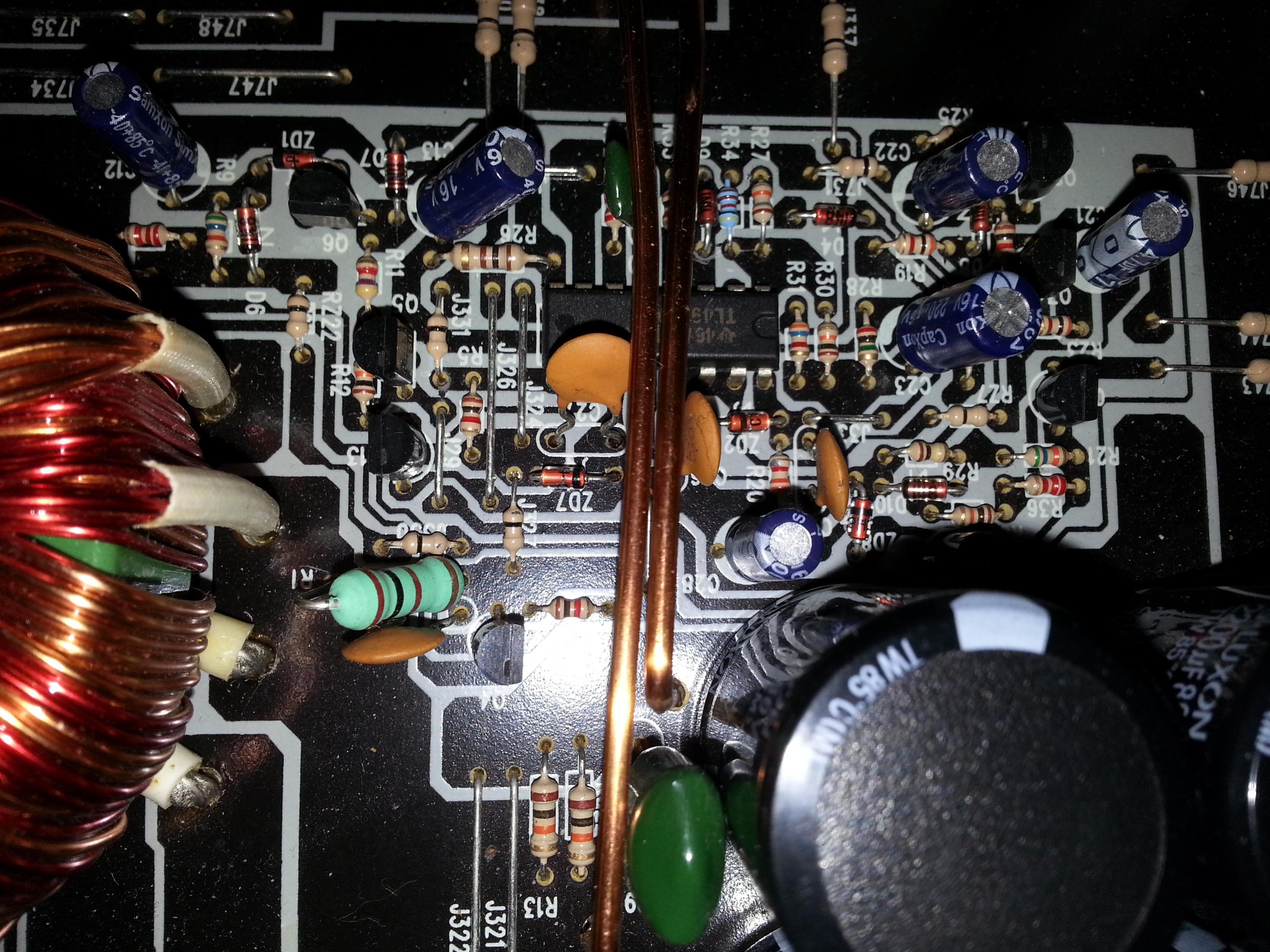

4: 29.85vdc !!! A little high... should be about -14.75. Place the neg lead from your multimeter to the shield of one of the rca jacks, pos lead to pin 4, (-14.75) Then check pin 8, should be about (+14.75). Most amps use a split power supply and will use zener diode's or voltage regulators to get the rail voltage down to aprox. +/- 15 vdc. Try to find the Neg zener diode or regulator... sounds suspect.
Supply Voltage Vcc ±22 V as shown on the data sheet for this op-amp.
The components in the lower right corner (in previous photo) are the regulator components. The resistors are large so that they can dissipate the heat without failing.
The high negative voltage could be due to a defective Zener, bad solder connection or shorted regulator transistor.

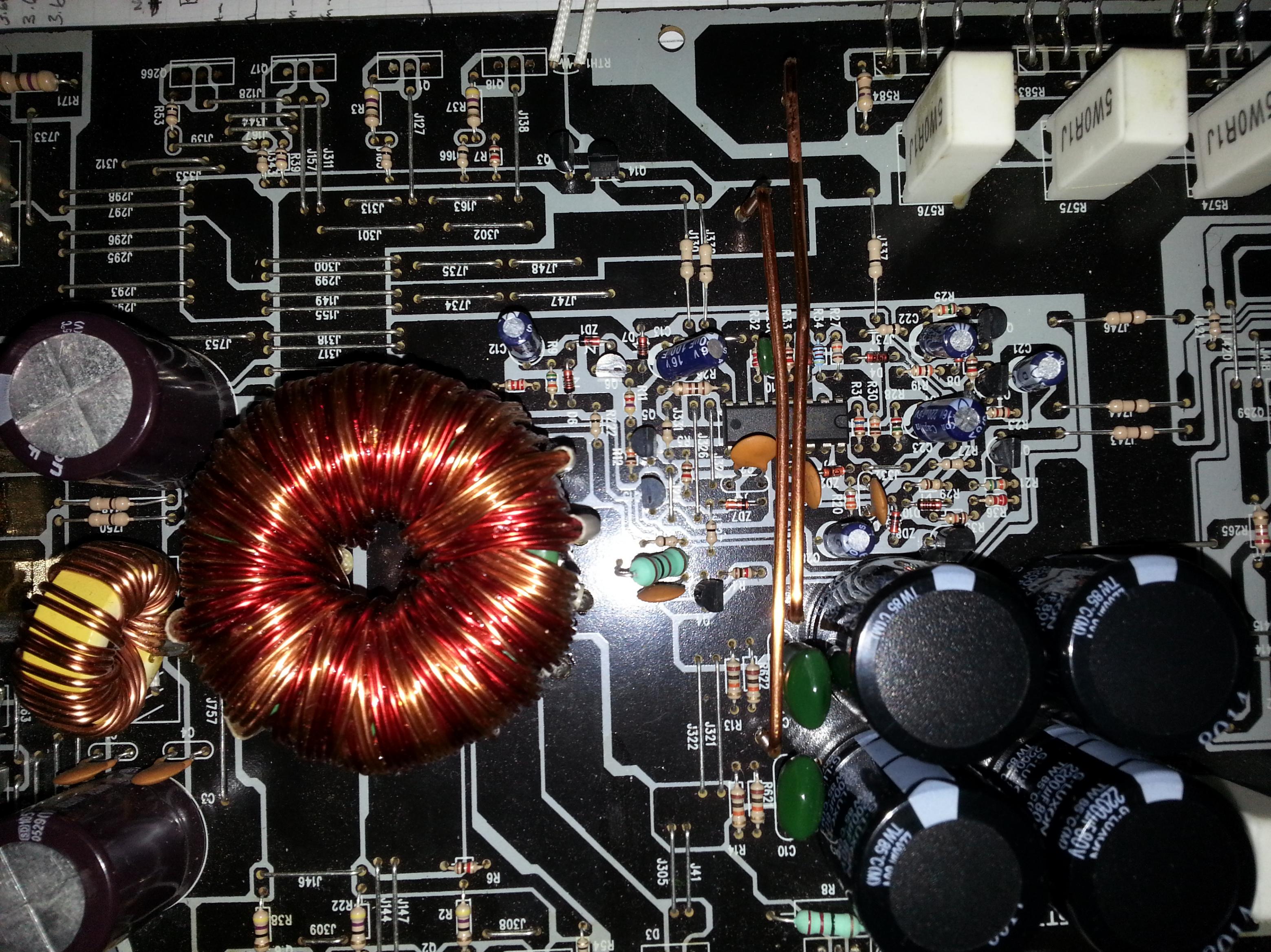

Hey guys, so i took everything apart again and tested every zener outta curcuit, they all test fine, until i put them back in, they test great except for 1, the thing has reverse polarity while in circuit only. This is with all npn's (ifrz46n) out of the board. Logically speaking, something about that curcuit seems off.
Have you ever had one test good out of its intended curcuit, but change in? I have removed it several times to see if its a fluke.... but fails every time.
Specifically, which Zener?
What do you mean by 'reverse polarity'?
Photo of zener in board (as it is now, not an older photo) and area around it.
I'm sorry, it has continuity both ways with unlike the others. But only in circuit.
The location is ZD7 just below and left of the chip in the center. I took 2 pics for you. One from a distance, one right above it.
The zener type is c11ph.
