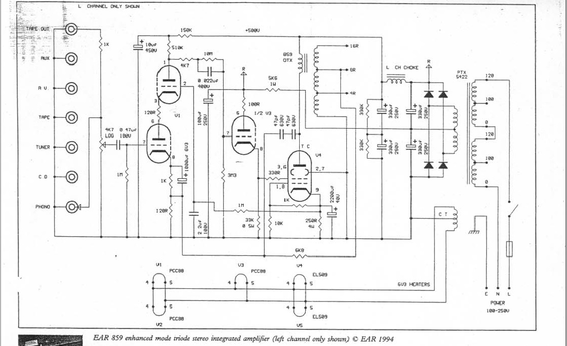

Years ago in HFN&RR. The schematic was posted in the article. Search HFN and see if there. If not I might be able to dig up article and scan. I was thinking or going this way recently but decided on a Tubelab SSE.
Steve
will try ,but I'm not having much hope , considering that I already invested decent amount of time searching the web .
to repeat - I have 859 schematic (from Sound Practices , presumably published with Tim's blessing) ..... and I'm interested what exact changes are for 869
not interested in cloning ,but proper analysis
tnx to both
hello ,
so your possible help ... look the pic ...
good luck 😉
