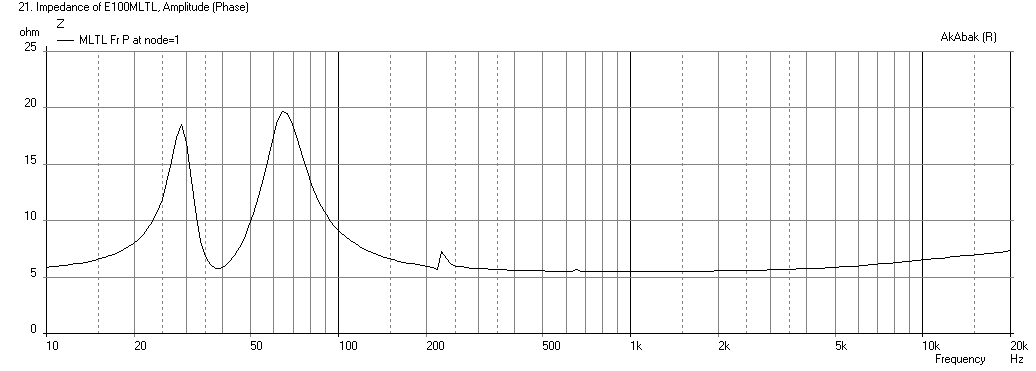

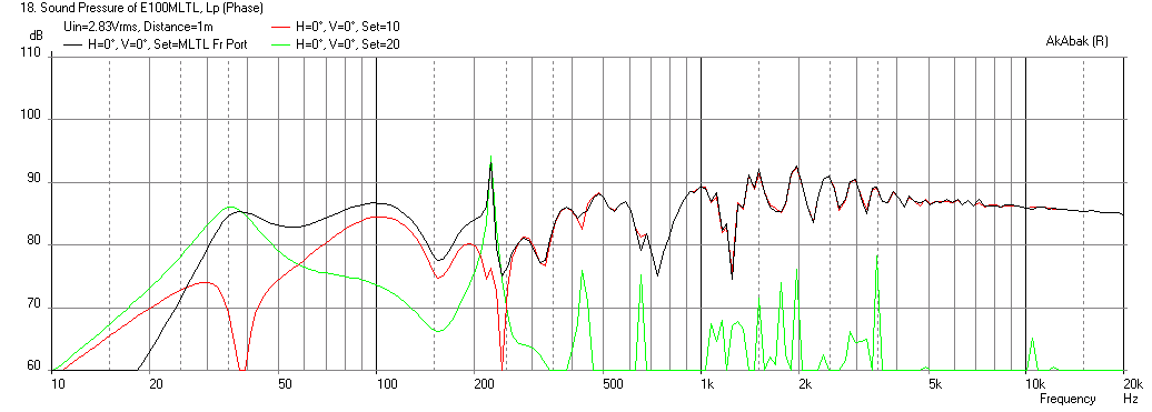

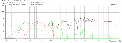

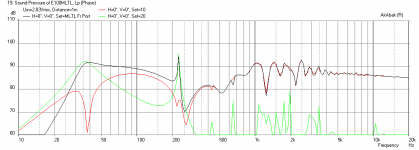

How well the E100HD will work in a box designed for the JX92S depends on how significantly its electromechanical spec. deviates from that of the original drive unit. As GM says, the E100HD needs ~double the Vb of the JX92S for a similar alignment.
Sim of 31 inch MLTL for E100HD

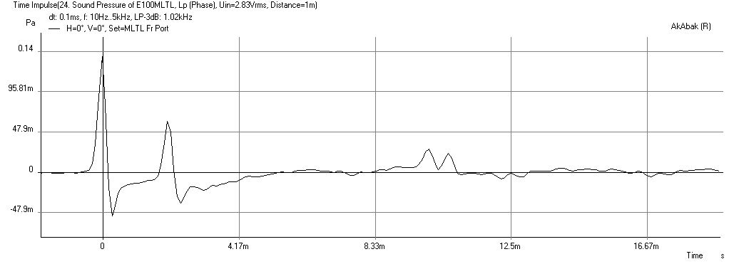

I ran a simulation of the 31 inch MLTL with dimensions as provided by EAD (without the donut baffles). GM is correct, the tuning frequency is about 40 Hz (maybe 37 Hz). There is no damping in AkAbak so you will see sharp peaks and dips, but broad features are probably going to show up. One thing to be careful with this speaker, as with most speakers is the placement in the room - it can really have an impact on big dips as you can see. The first plot is the freq response at 1 m away with the speaker placed flush against a wall so that you essentially have no baffle step loss. The second plot is a 'typical' placement of 24 in from a back wall and measurement at a typical listening position 3 m away - not the large dips due to room suck-out. The third plot shows the speaker 60 in away from a back wall to remove wall effect and measurement at 1 m - here the baffle step loss suggests that a BSC should be used to balance things out. Fourth plot is impedance, fifth plot is cone displacement, and sixth plot is impulse response (60 in away from wall, 1 m measurement). One thing is clear though, this box does not look like it was optimized for the E100HD driver.
Thanks a lot for the simulations, I really appriciate that 🙂
From what I see, I would have no issue in general, but what is happening between 100Hz
and 1Khz is not satisfying.
The enclosure is now done, so I can just take out the bracings, play a bit with stuffing and adjust the bassreflex.
I´m open to suggestions 😉

Yes, but unfortunately, as soon as they change the driver, that means the boxes really need to be changed too, assuming you want the same basic alignment. As noted, it'll still work, just not as originally intended.
GM's comparative simulation will be the more accurate reference point to the cabinet's actual behaviour since it does account for damping material, which will kill much of the unwanted harmonic resonances you see in X's akabak plots.

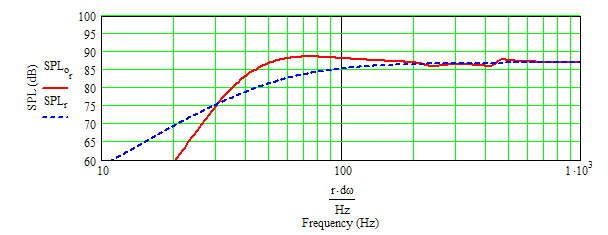

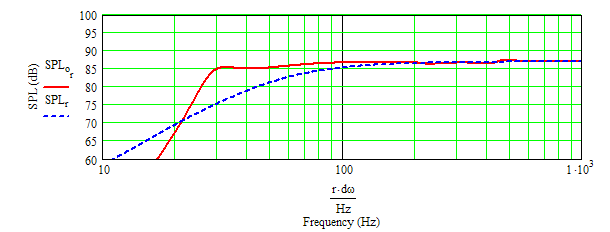

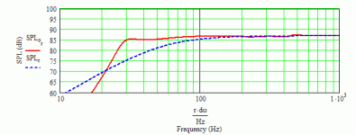

Assuming you don't want to use any more EQ than necessary, then to combat the rising HF above ~500 Hz, toe them in ~30 deg and fine tune the angle if required.
The sims assumes a 2pi space loading, i.e. buried flush in a large, flat field with the mic suspended overhead, so the drop below ~180 Hz is normally either dealt with by placing them up against a wall or near a corner; otherwise, a BSC filter is required:
http://www.quarter-wave.com/General/BSC_MathCad.pdf
http://www.quarter-wave.com/General/BSC_Variable.pdf
http://www.quarter-wave.com/General/BSC_Calculator.xls
Loudspeaker Diffraction Loss and Baffle Step Compensation Circuits

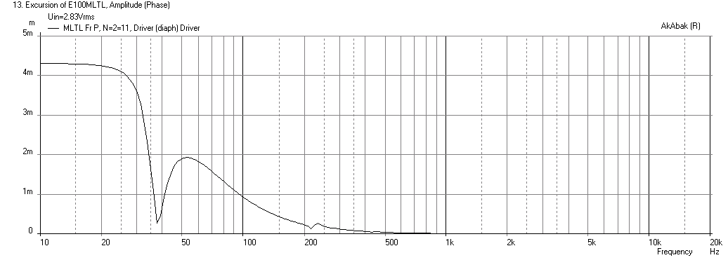

Hmm, did you mean the dashed blue line in the sim? If so, then odds are there’s an air leak, presumably due to the baffle just being clamped on, though even just air leaks around coarse machine screw threads has proven to be enough to negate much of a BR’s, and especially a TL variant’s, vent gain.

No, 2 mm probably isn’t even measurable at any reasonable resolution, much less audible.

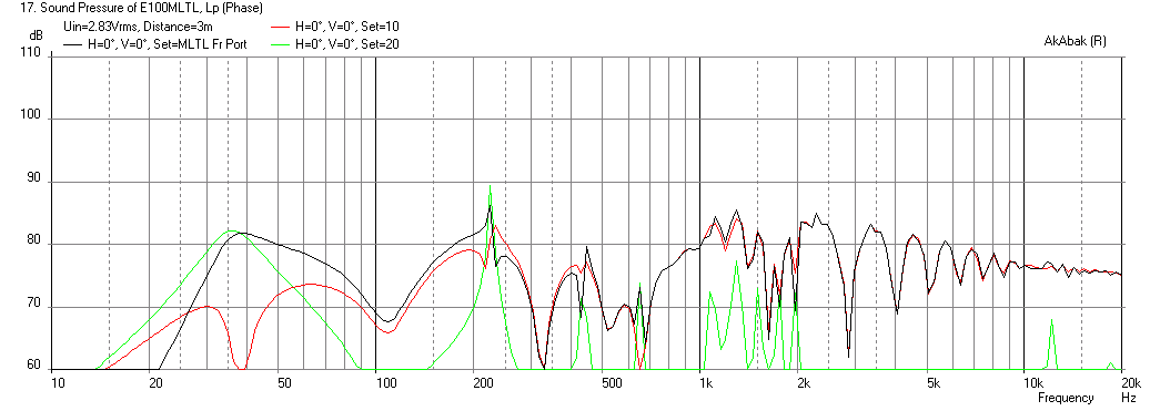

If you have a narrow-band notch between ~100Hz - 200Hz, that's likely to be floor-bounce (cancellation from the driver's reflected image on the floor)......
FWIW, historically, ‘floor bounce’ refers to the one that occurs between the speaker and listening position [LP], so it’s calculated using driver/floor and LP height over distance from the speaker; the one between the speaker/floor is just one of the speaker’s many eigenmodes.
In both cases, either the driver needs to be near/at the floor or up high enough to push its frequency low enough to get ‘lost’/blended in the room’s eigenmodes where our hearing acuity isn’t good enough to obviously notice it and if one can place it where’s some room gain to offset it, so much the better.
That, or tilt the baffle back > 6 degs to turn it into a smoothly decaying ‘echo’ with of course the loss of any floor 2pi gain as the trade-off.
