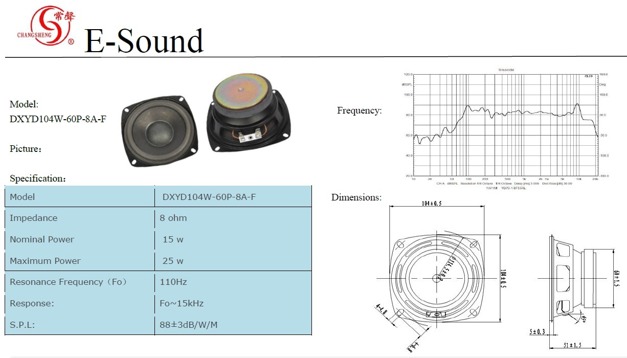

E-sound DXYD104W-60P-8A-F
https://www.duoxin.com/product/DXYD104W-60P-8A-LOUDSPEAKER.html

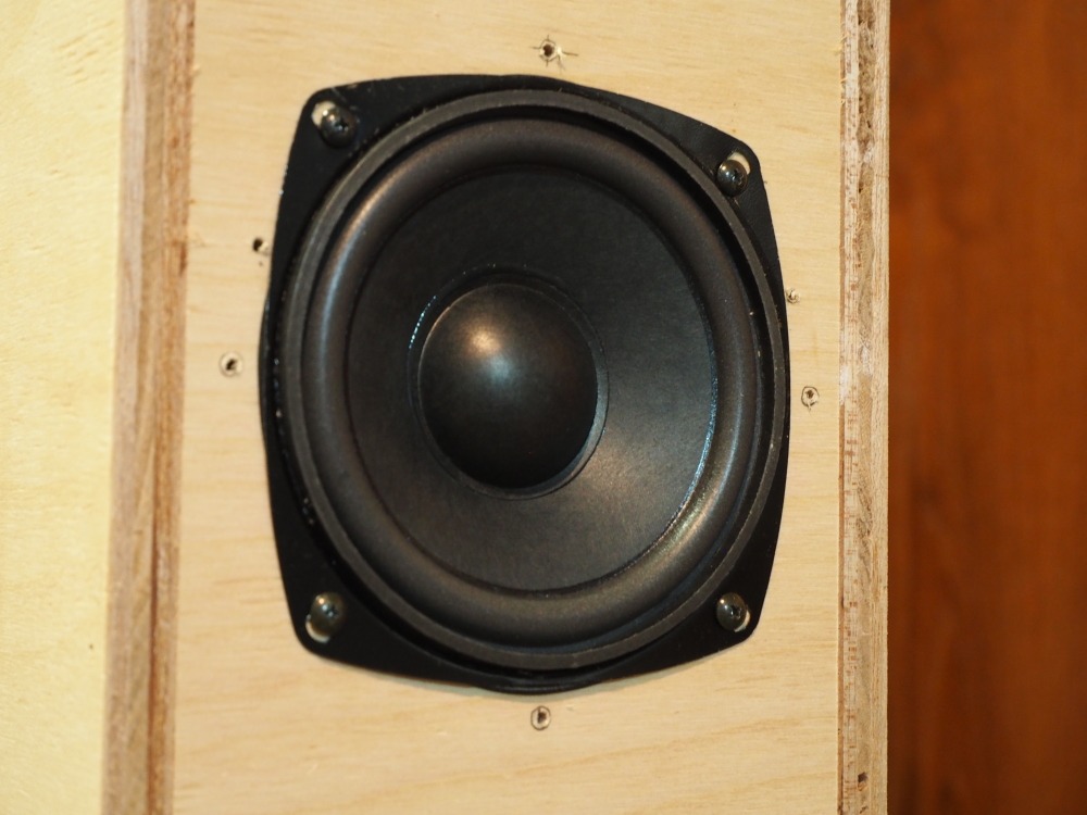

This is poor 4" full range, sold at Japanese shop for 350 yen(2.65 USD) each.
It has a thin press-frame, so it tends to squeak easily, but the sound quality is sufficient for your needs.

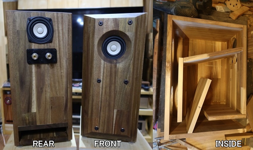

The simple 'beauty' of the Voigt Pipe's design allows basically any driver's specs same as a big sealed cab. 😉

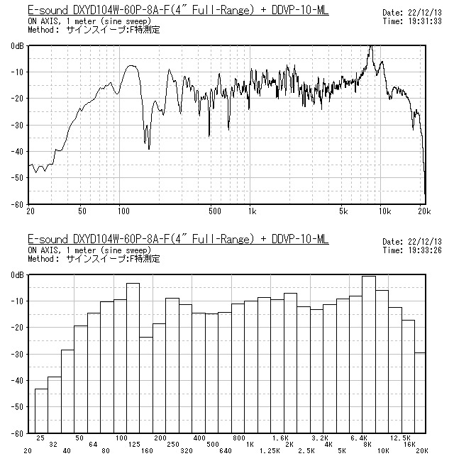

The sound told me it was almost like there was too much bass for such a small driver!! We got the answer now. 2 drivers. Thanks.
