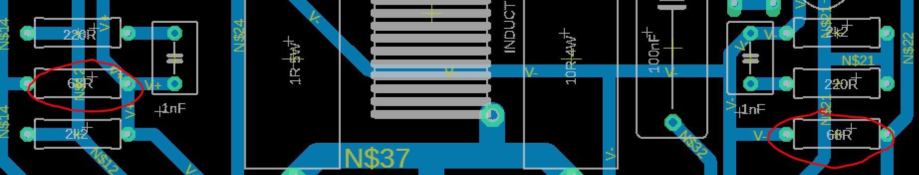

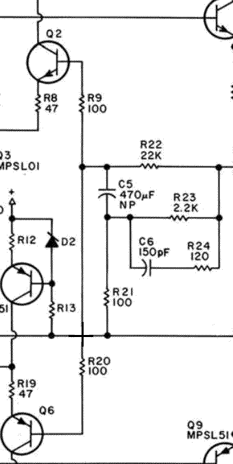

I have tried to build Borbely 60w lateral mosfet amplifier, but it seems that there is something wrong.
Can somebody help me to verify the pcb ?
When I connect it to the PSU , 68R resistors (marked on the picture) burns immediately.

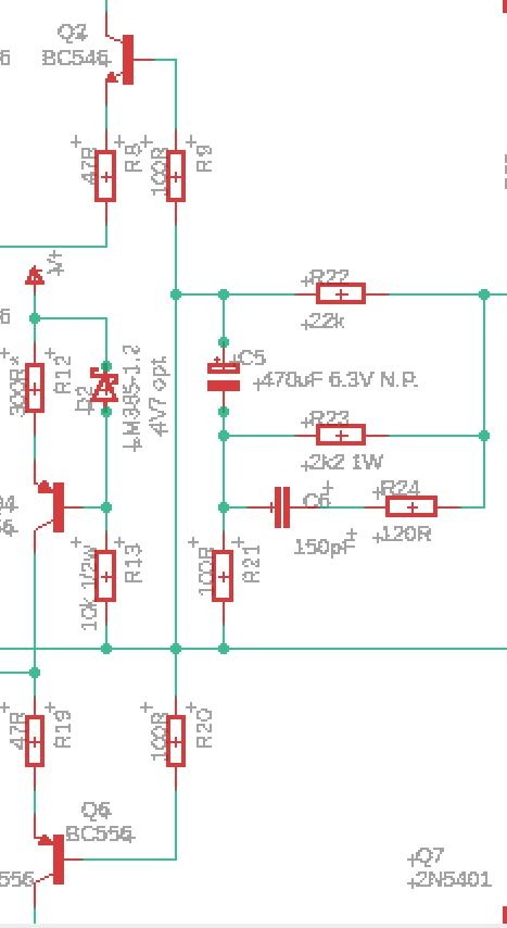

Check your schematic again against borbely's original. right away, i see you have errors in base connections of Q2, Q6 (with R9, R20).
Always a good idea to check continuity for PCBs before stuffing parts and check again after stuffing passives only (before adding semiconductors) to make sure resistances between nodes makes sense.

Hi Igor,
It's not clear from your post--- are you suspecting an error in the PCB layout? I haven't tried to verify artwork, but I imagine an assembly error is more likely to blame.
Foremost suggestion is to power the board from variable bench power supplies so that you can raise supply voltage very gradually and determine where the excessive current is flowing before the 68 Ohm resistors smoke.
My wild guess is damaging current flows through R6,Q8,Q11,Q10,R17.
Make sure P1 is preset to minimum resistance. (I would probably short Q11 collector to emitter initially until all other circuitry was debugged.) But I reiterate, use bench supplies to avoid frustration and heartache.

I just now saw mlloyd1 post.
He's right; I see a faulty connection in the schematic. There's an incorrect connection that shorts feedback (R22,C5) to circuit ground--- connection dot lies right between R13 and R21. This error is in the schematic. I haven't checked if it's present in layout. Even with this error, I'm not sure it would cause smoking 68R.
Hmm, thank you for your effort however I still not sure what is wrong .I just now saw mlloyd1 post.

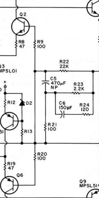

I have attached my and part from the original sch.
BSST is right, there's an error in the original schematic.
This is what it should look like.
yess it looks like the issue. Thank you all for your efforts . I will correct this, and check does it working .
