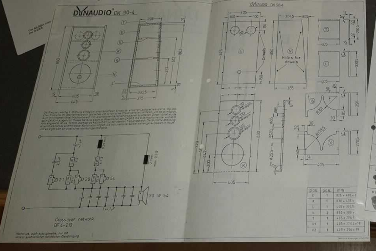

I have pairs of Dynaudio drivers 30W54, D54, D28, D21 and 4 Variovents. I decided to use drivers on DIY project. Does anyone has plans/scheme how to make housings and crossover for the DAK 4-210 kit or do you have a proposal for some other DIY project?

This dynaudio kit is not exactly the same by number as dak-4-210 (I can't see the difference), but the crossover df 4 210 is the same.

Aperiodic, thx a lot, but unfortunately photos are not clear enough to recognize values.

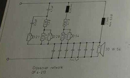

A single cap filter comprised of 2 caps in series as hp for D21.
A single cap filter and an Lpad for D28.
D54 unit hasn't got any hp filter section, a single inductor as lp and an Lpad.
2nd order filter for 30W54 ( appears 7x4,7uF in parallel). Must have been difficult finding a single 33uF.
This one would not fall under good quality crossover proposal.

It is a partial series-partial parallel crossover setup. The D54 has a highpass through the 33µF, the series coil on the 30W and the 30W itself. The scheme might be more clever than you thought.D54 unit hasn't got any hp filter section, a single inductor as lp and an Lpad.
