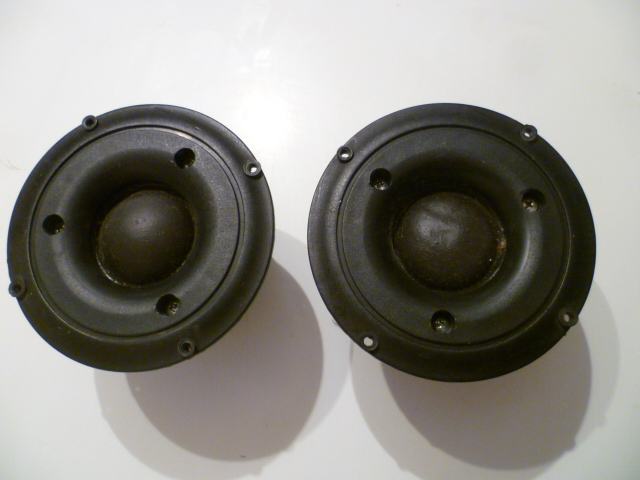

I have a pair of Dynaudio D54 Midrange Domes that I have measured using DAT3 Version 3 and it looks like the Parameters / Impedance are off.
I am assuming the ferrofluid is dried up and requires replacement or removal.
There are 3 screws holding the front horn / faceplate to the magnet assembly. There are "push-pin" covers that "hide" these securing screws.
Is there a way to remove these covers without damaging / destroying them?

I guess I can try that method..... these "plug" covers are wedged in there good btw...
I’d look for something that is meant to hold on car trim or similar.
A plastic rod with a smooth end will hold better than a wood dowel.
You can clean the plug and rod surface with some rubbing alcohol first to make sure it sticks well.
If it comes out, and is hard to get off the rod, I’d soak it in the alcohol or or a citrus based “goo” remover.

I opened my 4 (qty) Dynaudio D54 Mids tonight as I drilled a 1/32" hole in the screw cover and screwed in a small 1/32" eyehook and lifted the covers off. I do have 1/32" holes that I will fill in with a dab of black caulking to fill in the tiny hole.
Anyways I removed all the ferrofluid from these mids. There was a ton of ferrofluid and some was starting to dry up a bit based on the DATS V3 readings and "buzz & rub" failures.
So after all 4 were measured much more consistently with more realistic fs ( 340-425 Hz) with higher impedance peak (over 10ohms) at fs.
Learnings: No real mishaps while I was performing the 4 ferrofluid removals....
You will need to be careful as you separate the voice-coil/dome from the top of the magnet which has an adhesive to hold it in place. I used a putty knife and went slowly around the perimeter.
The 2 terminals and connections to the voice-coil leads are fairly fragile as you will have to scrape the foam /solder termination from the top of the magnet to enable the dome to be removed.
I guess you could de-solder the termination on top of the foam terminal base but I had full success without damaging the voice-coil leads.
