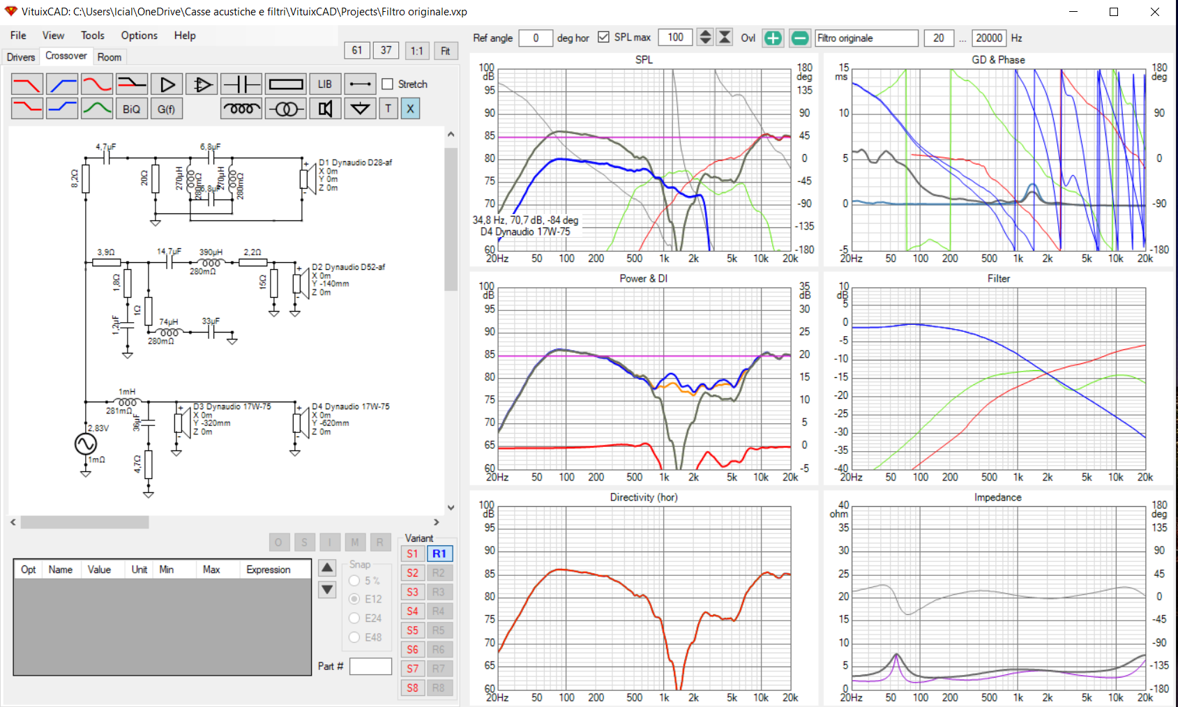

I have 2 Dynaudio Contour 2 loudspeakers and I simulated their crossover with VituixCad software (very well done, congratulations!). I don't understand why if I connect the 3 speakers with the same phase (as all theories say for a 1st order filter) a deep depression at 1400hz is highlighted !!! If I invert the polarity of the mid-range the response improves! See attached diagram.

Your filters are not electrical first order. You have series and parallel elements in your crossover, therefore the reason to invert the driver polarity to maintain phase relationship.

Driver measurements are not taken according instructions so not much hope for improvement.
Electrically 1st order XO produces usually 2nd order acoustical slopes due to natural acoustical slopes of drivers so mid should be inverted in practice.

Is this truly Dynaudio Contour 2 original x/o schematic?
Inductor dcr values are probably a default software setting.
