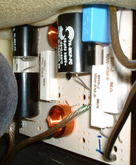

My guess would a loose connection somewhere either in the xover or the connection to the tweeter. You probably have to open up and take a look at the xover.

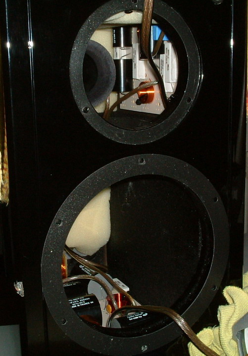

Can you get the crossover out? You really need to check for a cracked solder joint, on the other side of the board.

It could be the tweeter or the crossover. Can you run it with the crossover accessible? If so, wait till it cuts out then tap the crossover and see if it comes back on. Try gently pushing on parts in the crossover and see if the tweeter goes on and off.
Another quick one is to try the tweeter of the second box then you are at least sure if it is the tweeter or the crossover.

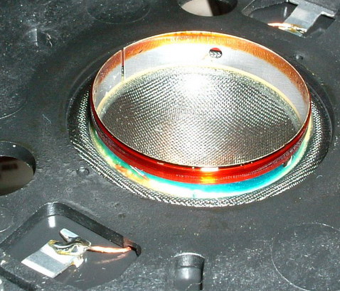

Could you open the tweeter and check for possible loose connection. Hope it's something as simple as that. Maybe a crack solder joint?
Dynaudio usa says it's $275 to replace it.
I don't see anything cracked/loose on the voice coil plate.
Could it be a voice coil gone out of spec?!
And could that explain the fact that it works when cranking up the volume?

It is possible for a skilled tech to repair voice coil failures such as that one, often the fine wire breaks before it starts wrapping around the former and can be resoldered. I've seen it done successfully before. Maybe find out if there is a speaker repairer near you and ask if it is something they can fix. The main thing is to treat that dissasembled tweeter very carefully, they are easily damaged.
