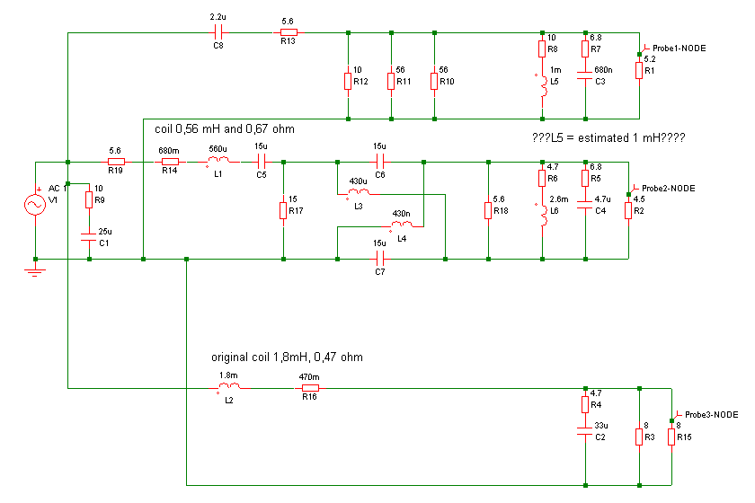

Hello Radek,
I own a Dynaudio Confidence 5 old version, 1995, with a 82 dB sensitivity.
I got my filterinfo by this site and with a little backengineering.
http://www.diyzone.net/print.php?sid=721
At the end of this article there is the crossover filter.
R6 is the M560
R12 is the T330
R8 is the combination of the 20W100 and the 17w75.
When I opened my speaker I found more or less the same values.
I will try to find my filter back, its somewhere in my Pspice models.
A few resistors are different if I'm right
Give me a day to find out.
Rob
I will second that comment on true first orders being more complex than a true 4th order. I decided to try and design a true first order filter that would offer linear minimal phase shifts (the main reason dynaudio and others often use these filters), and its very difficult. Often you are using very unconventional topologies. In fact, when I was done, I believe my basic 2 driver 2-way design had near 20 components in it.
Thank you very much Rob for posting that c5 xover schematic.
I'm still fairly new to xovers and I'm wondering if someone can explain whats going on in the midrange section, is it still 6db/octave and what is the c6,c7,L3 and L4 section for.
Also is r9/c1 the impedance linearization section for the whole xover (in addition to the separate impedance linearization for each driver)?
