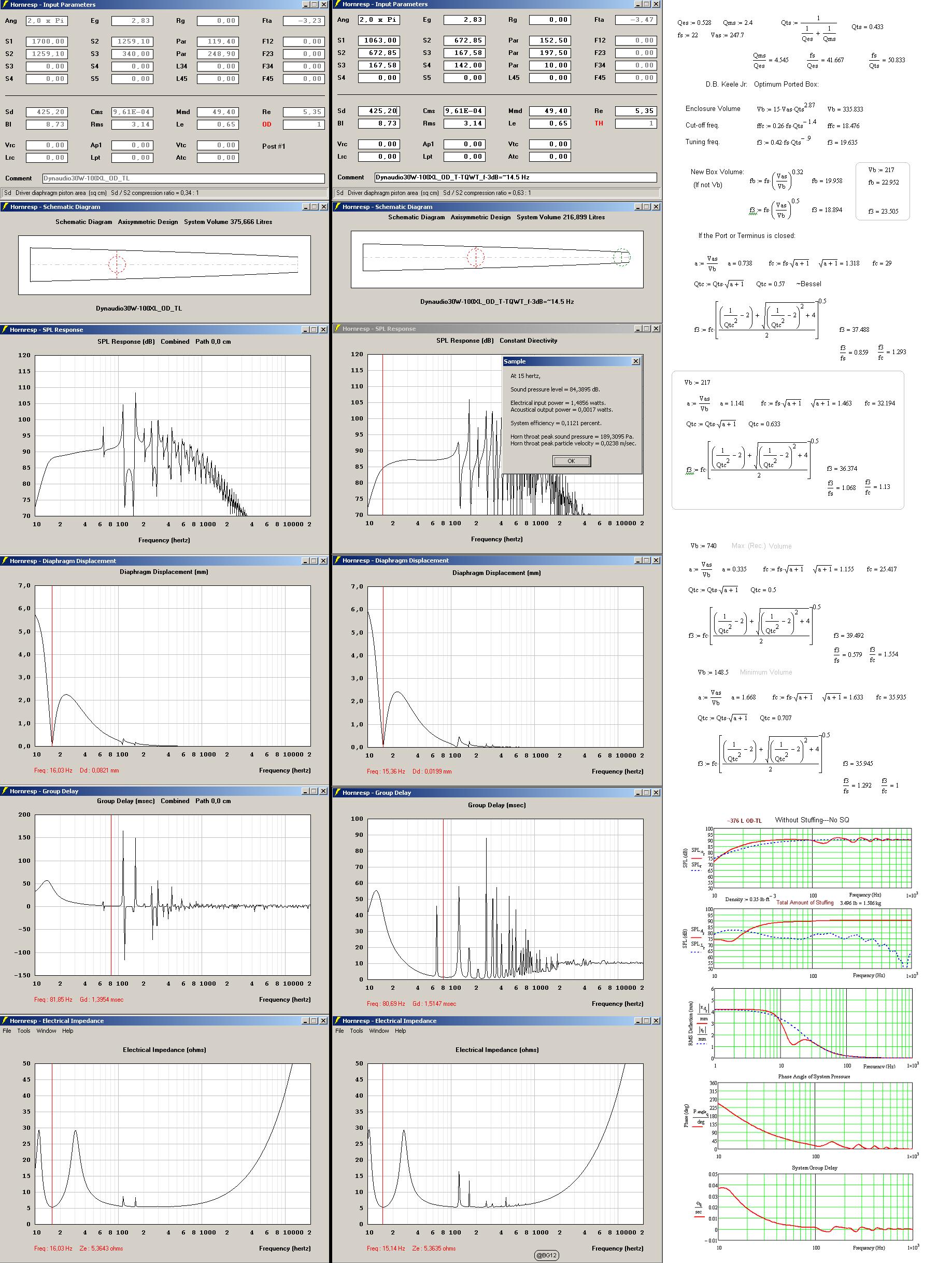

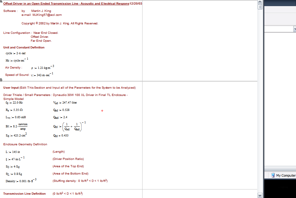

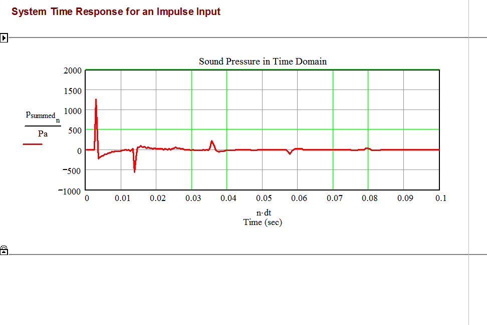

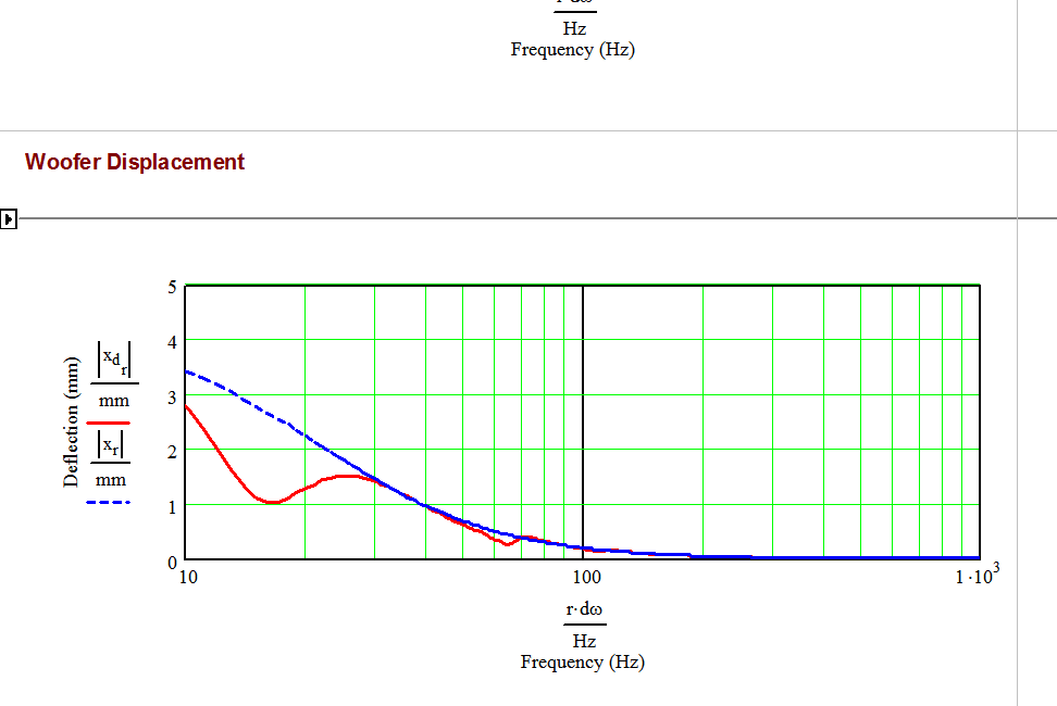

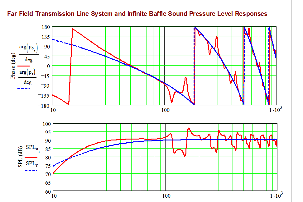

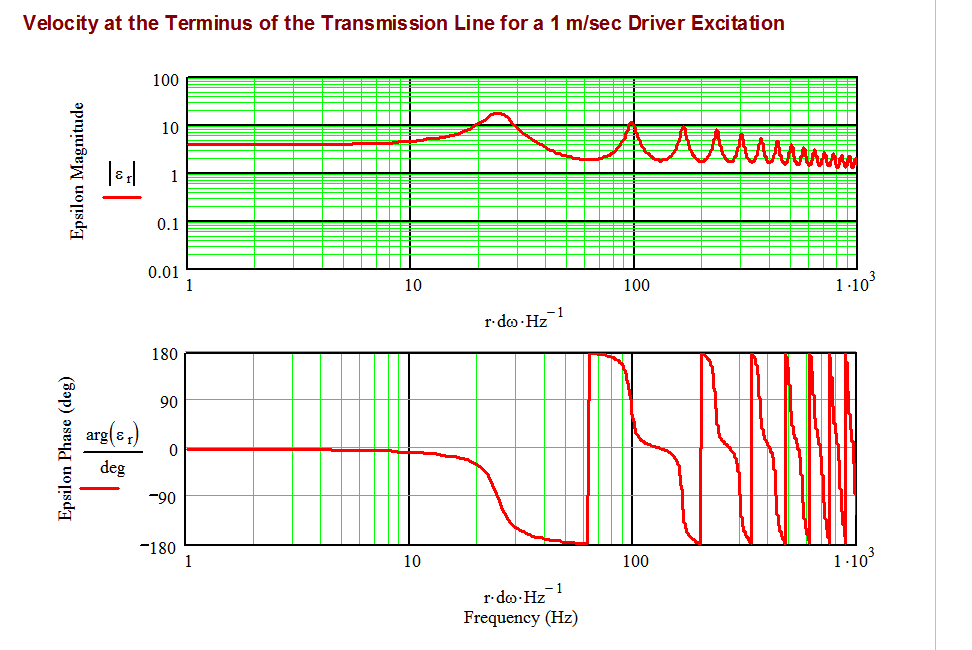

I have a single Dynaudio 30 W100 12" woofer that I'd like to use in a transmission line-type subwoofer. After playing around with the TL design software I've come up with this design. According to the simulation, it has a quite smooth response even without acoustic stuffing and a -6 dB point of approximately 20 Hz.
I'd be glad to receive some opinions and comments about this design.

Upon closer examination of the line geometry the inner volume of the enclosure would be closer to 350 liters, which is way beyond my size constraints. It seems like I would have to go with a sealed enclosure type with ~120..150 liters (if I'm to use this driver).

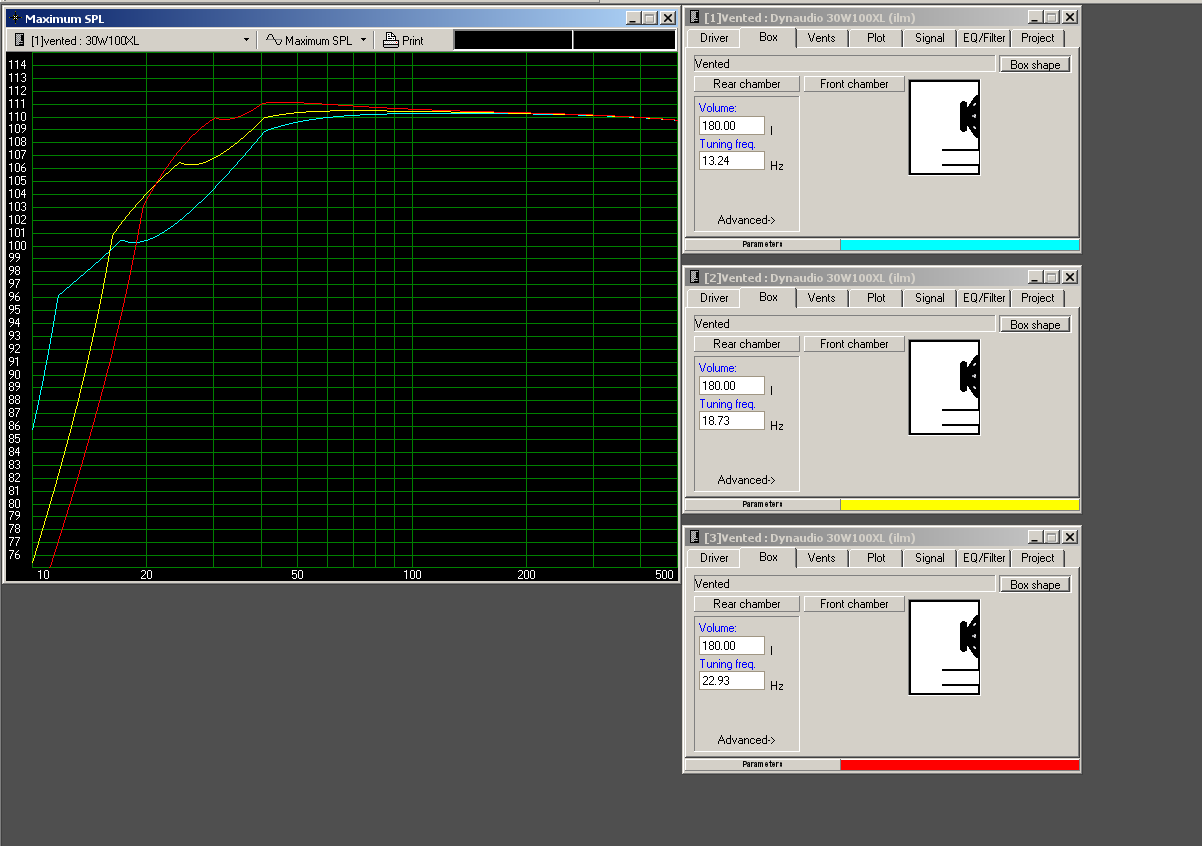

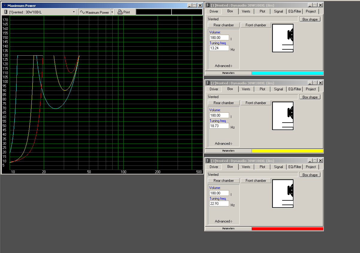

Does your simulation show that it would be possible to attain an f-3 dB of 15 Hz using this driver in some kind of a special enclosure (OD-T-TQWT)?
I also simulated this driver in an ordinary ported enclosure by varying the tuning frequency. The yellow tuning produces a rounded response curve, but nothing like an f-3 dB of 15 Hz. 😀

..Does your simulation show that it would be possible to attain an f-3 dB of 15 Hz using this driver in some kind of a special enclosure (OD-T-TQWT)?

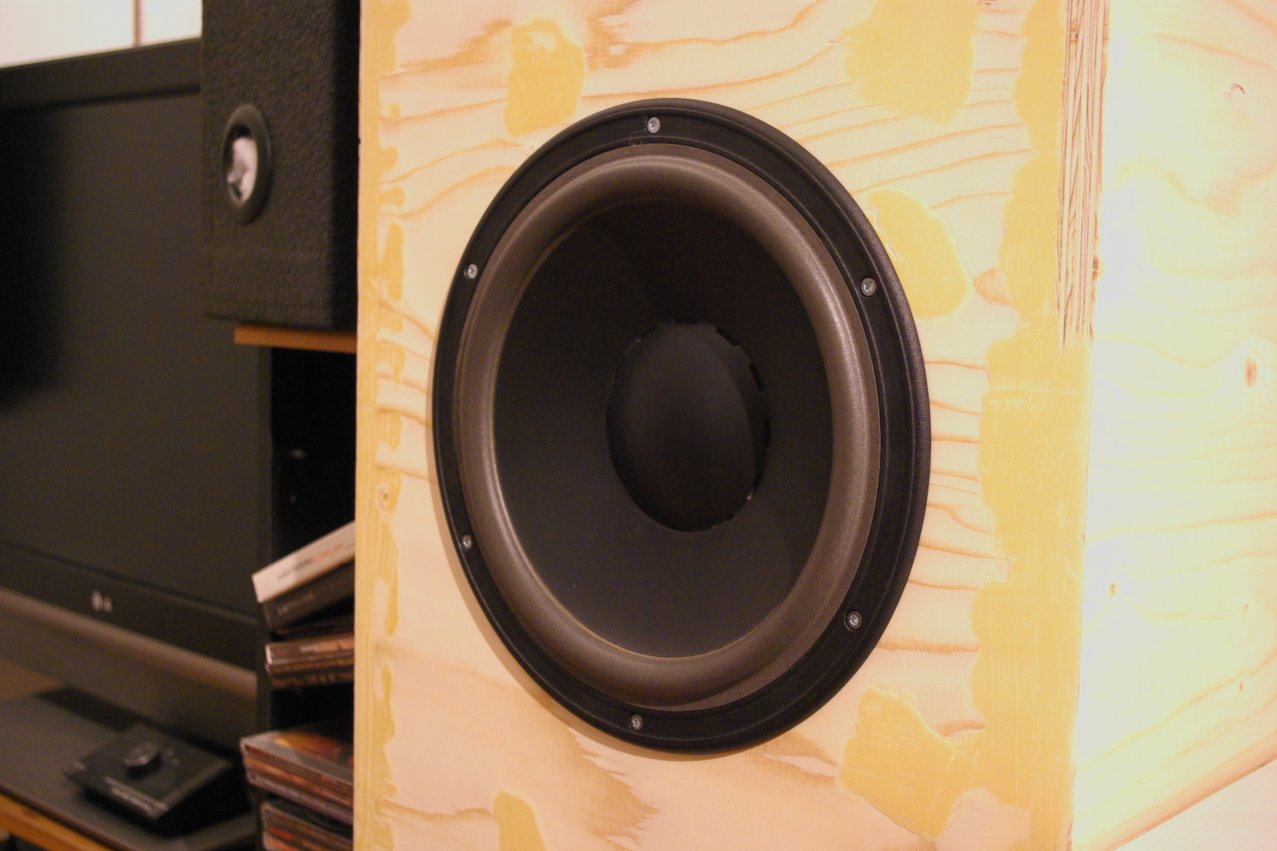

I glued a couple of support triangles into the enclosure and made a cutout for the driver.
It still needs a few more triangles and attachment of the side panel... So far it's looking good.

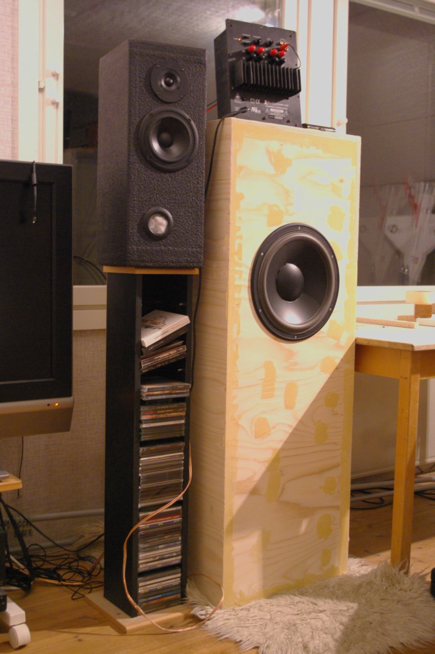

I have recently been testing a sealed prototype of this sub.
The sub integrates nicely with the main speakers after stuffing their ports tightly with cotton wadding. I get the best sound when I set the plate amp's crossover frequency to 40 Hz and volume to around 40 %. With these settings I find its sound very good indeed, at least with music material. Its output is definitely more impressive than the compact 10" subwoofer which I finished building during last summer.
With the port opening closed by a piece of MDF and no enclosure stuffing I measured a resonance peak at 35 Hz. I don't have any way to measure the frequency response, but after testing with some test tracks it seems to extend at least down to 25 Hz. According to the simulation based on the location of the impedance peak, the total Q should be around 0,68..0,70.
The crossover is still a bit high for me and I'm planning to change some components in the filter section to attain a slightly lower adjustment range. Maybe something like 30-100 Hz instead of current 40-160 Hz. I've already modified the filter to get rid of the in-built peaking (+6 dB/40 Hz) second order high-pass filter.
I still need to decide which plate amplifier should I be using with this sub. Currently the enclosure has a slight leak in one of the bottom corners, so I would need to cut a hole anyway to be able to reach all the corners for applying wood glue.
