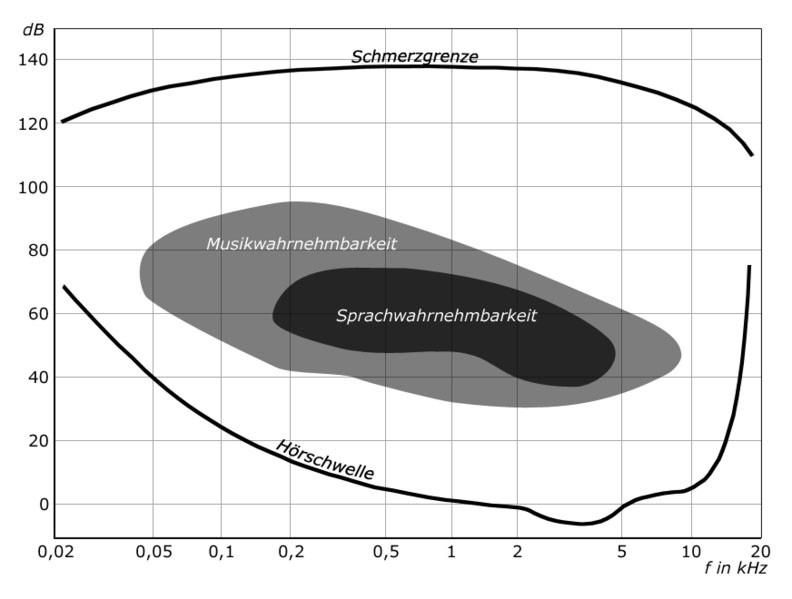

The grey area is the music listening area which has a dynamic range of 65dB.
Even if this graph is not correct and the area is larger lets say 80dB, 16 bit imho is enough.
Did you ever hear the quantisation noise of the DAC ?
