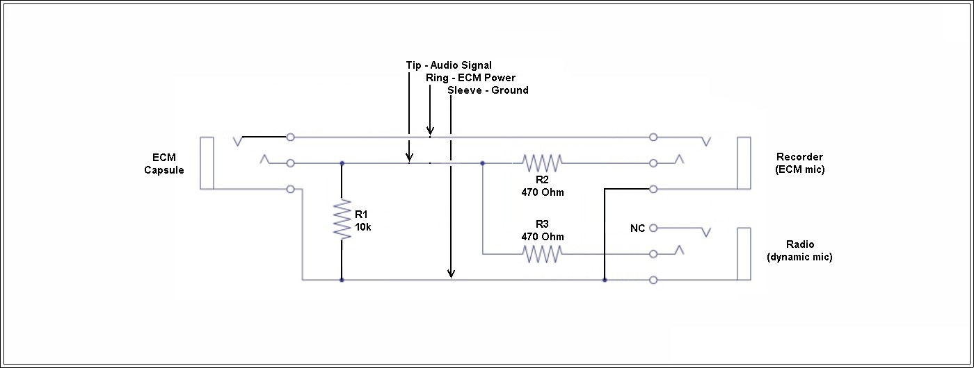

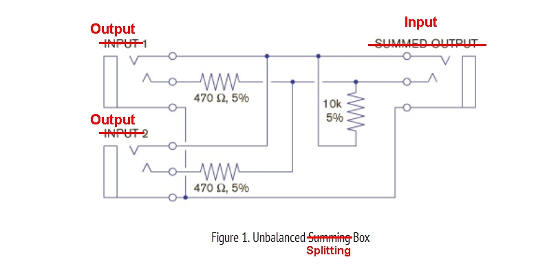

Pretty much just guessing, I wonder if something vaguely like the below might work for you. It's from Why Not Wye?
