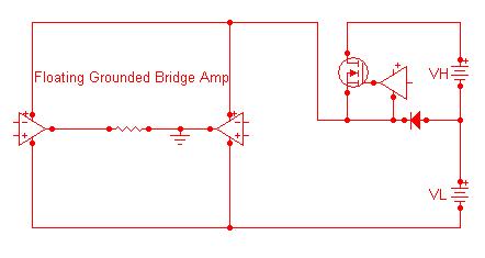

djk: thank you for the post - that is a very good pic showing the concept
I still have a question:
Maybe I'm just not "seeing" it, but for the class A amplifier, why is it only +/- 27V? Wouldn't this cause clipping if the other side of the bridge is driving the speaker at, say, +50V?
I can see how the right side is a rail switching amplifier --> Does this mean that the +/- 27V, +/- 55V, and +/- 80V rails are sharing a common "floating" ground?
The Crown VZ5000 and vz3600 use the saturated switch, National Semiconductor was issued a patent on the linear modulated method.
Using a PWM top rail modulated by the audio is the basis of the old Sunfire subwoofer amp (and the BASH amps too).
Sandman proposed a bridge amp scheme circa 1971 that has a small high quality amp (A2) controling a larger quick-and-dirty one (A1).
The first commercial version of the asymetric bridge amp I saw was the old Yamaha B2X, the class A side ran on ±6V, the class AB side on ±63V.
The thumbnail drawing I posted of the asymetric class A design was from BSS, a pro sound amplifier.

One question that I have failed to ask, and I think it would help in understanding the grounded bridge concept:
I am assuming that, in most grounded bridge amplifiers, the amp still resembles a basic "three stage" conventional amplifier (input differential pair, VAS, and then the grounded bridge output stage).
==> What supply voltages are needed in the first and second stages? For instance, if a grounded bridge amp has a maximum voltage supply of 75V on its output devices (floating, so the load could either be +75V or -75V maximum), then does this mean that the input stage and VAS stage should be powered from a conventional +/- 75V supply to prevent clipping?
The VAS on the high side runs off the floating supply. The low side doesn't need a VAS, the output of an op amp on +/-15 (referenced to the ground it's driving) is all that's needed - just like a QSC amp.
==> Sandman proposed a bridge amp scheme circa 1971 that has a small high quality amp (A2) controlling a larger quick-and-dirty one (A1).
Yes, I *think* that this was the beginning of the SMALA amp (switch-mode amplifier linearly assisted), where the class-D amplifier (high efficiency, not so great distortion) supplies the majority of the current, and the "linear assistance" class A (or AB) amplifier provides the small correction current to smooth out the distortion. These currents add before reaching the load, and theoretically, the result is a high efficiency, better linearity amp. Correct me if I am wrong in my assertion here.
The low side can have fairly high distortion because it drives the "ground" which is the same as the input ground. Distortion products become a common-mode signal, and in effect, show up on the floating supply. If the high side amp has good PSRR, it rejects it. Some of Crown's amps have a "dirtier" low side amp (especially the bias circuit which won't track as well over temp as what they use on the high side).
