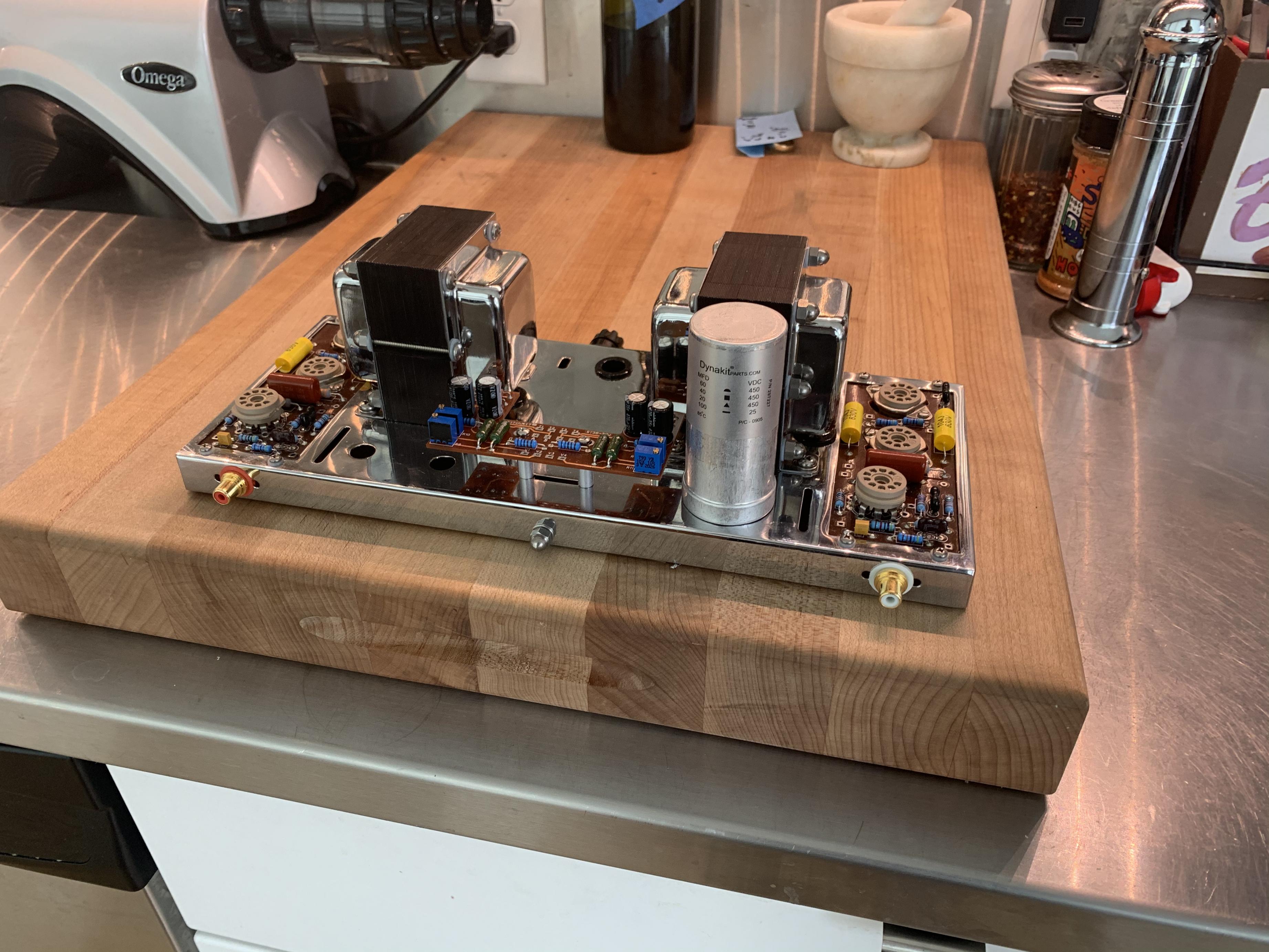

It's certainly doable if you want to.
The filaments need a total of 3.6ADC. The HV supply needs about 280mADC at 370VDC.
Notice that the original circuit floats the filament supply at +13.5VDC.
Have you considered changing to separate, fixed bias operation?
You'd need a new negative bias supply for that.
The standard circuit uses (and needs) a matched quad for the outputs.
At the least, it would be easy to convert to two matched pairs of output tubes,
instead of a matched quad, by using a separate cathode bias resistor/capacitor per channel.
Would like to us Mercury Magnetics DYNA-PA60-P transformer. I have an adjustable bias circuit in the amp. 6.5V filament with center tap is what is supplied with the OEM Transformer and HV is 330v with center tap 660 rail to rail. I want to split filament supplies one left one right DC and over kill on filtering.
Scott Pike
Can you get a data sheet for that transformer?
Linear supply, or a SMPS for the filaments?
For a linear filament regulator, you'd only need much C at the input.
The output would have 1000uF or less, depending on the part.
