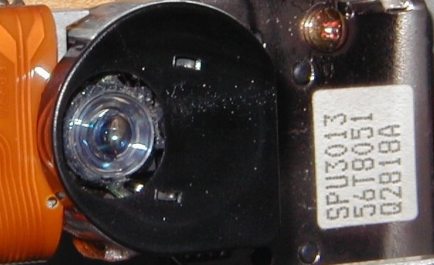

even adjusting the the apc only lasts so long i would just do a search and replace the laser. or take the laser to a shop and get the tech to find one
you can see in the pic there a lot of dust in the laser
Hi Karma,
Thanks for the reply. The pic was taken before my cleaning - maybe it's time again (although it never got as good as new). I used a cotton stick (those you also clean ears with), but no liquids.
Can I do more or use something better? Also, I think I'll check if the assembly moves freely or if it needs cleaning/lubricating. Any suggestions on lubricants?
Jennice
Jennice
