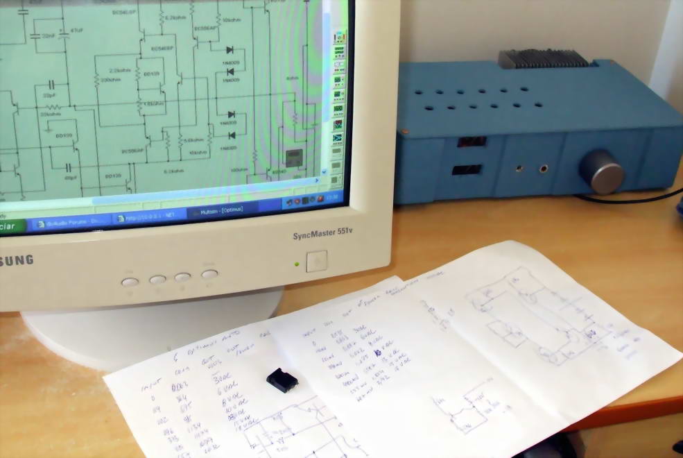

Dx Optimus is beeing prepared... dinamic bias.. Class A to AB
having more watts into class A.... bias is controled dinamically receiving audio from output and controlling the VBE multiplier resistance (voltage drop).

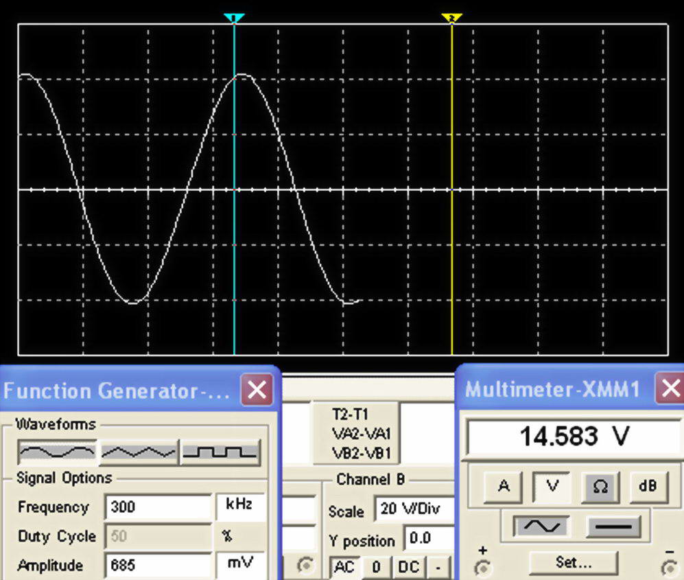

I am just starting...it is working into simulator and i have to study to decide the stand by current and to adjust the decreasing.... say... to decide what power will return to AB mode.
Well.... it is just a simulating monster...working...but cannot guarantee quality before construct.
Next days i will be studying using simulator and calculator machine...and hate that part...and they the good work will start.
I will publish IF, result good.... It will be something that remembers Dx Standard and the HRII..... around 50 watts into 8 ohms.

Well... square wave is not music...if was i would be very happy
But i am satisfied...waveshapes from 1 hertz to 30 kilohertz are very good.... slew rate seems very good into 20 kilohertz.
It is turning good.... slowly will be better.

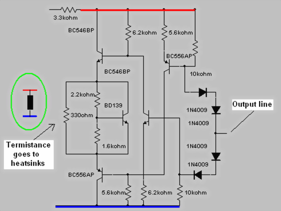

Well..... how the circuit works:
First the circuit has a normal VBE multiplier circuit to adjust bias, can have a trimpot and so on... this one has a NTC.... a resistance that is reduced when receive heat... into the position it is assembled....it will reduce the resultant resistance into the BD139 circuit... the main bias control, the manually adjustable one.
Other transistors are receiving audio rectified...so.. they receive DC that changes their operational point.... when iddle you adjust current to .... let's say....hummmm...600 miliamperes... and when you increase the audio output volume... power increasing, then you will have DC enougth to drive the transistors that will reduce resistance from colector to emitter.... this reduced resistance will reduce bias...so...having audio level...bias is reduced.. this way you will go to Class AB operation.
Boys... circuit is not mine...i can adjust it, tweak it, make mine modifications, decide other currents, decide different thresholds ..but it is from JVC...i am just using it as a non profit amplifier, opened to the public, a genuine DIY amplifier, using the technology we have in our world, offered into the internet, opened wide world to everybody.
So... the qualities or defects of this circuit is not my responsability and also does not represents i am a great designer.... i have not made this one...my value is as a tweaker.. the one work hard and burn fingers...i have not created this one.

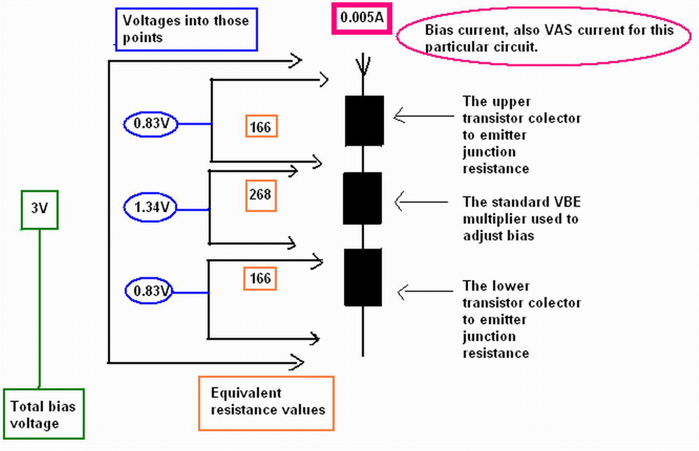

Bias circuit behaves alike a resistance...you have the main current to be used into
The VAS colector to emitter junction.... this current is adjusted by the bias circuit... even a single resistance can do this job for you.
This VAS colector to emiter current will be modulated, will variate and will be sent to drivers and output transistors.
So... the bias circuit, transistorized or not, is the one provides current to the VAS.
But also, and more interesting, it adjust a DC potential into it's extremes...when current crosses this resistance it develops voltage... and this voltage use to be 2.4 volts into my kind of outplut circuit..the one i use (not discovered by me .... of course).
Into my output circuit... a very used one... Doctor Self use and a lot of folks use this one..emitter follower...or darlington output.... well..you need to set 0.6 volts to each transistor (around that..from 500 to 640 into AB amplifiers.... and more into Class A amplifiers... and lower into class B amplifiers..those one uses almost nothing as bias).
As each upper output line transistors (NPN) are two...then you need 1.2 volts (0.6 plus 0.6).... and the lower transistors (PNP) also will need 1.2 volts (0.6 plus 0.6)... this means 2.4 volts must be developed into this bias circuit..the bias resistance...it behaves alike a resistance...the obligation is to develop 2.4 volts and into the decided current needed to the VAS to drive the output circuit.
Why 2.4 volts and not positive 1.2 Volts and negative 1.2 Volts.
That idea of positive and negative depends your reference..if your reference is zero volts (output line...you have there milivolts, almost nothing)..then you split those 2.4 into two parts..and the polarity will be given because the base to emitter junctions connected to the output line that will create the 0.6 plus 0.6 zener effect because of semiconductors junction.
If our reference was 1 positive volt..then you gonna have positive 0.2 and negative 2.2 volts... all depends the reference..nothing born negative or positive....there are not red positive electrons and blue negative ones...they are all negative into the atom
All the work is this one.... this "resistance" can be something that reduces it's resistance when receiving heat from the heatsinks.... and this will be usefull to control the amplifier...if not... the transistors turns hot and current increases.... when the current increases it turns more and more hot.... this make the transistor internal resistance to reduce and the current increases even more...this goes this way till the destruction....so...if the bias can reduce its resistance (reducing bias), will protect the amplifier.
This is very easy... dedicated not to Engineers or advanced guys.. this is for beginners only...to help you my dear Mr. Incognitus.
No one explains nothing... they think everybody has born already knowing everything... this is not truth... there are a lot of folks, alike me, that need some informations to evolute.
regards,
Carlos
To the ones interested...as 300 hit seems a good interest into 2 days
Will explain the equivalent circuit attached.
This is the equivalent circuit.... made with resistances.
You can use resistances... they will make the job...not the dinamic job, but they will fix your current into 600 miliamperes (around that), and will feed each transistor with 750 milivolts (if they share the same ammount..normally they do not share the same ammount)
regards,
Carlos
regards,
Carlos
Carlos,
as hinted, I am extremely suspicious about that kind of trickery, usually doing more damage than good. Those Engineers are told to invent things by Sales Directors, Compliance Officers and other Functionaries but freelancers like we take no orders.
