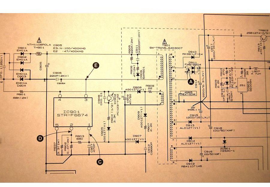

I'm interested in replacing the diodes in the analog power supply with FRED-types, and the critical caps with superior types (BG).
For instance, Underwood lists the following in their Level-1 mod:
Which parts in the schematic(attached) are the likely candidates?
Several posts here mention replacing the caps and diodes PRIOR to the Switching Power Supply, but wouldn't replacing the diodes and caps AFTER the SMPS make more of an audible difference?

Thanks, Dan, for the insights into your Marantz mod-
Anybody else out thare modded (specifically Denon) their DVD/SACD Player's SMPS?
I did mod my Denon 2900 extensively (including PS mods) about four years ago or so. I am still a happy user of the player.
I did the mods in stages. Starting from the SMPS diode bridge and Caps and the IEC Inlet and the mains supply cable and the Mains fuse. Eventually ended up building an offboard PSU for the analog stage completley bypassing the SMPS for the analog output stage. I still recall that the first diode and caps mod on the SMPS had a profound impact on the lower frequencies and in the imaging , soundstaging dept.

Which diodes and caps did you use on the SMPS? Just guessing I would think that something like the MUR860s would be a good choice for the diodes and a Blackgate WKZ or the Jensen four pole for the main cap.
Dan
Mouser part number: 583-1N4946-B. 1 amp/600 volt ,Fast/Soft recovery diode with axial leads.
Mouser part number: 583-FR205P-B: 2A/600 Volt, fast recovery diode, axial leads.
are two options for you for the diodes.
I used FR205.
Since I live in a 230V country so cap options were limited for me 🙁 If you can get hold of a Blackgate at that voltage rating and a decent price I think it would do nicely.
I used a Nippon Chemi Cap with double capacitance value of the original eventually.

Amit,
In the first schematic above, please specify
http://www.diyaudio.com/forums/attachment.php?postid=1361350&stamp=1196154733
which part numbers shown did you change?
Thanks in advance for being specific.

My guess would be start with D901-D904, and C905. I have the same basic components in my Marantz SMPS.
Although I used the ALWSR I would look at NewClassD's UWB regulator for your IC906 and IC908.
Also, how about some blackgates for C934,C937 and C943-44?

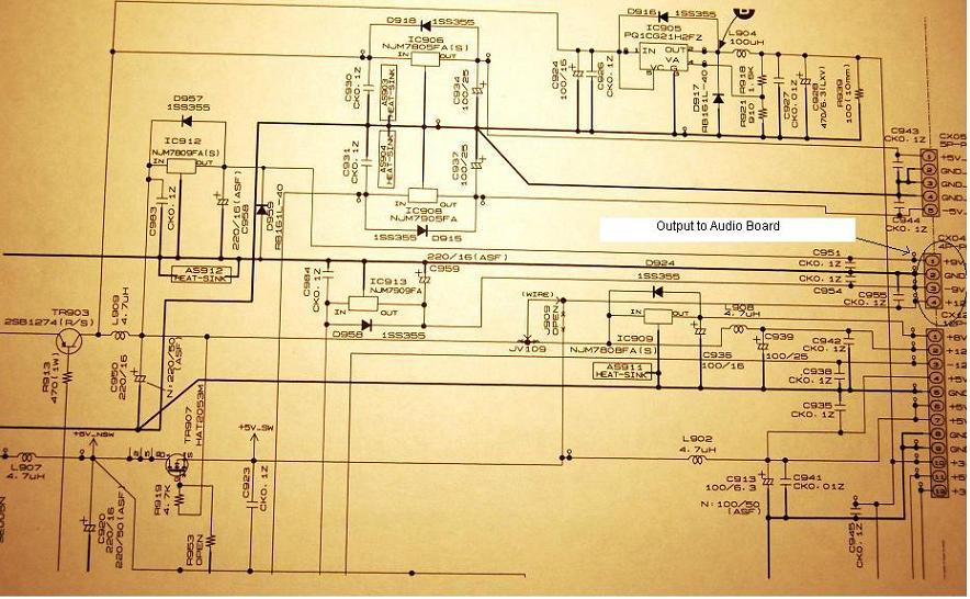

Originally posted by dantwomey
"Although I used the ALWSR I would look at NewClassD's UWB regulator for your IC906 and IC908"
IC's 906 and 908 appear to be primarily for the video circuitry, while the audio board is powered primarily from IC 912(7809) and also IC 913(7909).
Also, the UWB regulator's rated for max 400mA- max 600mA if a heat sink is employed.
Technical Specs:Maximum Current DX78xx: 630mA;Maximum Current DX79xx: 400mA.
Anyone think this could deliver enough currrent for the 20-odd IC's on the D/A and analog audio board that follows-especially that positive regulator which also supplies current to the 5v and 3.3v regulators for the DAC?
Perhaps the ALWSR could deliver sufficient current for this app, but could it be directly substituted for the 7809/7909 in this circuit where the input voltage is only approx 12vdc? And how would it be mounted/connected?
