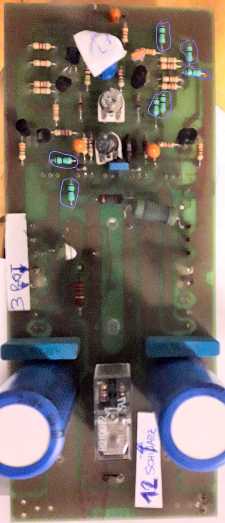

Hi
Found a Duson PA-75 damaged by lightning I think. As I am a newbie I don´t know these parts marked in the photo attached. If anyone could tell me I could try my luck. Thx.
mike
What you really need is a circuit diagram. Your image is to blurry to make out, however they do all 'look' the same from what I can make out.
Have you tried measuring them ? Do they all read very low resistance or do they all read open circuit ? They could be either low value resistors or small encapsulated inductors.
I can see other obvious damage on that PCB.

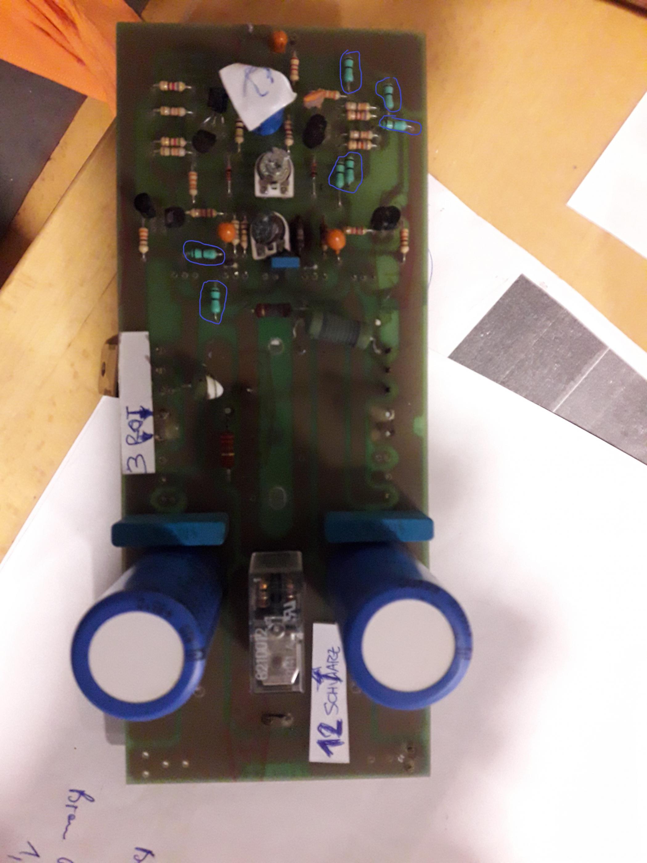

The white paper under the board fools the camera and makes the board dark. The underexposure makes the image noisy. I do not think there is enough light for your camera.
Here's an artificially enhanced image, but it is still "blurry".
I have a guess that the mystery parts are "ZeroOhm" jumpers. If so, they are not likely to be your problem. But it is odd to see so many ZeroOhms on such a simple build.
