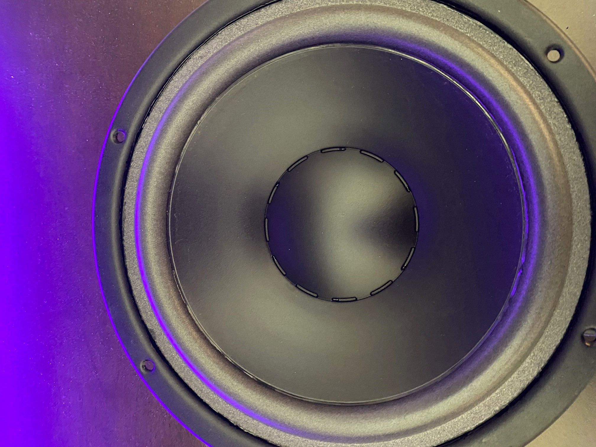

Yes, the dustcap and cone are actually one piece! There are tiny holes where the cone and cap meet which are used to center the coil by the use of pieces of steel wire. When the glue is set the wires are pulled and the tiny holes are sealed. It is therefore not that easy to center those drivers properly.

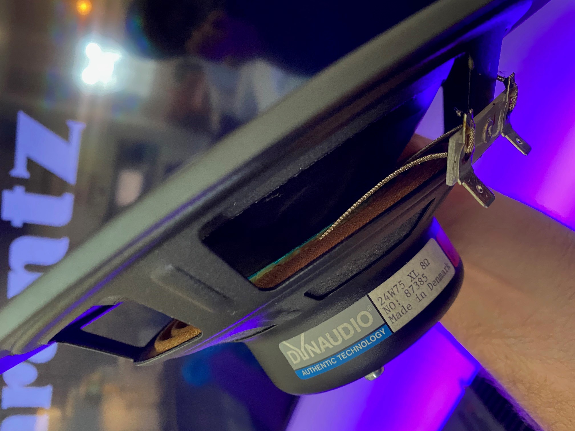

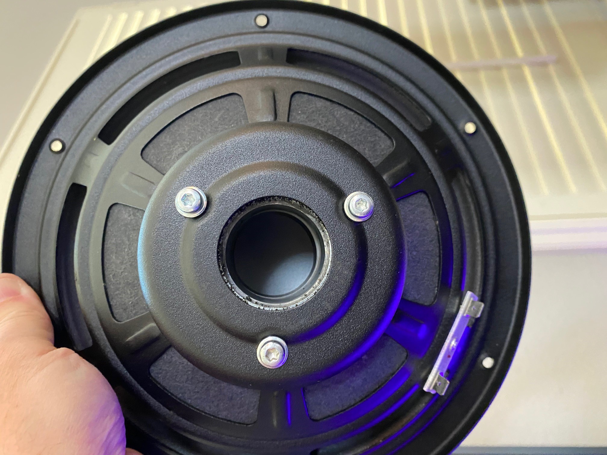

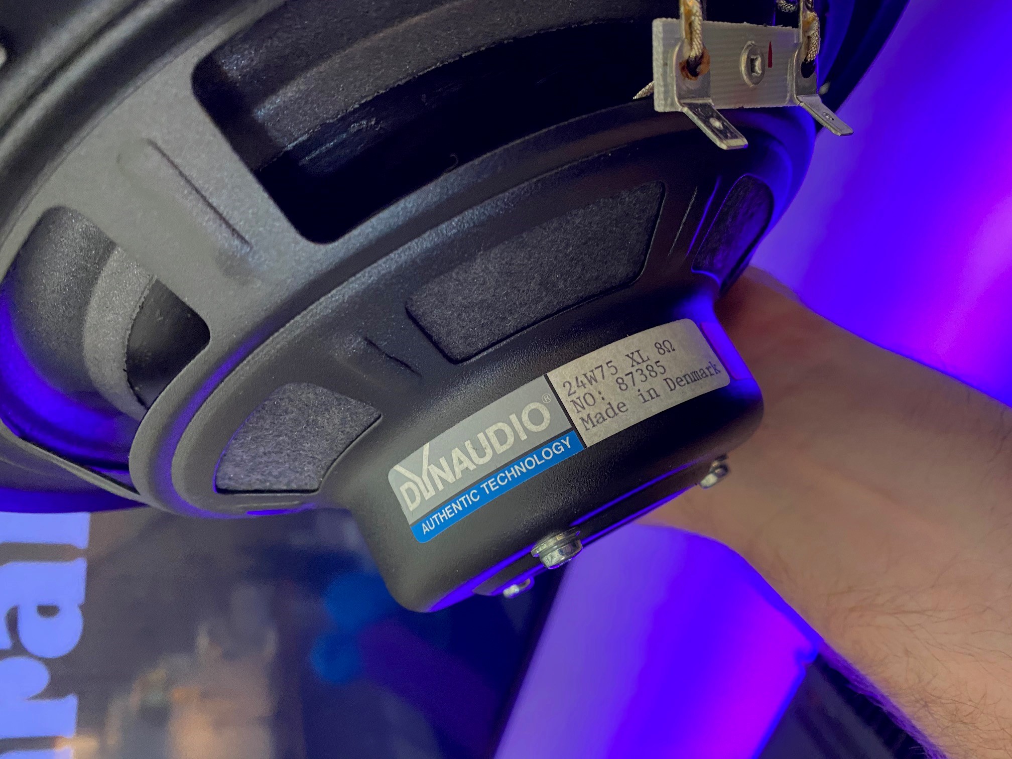

Here are some pics of the woofer. It's the 24W75 XL 8ohm. No: 87385
Here's what Millersound said about it.. Not totally sure I understand what this email is saying but you guys might understand it more:
"Dust cap is non-removable. Easy to tell the problem:
Rear air filter gummed-up from remnants of the rear air filter. Gap must be cleaned and a non-rotting filter must be installed. Must be taken completely disassembled,
including (of course) the spider suspension. Refoamed again too.
This was absolutely not a “pro” job, but they didn’t make a cosmetic mess, and therefor I’d make an exception and service it. Cost with return UPS/insured is $137.00
Payment is only by check or m/o to Millersound, in carton, along with copy of this email. Include clearly-indicated return-shipping address.
Your problem all makes sense now!"
