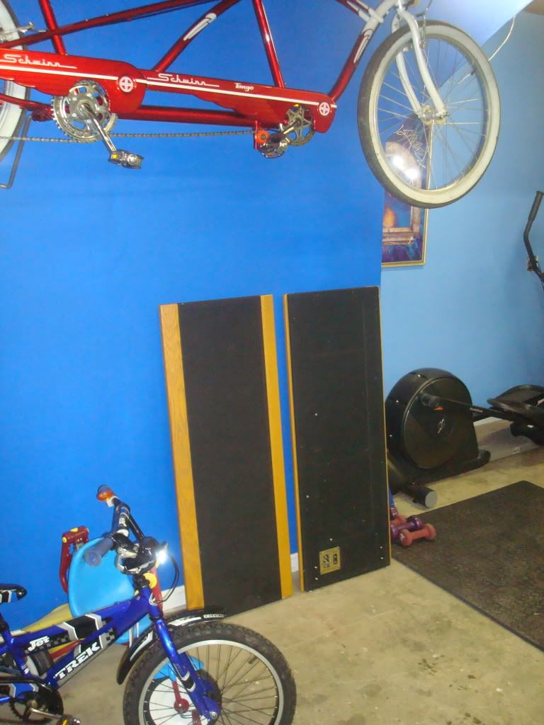

Best thing to do is remove the socks , so You can get a idea of what condition they are in. Once You have the condition of these figured out , then You could discern which way You want to approach the repairs .
Depending on what model they are , and considering You have nothing invested at this point , these might make a Great DIY Project . . . Hard Wood Frames . . . upgraded crossovers . . . time and expense . . . can be minimal if You can do the work Yourself . . . Good Luck and Have Fun ;-)

I'll take some before and after sock removal pics and get them up sometime this week. I ran them last night, and they sound like one might expect. One was completely shot, and the other only sounded bad at volume. But it sure sounded bad!
We'll see how the mylar is. Hope I didn't make it worse by playing them.

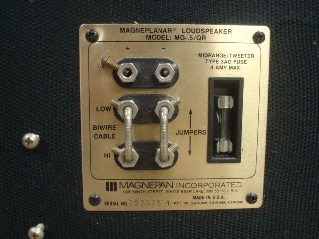

Checking the chart over at Mug , the MG-0.5 were built in 1991 , if you call Magnepan ( 1-800-474-1646 Monday to Friday from 8 AM to 4PM CT ) and give them the serial numbers of the plates, they will be able to tell You when they were built.
I'm not sure how the side oak wood pieces come off ( most likely screws holding them in place ) , but once the oak pieces are off, at the bottom of the speaker there will be a multitude of staples that need to be removed , once removed, you can unscrew the screws that hold the plates in place , and roll the sock up the speaker on both sides, thus exposing the driver , which at that time You be able to examine the driver more closely . . . They look Great for Dumpster Find !!!

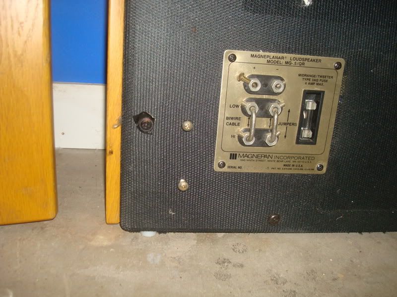

Stephen-- how cautious do I have to be with the plate-- are the wires from the inputs extra fragile...? Concerned about damaging the connection with the wires when I pull the thing apart...
Standalone , You should be OK , just remove the four screws holding the plate , and when You go to roll the sock up , the material will stretch enough so that You will be able to push the plate thru the sock ,that way , the plate and wires will remain attached to the speaker .
Also Standalone , don't forget to remove the screws that hold the legs to the speakers ( those gold colored screws to the left of the plate in your photo ).
Good Luck , Cheers , Stephen

Great find. I would have check the speaker binding posts for a possible short before hooking up to an amp. If the mylar is torn, you gonna have to sink some cash into fixing them, otherwise, if mylar is good, just a simple rewire. I have done at least eight rewires and its not that bad. I use a tiny bit of DAP Weldwood to glue to the mylar and the will never de-laminate again. Forget Miloxane. The tweeter wire can be found at rat shack (36 gauge copper magnet wire)
