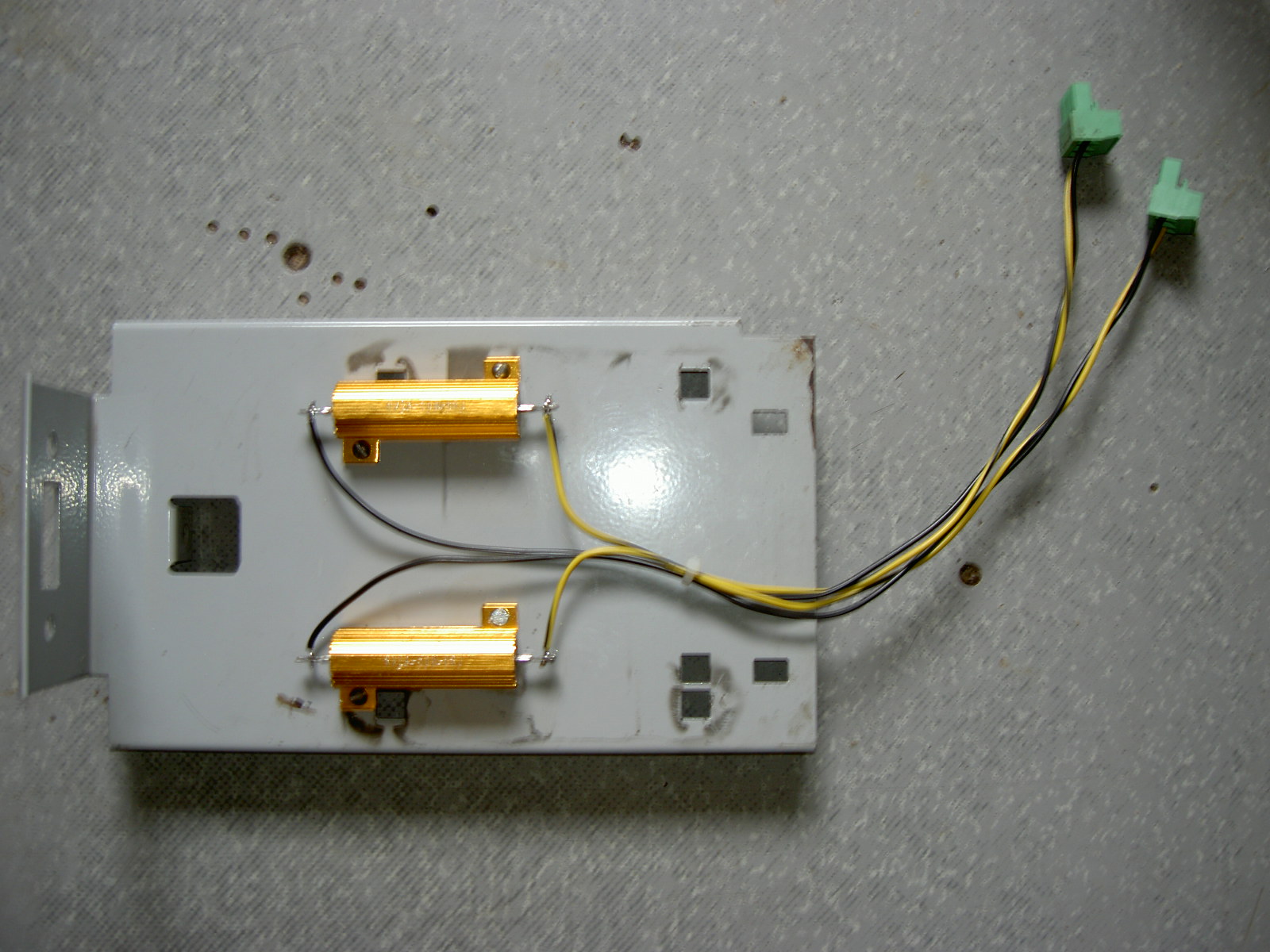

I have some 25ohm 100w resistor on hand, will parallel it to 8.3ohm 300w dummy load.

The non-inductive type is similar in price to others, and is potentially useful as an amp test load.
Some tube amps could be damaged if operated with a load impedance much different from the rated.
The ones you have will be fine, though. Bear in mind that the resistor's rated power only applies
if they are mounted on a heat sink.

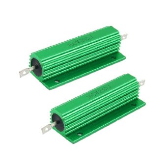

Non iductive power esistors? Use these fixed on a heatsink and at half the mentioned power.
MP9100-1.00-1% | Caddock MP9100 Series TO-247 Radial Power Film Resistor 1Ω 1% 100W -20 → +80ppm/C | Caddock
AP101 2R F 300PPM | Arcol AP101 Series TO-247 Axial High Power Resistor 2Ω 1% 100W 300ppm/C | Arcol
These are available in values ranging from 1 Ohm to ...
Max power 100W but read the spec sheet and apply no more then 50W.
I use them on my dummy load (up to 800Watts) on computer processor heatsinks with a temp controlled ventilator.

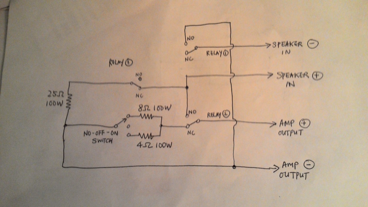

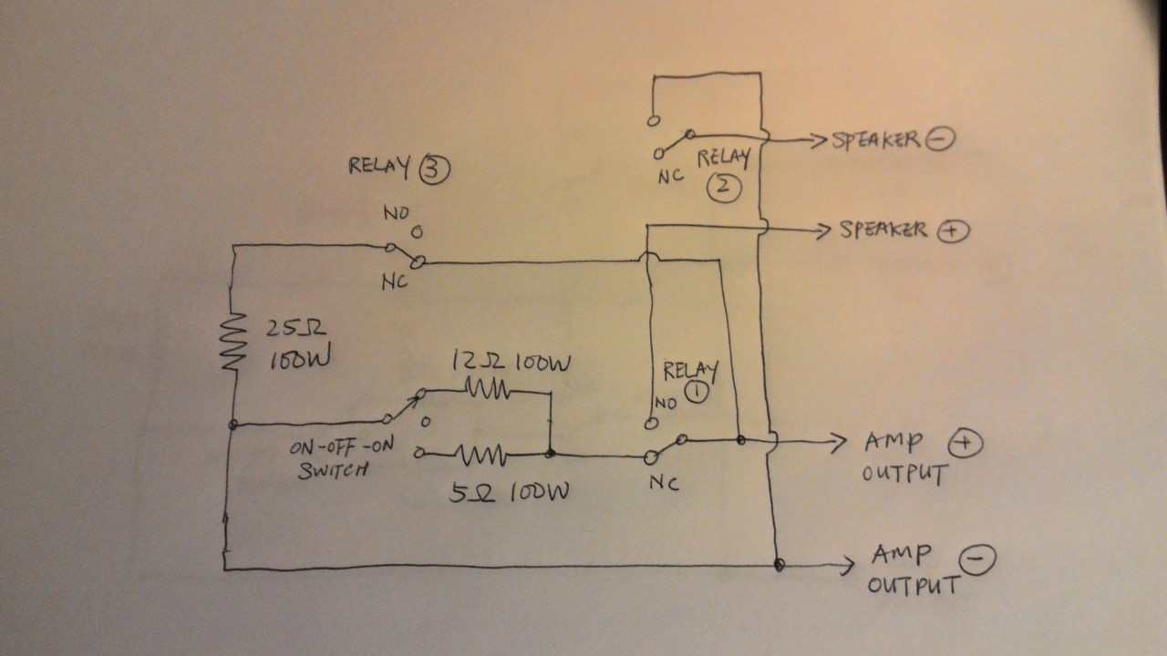

Sorry I didn't make it clear, the 25 ohm resistor is " kind of " permanent.
When the selector at "off" position, 25ohm resistor parallel with the 12 ohm or 5 ohm resistor to form a load close to 8 or 4 ohm load on the amplifier terminals.
When the selector at the position between "off" and "A", relay 1 and 2 connect amplifier to speaker while the 25 ohm resistor still in the circuit.
When the selector turn to "A" position, relay 3 will turn on and disconnect the 25 ohm resistor from the circuit.
Relay 1 and 2 are 40/60A SPDT automotive relays, four needed per channel. I also added a MY4Z Omron relay parallel to the contacts.
