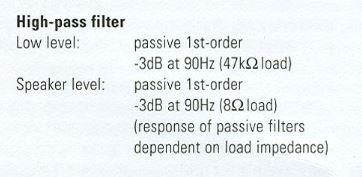

You don't supply the make and model of your subwoofer but you seem to have connected it the most problematic way possible. Before taking it to bits and invalidating your warranty, did you read the manual and the specifications? The splice halved your input and resistance. Many high-level sub inputs are not a direct pass-through. e.g. from my sub manual.
Are you sure the sub doesn't expect a line level signal rather than a copy of the full speaker signal?
That's a difference of between 20 and 30 times right there.
