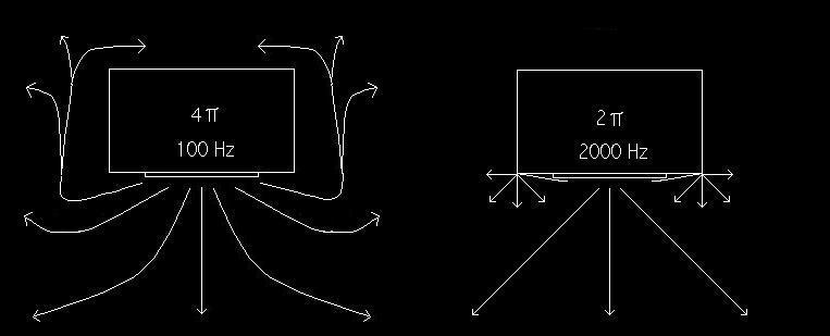

Baffle step correction is not to correct for leakage out of the back of the speaker, but because the wavelengths at high frequencies become small compared to the baffle and therefore louder in the forward direction. This is what is referred to as the 4pi (full space 360 degrees), to 2pi (half space 180 degrees) transition. The driver and baffle begin to "beam" to the front like a flashlight at high frequencies, when wavelengths are small and fully supported by the baffle.
Small wavelengths relative to the baffle cannot wrap around and radiate in all directions. Conversely, at low frequencies the wavelengths become much longer and larger than the baffle, so they lose the support of the baffle and begin to wrap around the speaker, eventually becoming omnidirectional at very low frequencies. A 50hz wavelength is 270 inches long, 500hz is 27 inches and 5000hz is 2.7 inches. A driver will become directional and start to beam when it's width is around 1/3 of the wavelength it's producing.
Baffle step correction boosts the low frequencies so they are as loud as the high frequencies supported by the baffle and radiating in the forward direction. It's a gradual transition from omnidirectional at low frequencies to straight ahead at high frequencies in the case of a speaker in a box.

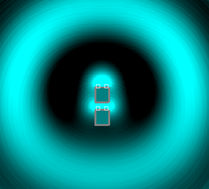

More about quasi cardioid pattern of dipole sub in u shaped damped enclosure
http://musicanddesign.speakerdesign.net/NaO-II-U-frame.html
Yeah, what I said. The bass goes to the back of the cabinet same as the front. 4 pi space includes the back of the cabinet. People love their jargon, can't live without it. .Baffle step correction is not to correct for leakage out of the back of the speaker, but because the wavelengths at high frequencies become small compared to the baffle and therefore louder in the forward direction. This is what is referred to as the 4pi (full space 360 degrees), to 2pi (half space 180 degrees) transition. Small wavelengths relative to the baffle cannot wrap around and radiate in all directions.

The cardioid bass trick is currently popular in PA work, and it is effective at keeping bass energy off the stage. Three subs in a line on behind the other with proper spacing and delay does it. It can be done with two, but three works much better.

For dipoles or cardioids, its still basically the above, but with added phase summations that either reinforce or cancel radiation in particular directions.

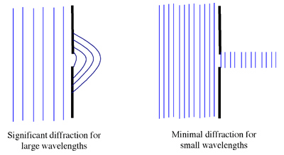

Yes, the associated physics is that of "diffraction".
Long wavelengths (bass frequencies) bend or "diffract" round loudspeaker enclosures more than short wavelengths (high frequencies).
Thanks all, this is very helpful and I think I am beginning to appreciate the impact of diffraction at low frequencies. Maybe one way to think about it is the entire cabinet effectively begins to look like a spherical point source compared to wavelengths of 10-20+ feet. In which case, the wave isn't going to be bouncing off of the outside of the cabinet at all.
