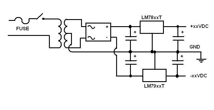

I have a 6206B Hewlett-Packard power supply, but although it sports 3 outputs (+, -, and GND), there is no tension between one of the terminal and the ground one. I read that this is a "floating ground" power supply.
In short, I would like to have a dual power supply, like a one I could use to build test circuits requiring a positive and negative rails and a ground, like ones used for op amps.
Do you think it is possible to have such a power supply using my 6206B one? If not, could you advise me on one I could buy and use to test small signal circuit? It could even be a DIY project, if you have any pointer to one.

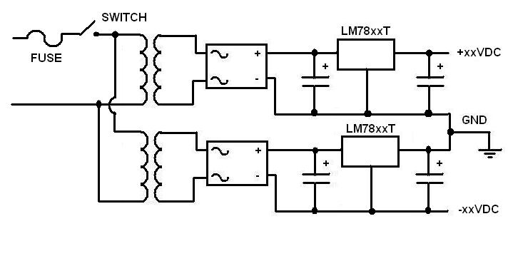

Small circuit tester...I would say to build it.
There are ways to create an artificial centre tap to create a split supply but there is always questions of stability and noise. (at least from some)
Either of these two ccts will work...you can get fancier circuits if you wanted variable or tracking or current limited supplies.
