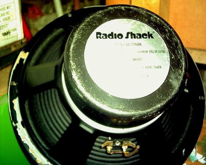

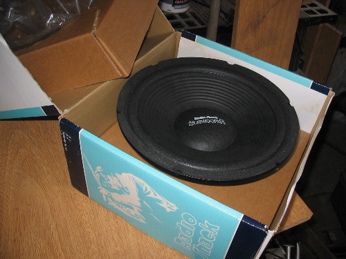

Got a pair of RS 40-1350A.........On closeout (RS no longer makes drivers").
Was going to make a Push pull for decreased V But my R...not Z was too low (3.2 Ohms per coil) so I used one in a Ten cubic foot by one inch MDF.
I was getting 5/8 " excursions...way low.
So happens I got one "unused" in the box.....just waiting for me to get the itch.
