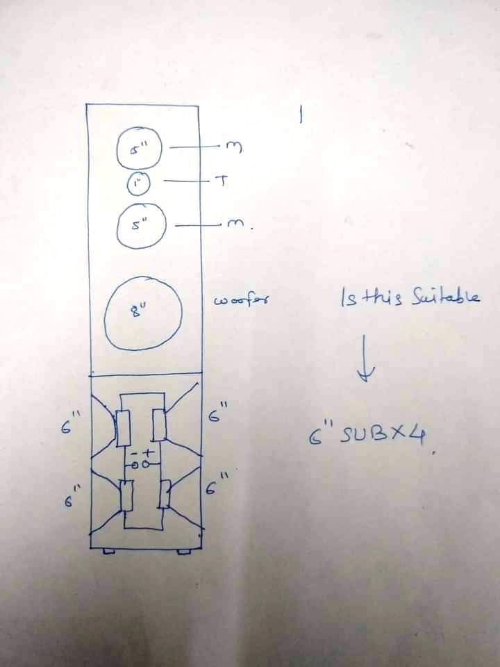

I plan to design 3 Way Tower Speaker with Side firing (Both Side) Subwoofers !
is it feaseble ?
Connecting Both side subwoofer (6" X 4)in Bipole Configuration is work best?

I spent time with AR-9s (dual 12s per speaker) and now I have some resto-modded AR-90 (dual 10s per speaker)…the kick on both of these outshine most anything produced even today. 6” seem like a waste, consider side fire, magnet coupled push-push 10”, I think this might be the sweet spot
I think over it but now I have 8 no of 8 ohm 6" sub for size and impedance matching series and parallel total 8 ohm
Fair enough. I often do projects with what I have on hand rather than what I could use. Mount them as close to the floor as possible to get the most out of the Allison Effect., basically making them radiate into half space for some small increase in LF efficiency.
Please post a design and build thread as there's a lot of expertise available here, and many just like to watch other people's projects.
I'm finally going to build my C21 version of the AR9 next year.

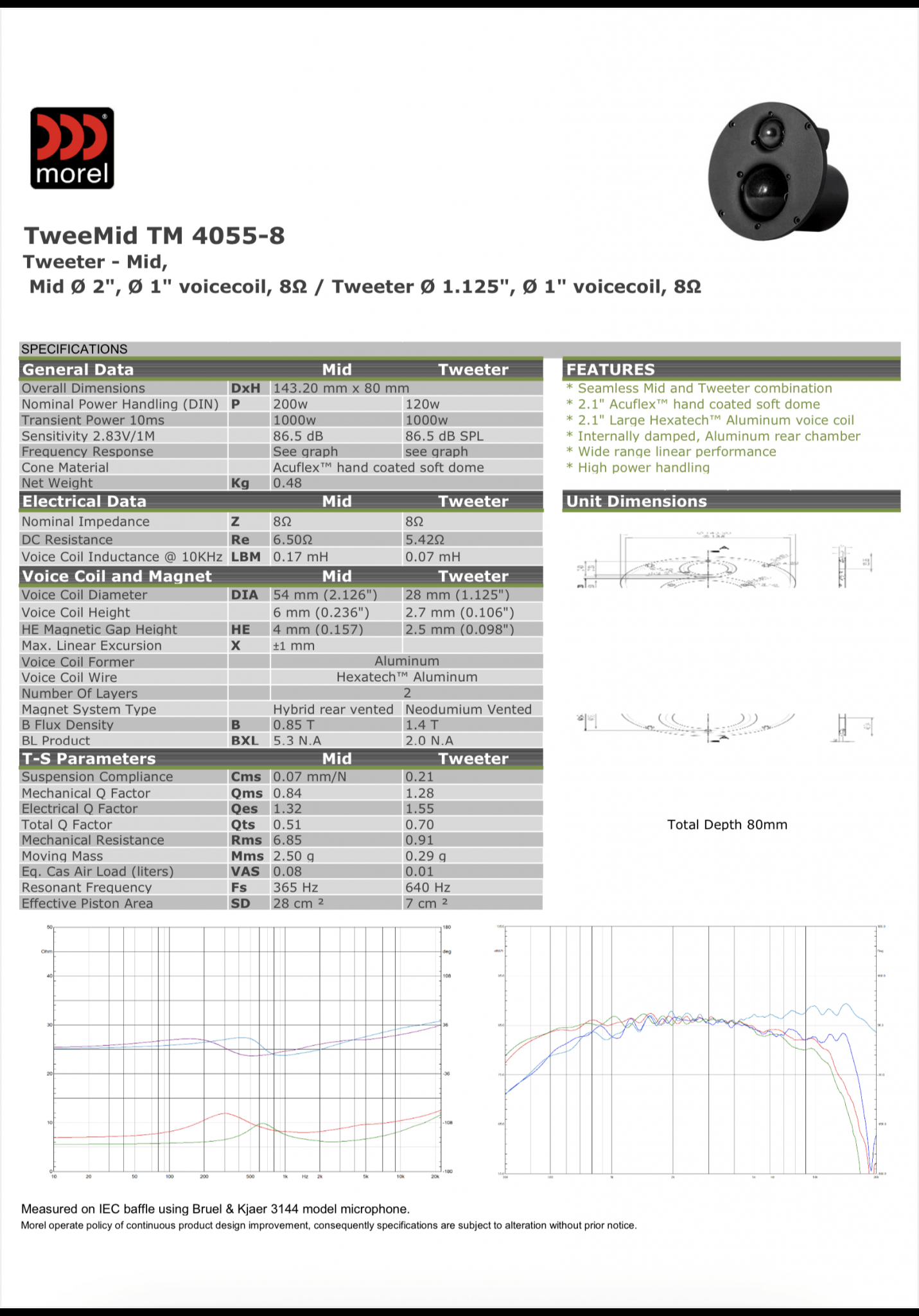

Brett, just in passing, I‘ve imagined a remake of the AR9 utilizing Morel’s TM-4055-8 dual dome tweeter/midrange array in place of the original AR9’s widely spaced domes.
Be interesting to see what you come up with using that Morel dual dome. Not my cup of tea, and for myself I was speaking of general format, rather than a specific clone. I have a bunch of drivers in mind, or on hand, and am approaching it from a 'how would I build a similar format speaker with today's technology and drivers?'.
because the speaker is not just another piece of furniture, but is the terminal of that system that reproduces music.
And gravity plays a role, as heavy pieces of furniture are put on the floor.
you know the +3dB of halving radiation space, so that's the unwanted effect to be avoided.
